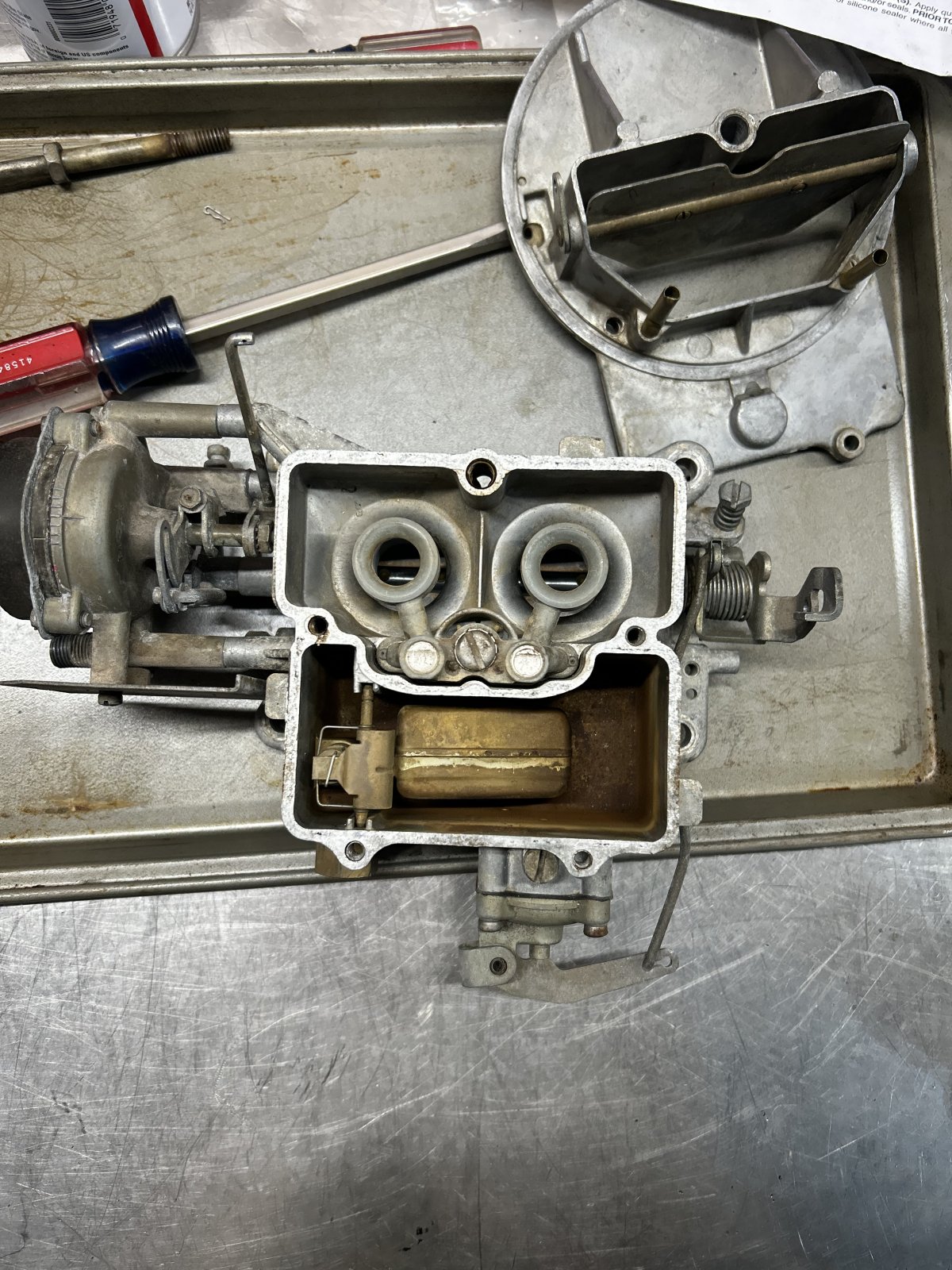

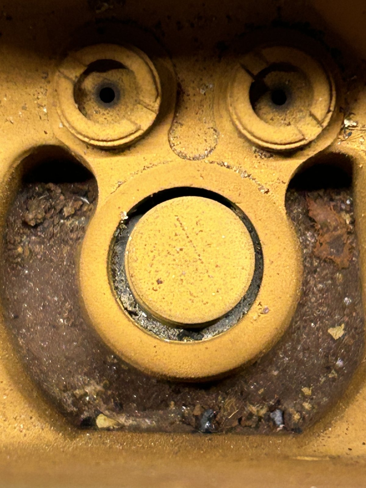

    Probably not, but when I rebuilt the carb a few months ago, it was filled with **** that either came through the filter or the vent. I was running the same type filter previously as what’s on there now.

    I doubt that the **** you had in your carb came through that fuel filter. Probably from evaporation of the great gas we now have.
    67drake likes this.

    You might want to evaluate the filter performance, both for letting stuff through, and being plugged. So pull the top off the carb again, and take out the filter and cut it open. Then you'll know if it's letting stuff through, or if it's getting plugged up (and if you need to clean out the tank more?)
    I like to put another filter between tank and pump on old cars that have lots of **** in the tank, and then change it a time or two until it stops getting plugged up.

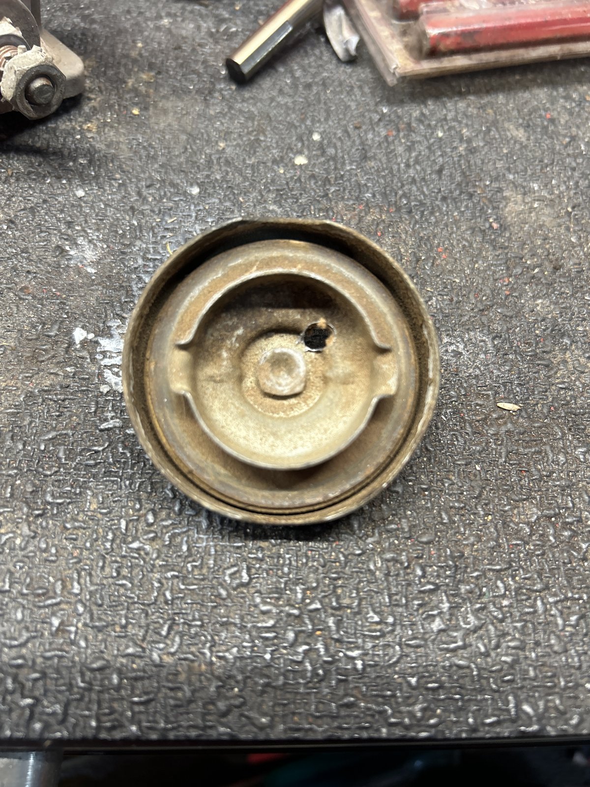

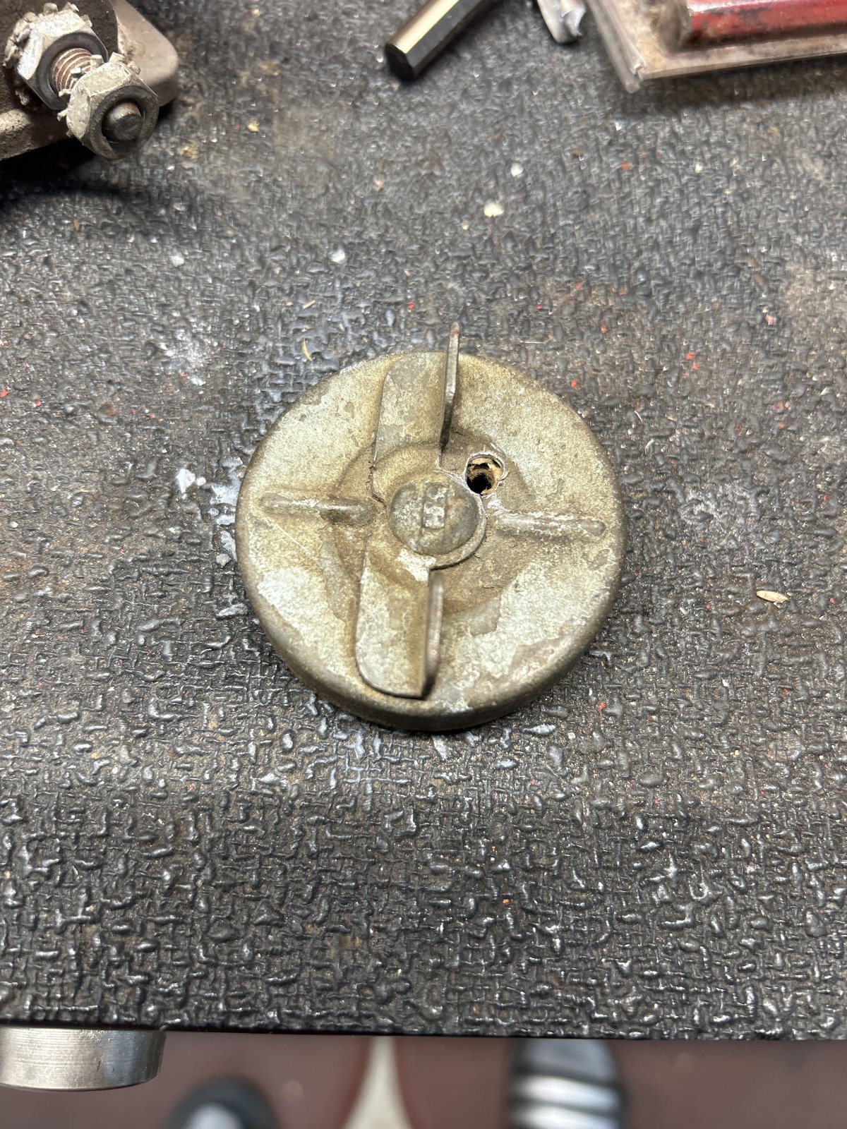

    image.jpg image.jpg This is what was on there. No idea how old it is or if it’s original. Looks very similar to the link posted
  23. squirrel
    Joined: Sep 23, 2004
    Posts: 59,921
    squirrel
    except that it doesn't have the vent thing in the middle?

    You can get the proper cap from any on line vendor of parts for your car. It sounds like you've found your problem. With an unvented cap the car will create a vacuum in the tank as the gas gets used until the pump can't overcome it. The only time a car used an unvented cap is when it has a vapor recovery system or a separate vent tube, usually on the filler neck up by the cap. In '67 almost all were vented caps. Ask when buying. I understand being rural. We have to go to as many as 3 different states to get anything here. ANYTHING!! :(
    67drake likes this.

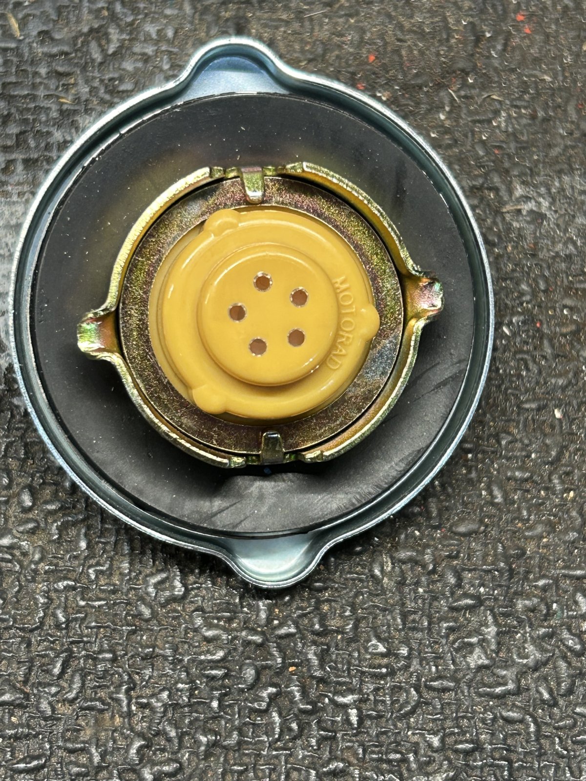

    from Muscoda WI
    IMG_1366.jpeg Got the new cap in today at the parts store. If this fixes it, I owe Mr48Chev a case of beer. :)
