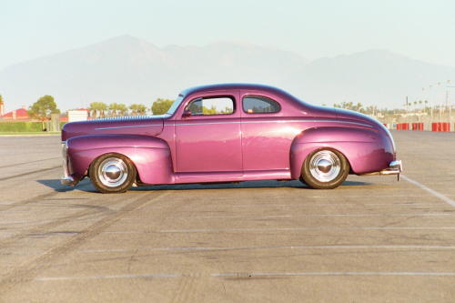

    Don't worry no offence taken. I just thought you must be someone from down there that knew me when you asked about the COE. A cpe is a coupe. I drive this 41 Ford cpe, it's low enough that a 12 oz. can set upright will not go under the front bumper

    phat rat, thank for the info and the pic of the car, i under stand now. my blazer is only 6" to the bottem of the bumper when it isall the way up.
