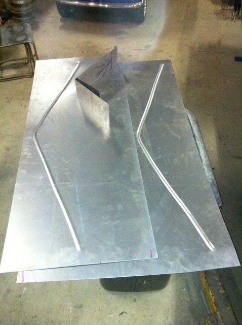

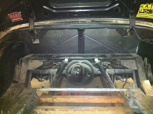

    Started on the rear firewall and got the sheets cut and bead rolled, and marked ready to fold, for the rest of the rear floor sections gonna go up the road to borrow an engineers folder tomorrow so hopefully have it all tacked in by the end of the weekend

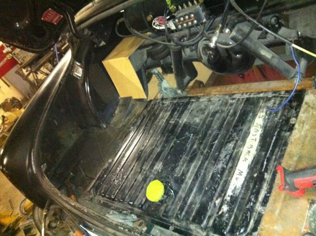

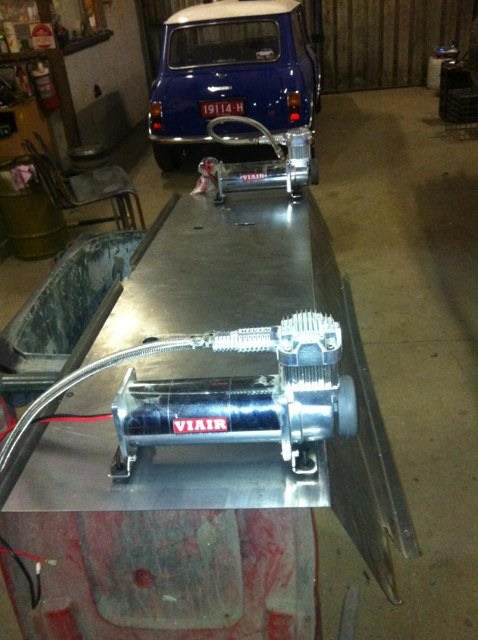

    Got the other pieces folded today and fitted in, compressor mounts made, holes drilled where they had to go and got the pieces cleaned up and primed ready to weld in tomorrow
  8. Morgan91
    Joined: Sep 12, 2010
    Posts: 560
    Morgan91
    from Australia

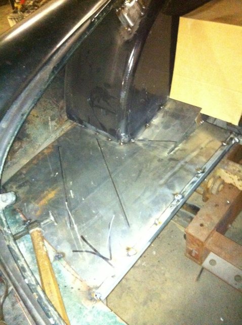

    Started welding the Floor sections in this weekend, got most of it done just need to finish off a few little bits then por15 the joins and Seam seal it then its time for sound deadening.

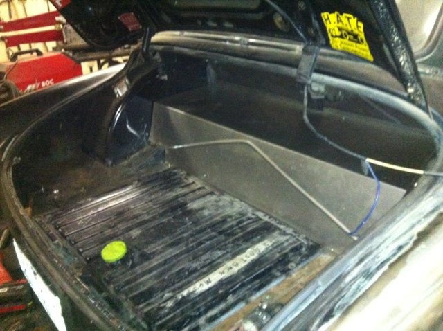

  9. Morgan91
    Posts: 560
    Morgan91
    from Australia
    So got the welding finished tonight and painted the joins and any other bare metal with POR 15.

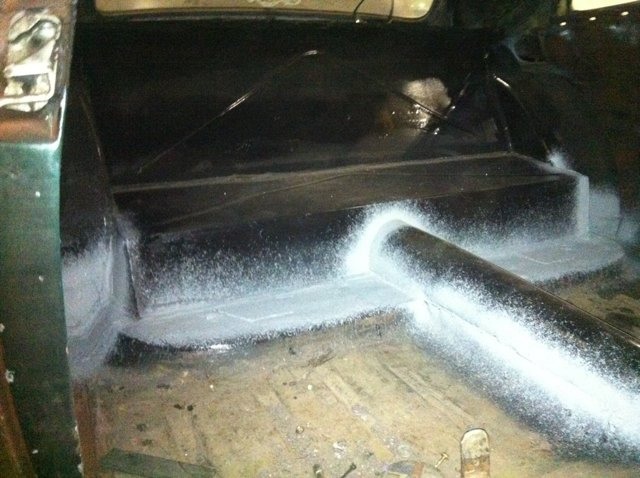

    Tonight's update, just got it all seam sealed up and did some little things on the list like brake line clamps and heat wrapped the exhaust .

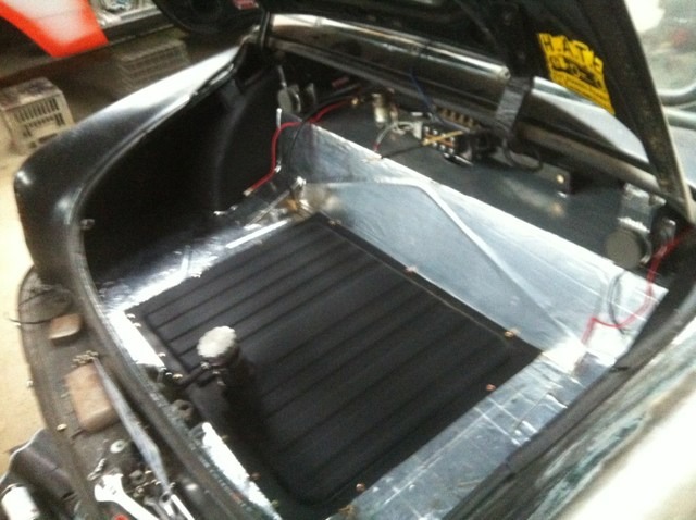

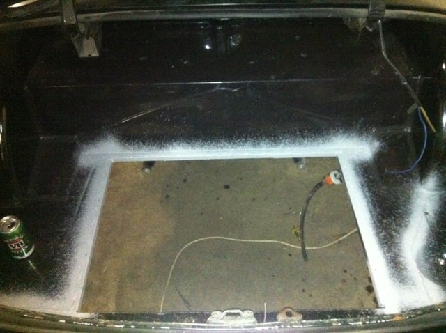

    Bit more progress, all the rear floor sections are finished and I put in The sound deadener today, painted the fuel tank and put that in, mounted the compressors, few other small bits and pieces still heaps to do before chopped tho.

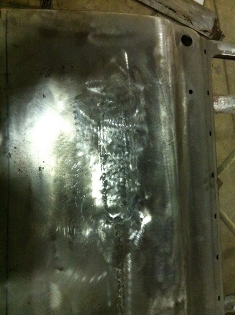

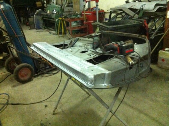

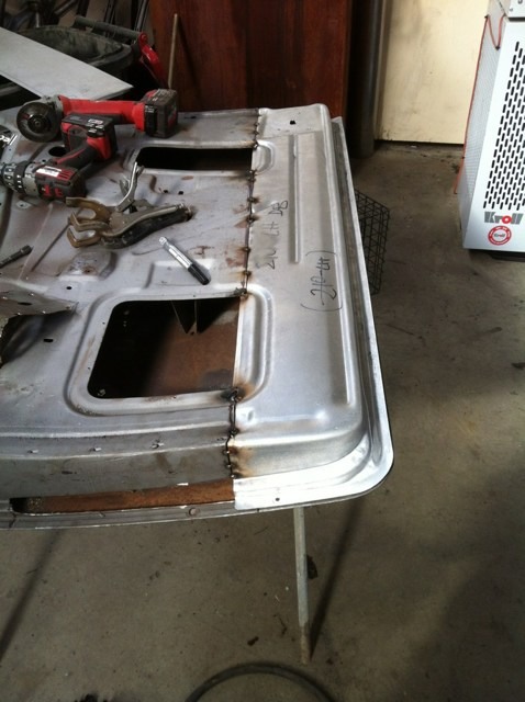

    Some proper progress today, got both inner patch panels on the doors cut in and tacked on, and started to patch some other parts of the door, might end up making a whole new skin for each door, see how I go.

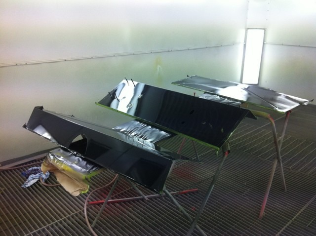

    Progress from last night, got the inner door structures trimmed to fit in the hole, they look pretty good in there, might even be able to use the stock window mechanism to make the windows go up and down. Will sand blast and prime them tonight and hopefully have them all welded in by the weekend!
