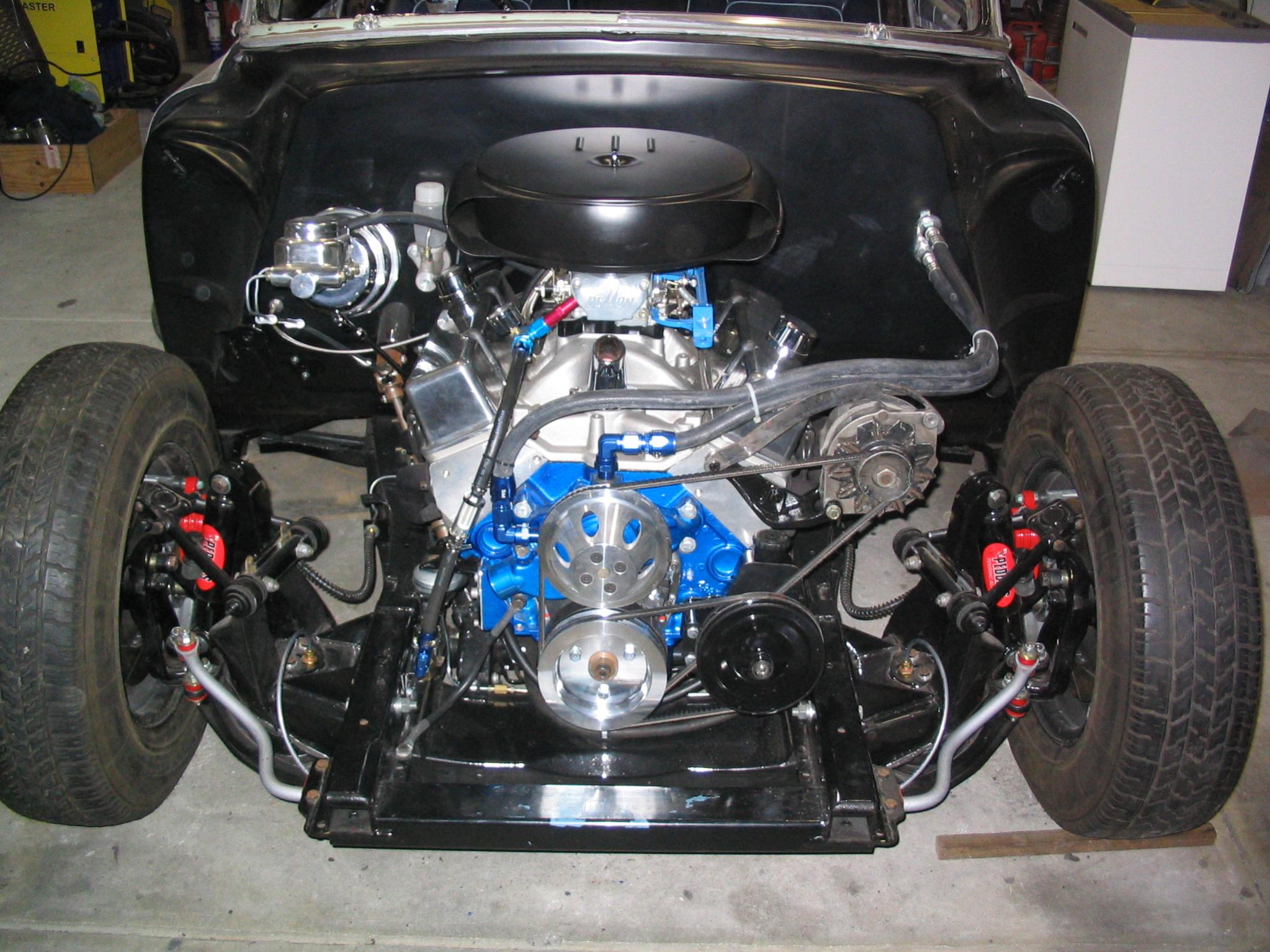

    I got the cross member cut and narrowed today. Took 80mm all up out of the guts of it
    Fits pretty much spot on now and I have a good 50mm of clearance between the guard and tyre on each side. Just have to move it back and weld it to the frame, I'm hoping that will only take me a few nights then I can start mucking around with shortening my steering rack

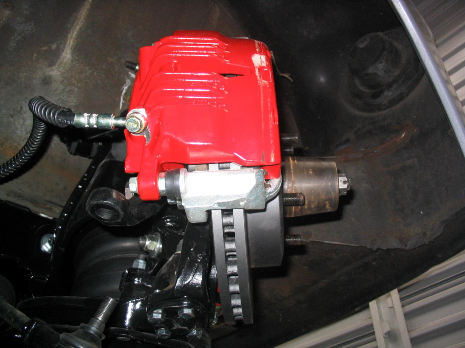

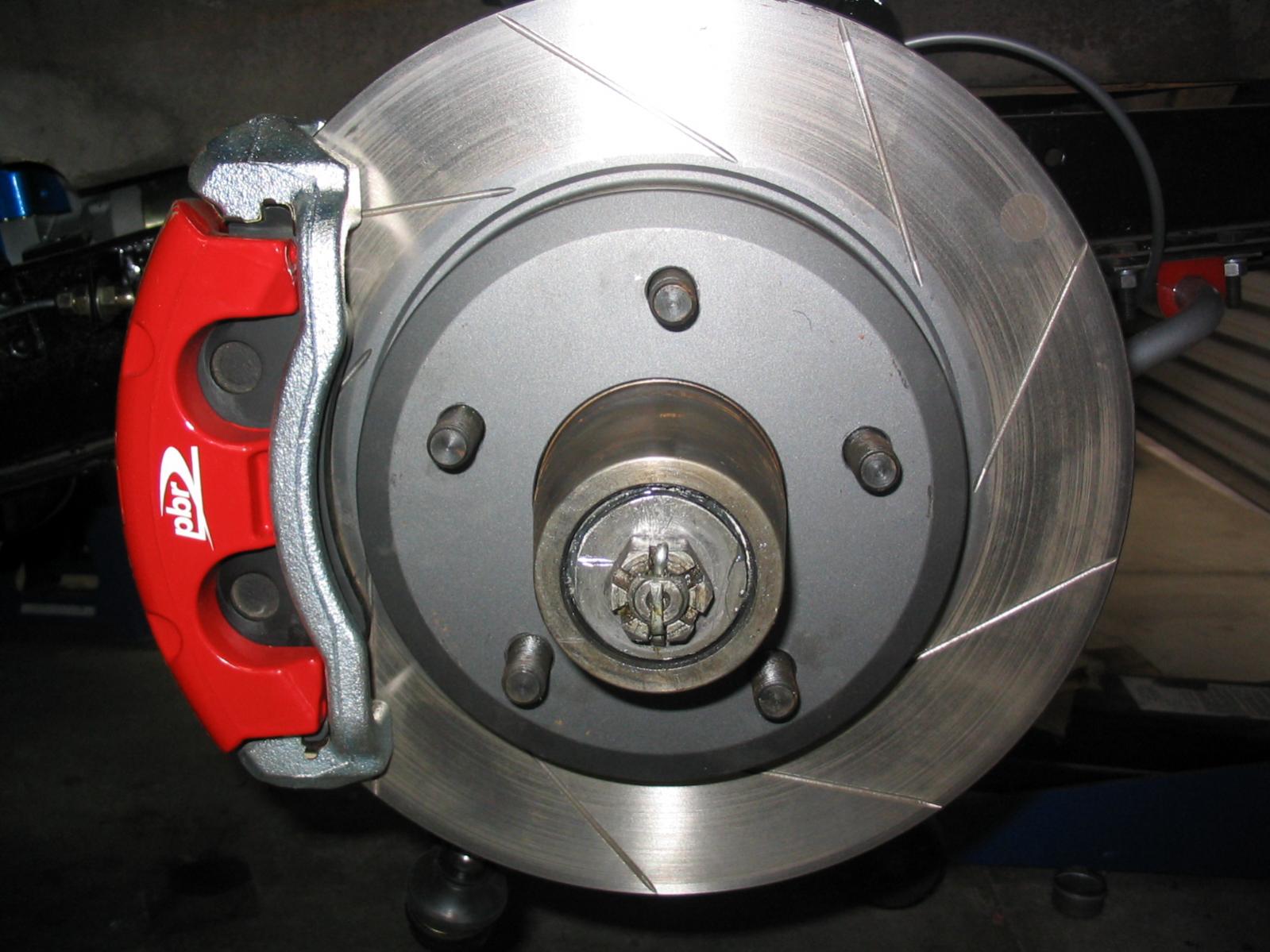

    Hi , just thought i`d let you know that i fitted a jag front end to my 53 chev and had a similar issue with the width , so i ended up getting a kit from hoppers stoppers that consisted of big commodore dics and callipers and they make a modified stubaxle to narrow the track by 22mm both sides , and then got some rims made offset as well ,
    the only thing is if you run hubcaps they need to have a large centre cone to take the stubb axle bearing housing , cheers Rob

    What is that brake booster and master cylinder off? And how have you got your brake pedal mounted?

    Got a fair bit done today in between call-outs. Plated the bottom of the Holden cross member for strength ad also to make it look a bit better. Notched the ch***is back a bit further so my wheel would be in the center of the guard. Got the cross member tacked in there, sat the guard on and I'm pretty happy with how it turned out, even bottomed out on the bump stops I get full lock without rubbing or fouling on anything.
    This is going to be around where il set my ride height.
    This will be around the height once i get dropped spindles (once I save up some coin)

    Sat the engine and trans in there today to see how it will all fit. Shouldnt be to much of a h***le to get it in there.

    Getting back into the chev after a weekend of not doing a single thing to it. All the front cross member is nearly welded in. Tomorrow night I hope to have it all welded in and start making gussets for it. Got to hot to keep on welding this arvo.

    Been pretty slack with updating this thread but that doesn't mean I havent been flat stick on the chev.
    Got the gearbox crossmember/mount made and tacked in
    Sat the motor in there
    Doing engine mounts at the moment but been pretty busy at work over Xmas and its hot as **** over here so it's been a bit slow.
