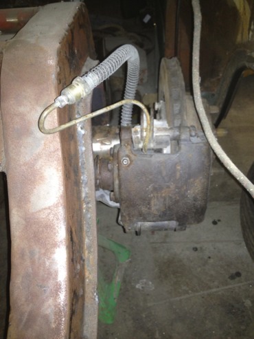

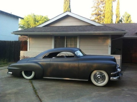

    Just realized I havent updated this thread in ages. Ah iv still been working on it flat out. Got front sheet metal trimmed to fit around the new suspension and all that. Got rear brakes sorted. Just setting up steering column at the moment. Tonight I started the final welding on the diff. Il put up a few random photos.
    (last photo is roughly how I want my roof to look when I'm done)

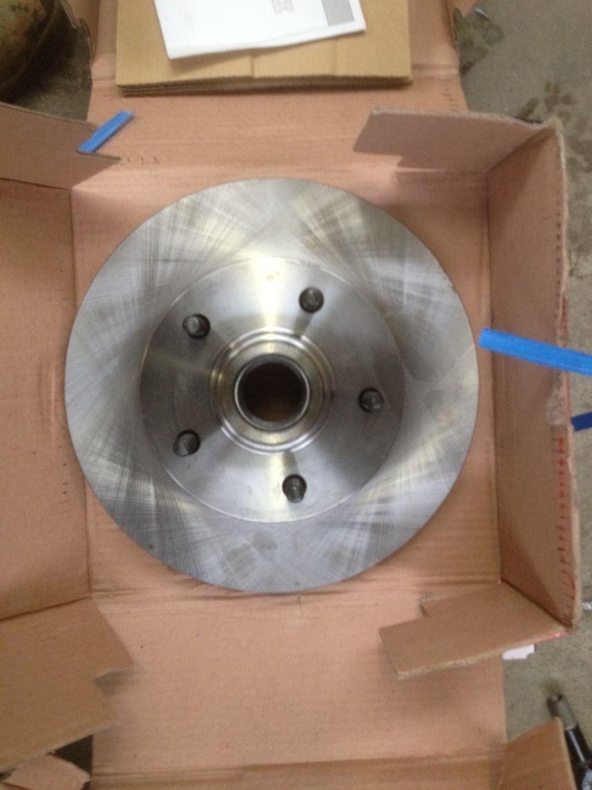

    Ah ended up ditching the XG rear end for a disk brake 9" haven't had to shorten it or anything. Just weld 4 bar and bag mounts to in ;)

    Finished welding up the diff but it seems to warped about 4mm so I'm just attempting to straighten it as I type! Stay tuned for the results

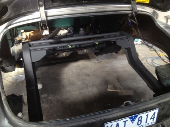

    Steering linkage all done, diff straight and painted and assembled. Rear notch and chassis painted and rear end all put together.

    Oh and I got the mustang tank mounted in there thismorning before I got called to some jobs.

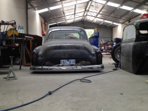

    Couple more progress pictures mostly front end bits and pieces
    Just gotta get some bolts tomorrow and it should be on its own four wheels holding its self up!

    Front end is all together, sent the steering rack away to get rebuilt this morning. And just sat the front sheet metal on last night to have a look and I'm pretty happy with how it turned out.

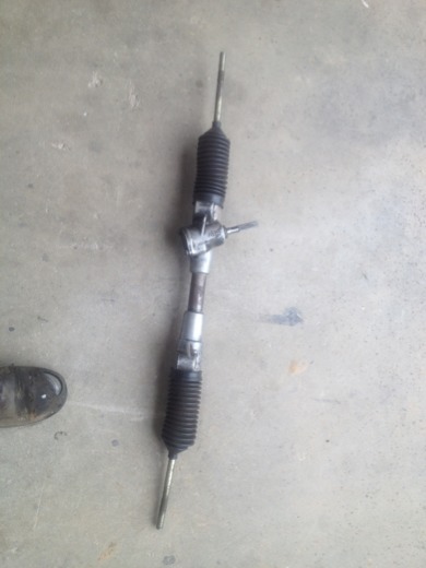

    Got steering rack back that's all in and working.

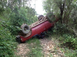

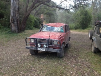

    But one big setback is I rolled my daily driver (off topic) but Now some of the little money I have is going towards getting that back on the road so the chev is going to be sidelined for a few weeks an this probably means I won't have enough money to meet the deadline of my birthday in february to be able to drive it but shit happens! Haha chopped 2013 is my new deadline, not sure what stage it's going to be at but it's getting to chopped come hell or high water!!!

  29. itsmee
    Joined: Feb 17, 2012
    Posts: 99
    itsmee
    That should just buff out.............shouldn't it?
