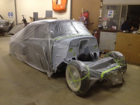

    Got the fire wall painted tonight.

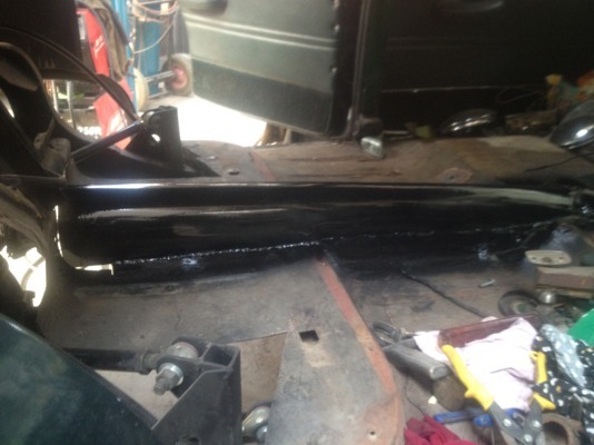

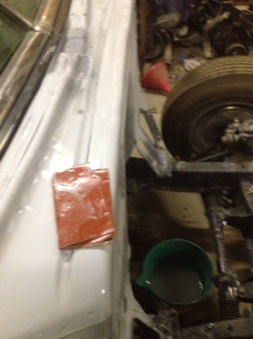

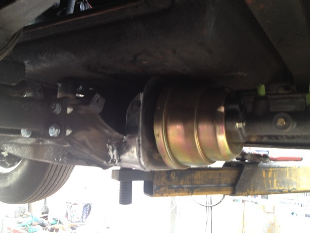

    Been slack with up dating this tread but have had heaps of progress in the last few weeks. Got the dual booster and dual master cylinder mounted under the floor using the stock pedal, got the clutch mater mounted under floor using stock pedal as well.
    Nearly done brake and fuel lines and all the plumbing, made a new exhaust and got a new tail shaft made, and cut out the old tunnel and got a new one made and tacked in, and a whole heap of other little things, I'm about a week or two off actually driving it for the first time in over a year So I'm pretty exited about that.
    Also got My coupe doors that I imported from the states, they need a bit of work but I sandblasted them and cleaned them up, gonna order patch panels from ems when I save up, but just going to get it driving as a four door before I cut it all up again.
    Few pictures

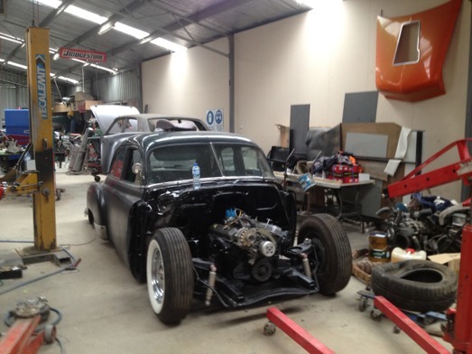

    Tunnel is finished got the engine running last. Night and all the brake lines made and bled, couple more little things today and hopefully il take it for a drive!

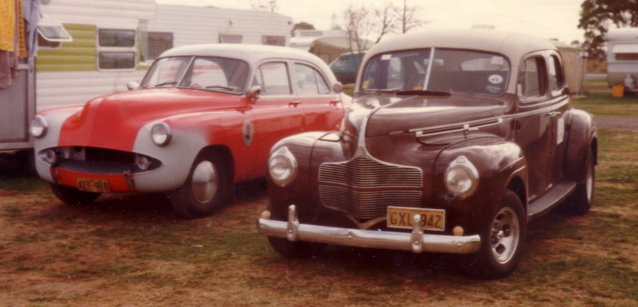

  22. Nice to see another 51 Chev getting customised.........have attached the only 2 pics I can find of my brothers customised 51 Chev Sedan, the 1st pic was at the 1979 Vic State Rod Run we attended from Sydney, he in the Chev, me in my 1940 Dodge Sedan. I ended up buying the Chev from him in the mid 1980's and it was used as the daily driver by my wife till the early 1990s.
    We brought it with us when we moved to Grafton in 1992 and it was sold unregistered to a guy in Brisbane about 10 yrs ago.
    Its since been flat blacked, made into a 2 dr and the custom front sheetmetal replaced with stock sheetmetal and a Chev V8 installed.......but the two distinctive 59 Caddy tailights that can be seen in the other pic I have attached are still on the car to this day............they were the ONLY parts remaining from the early 70's hotrod 1932 Ford Tudor that Dennis Millet built in Sydney.......my brother bought them from the guy that bought Dennis's car and wrecked it.
    The chev as built by my brother, Bruce had a 186 Holden 6 and 5 speed Alfa gearbox, 51 Chevfront suspension, completely hand formed front grille sheet metal including extended & peaked hood, frenched aerials, front & rear rolled pans, 59 Caddy tailights, custom dash, 59 Olds steering wheel, 4 P76 bucket seats, ch***is & suspension painted in red & silver 2 pack with chromed suspension & steering, dechromed body, genuine moon caps, appleton spots.....etc.........all this in 1978....nice to see another chev custom........btw I've still got the 1940 Dodge sedan......regards, andyd
