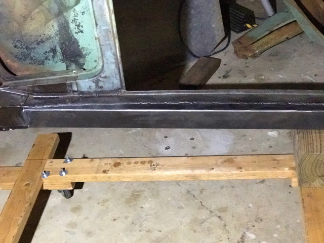

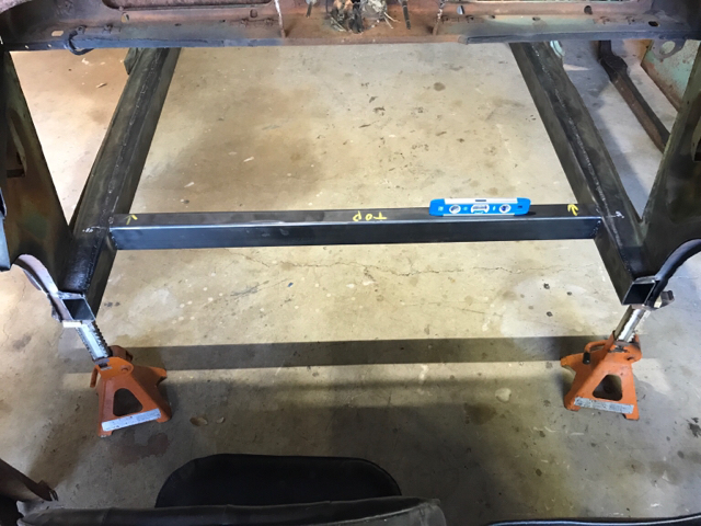

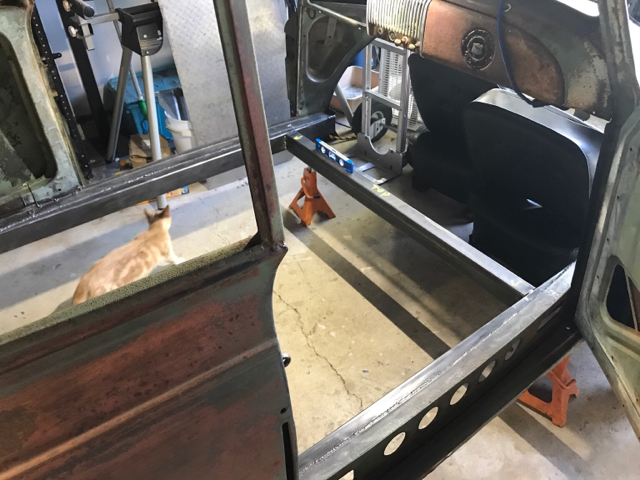

    Had some time today to work on repairing the rotted out rockers.. also started cutting out rusted through portions to patch..
    This is after cutting rotted portion of rocker out.. I used 3x2 1/8" wall square tubing to Fab new rockers, I need to go back to Metal Supply Shop and get some 3/16" plate to box in bottom half of rocker
    Here you can see where I still need to box in bottom half of the rocker

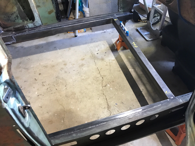

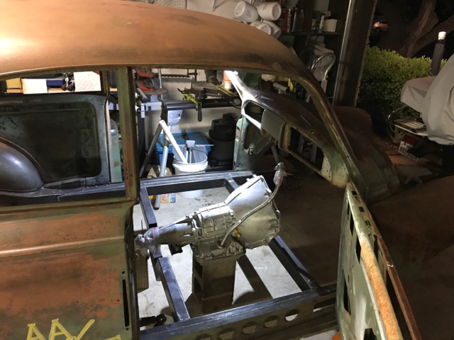

    Installed front frame rail attachment. I need to decide how wide front frame rails will be and remove that section for the front cross member, 'this is the body / frame attachment points.. I'm not doing a kick up or Z'd frame, just straight frame kinda like a Model A but wider and stronger.. I was thinking 29"-31" wide inside frame rails.. I'm hoping SouthCross will chime in on how wide his frame is.. I'm building this as a unibody, frame is part of the body.. thanks any thought will be appreciated.

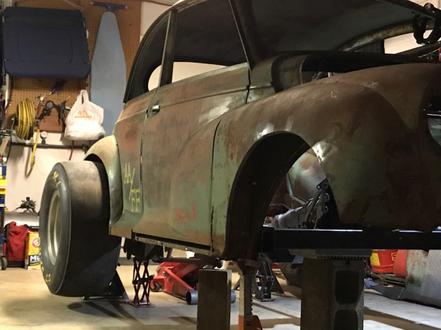

    Been hammering on fenders and hood, getting them straightened out think I can save them.. should have rear end and ladder bar member in tomorrow.. pictures to follow..

    Mine 28 1/2 from front to back measured from the inside of the rails. You boxed the rockers just like I do on my Morris Minor builds.
    I always use a kick up in front and back . These cars are squirrley enough without raising them up.
    My rocker height is 11in. in front and 10 in. out back to comply with the Southeast G***er rules. If I could it would be about 6 and 7. Good job so far.
    Remember an Anglia roll cage kit fits really well if you don't want to bend one up yourself.

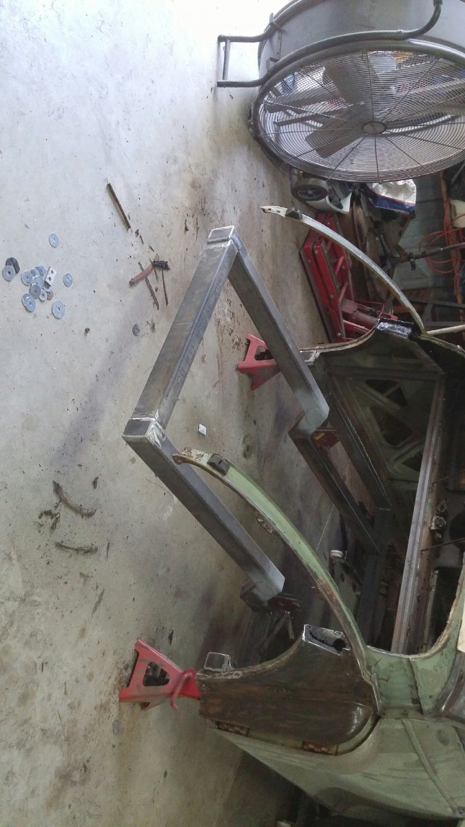

    You may regret it if the center of the ****** cross member is not removable. Unless the floors will come out and you can take the trans out through the door. I always try and build my cars knowing that they are going to have to come back apart at some time. Would hate to have to pull the motor to get the trans out.
    I drive em hard and break em and put them back together. My last Morris every bolt could be taken out and put back without even using a swivel.

    Yes I'm making removable floors where I can pull ****** from the top.. it's not going to have interior just sheet metal panels that can easily be taken off to work on any part of the vehicle..

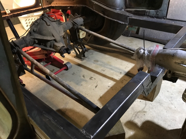

    Also the ladder bars mount to that same cross member.. they are 36" ladder bars

    My old school ladder bars will be 47 inches long . The mount will be part of my trans cross member ,but the center will be removable . It will be diagonally braced so I can remove the center and not loose strength. Bolting the transmission cross member will make it solid.

    I found out why my pinion angle was -10* at mock up... haha [emoji23]... well the guy before me had the ladder bars on upside down.. [emoji51]
  20. RigorMorris
    Joined: Apr 2, 2017
    Posts: 207
    RigorMorris
    I think you can see how far down the pinion angle is pointing & ladder bars are pretty much parallel to ground, so flipped the ladder bars and we are at where we are supposed to be now.

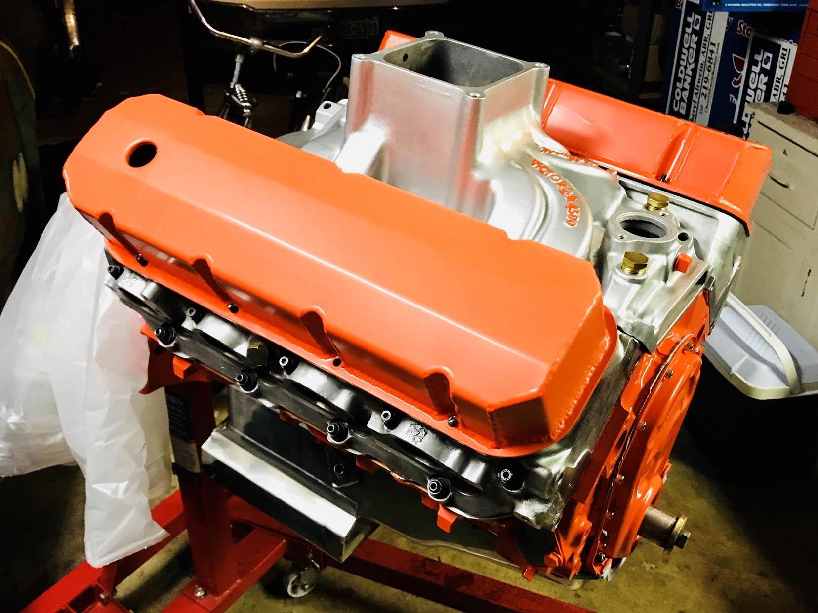

    I have a Small Block Chevy 355cid that I’ve been building also, may go with the SBC instead of the BBC

    SBC is all Eagle Rotating ***y, Forged Ultra Light Crank & Rods.. Sealed Power Speed Pro hypereutectic pistons..
