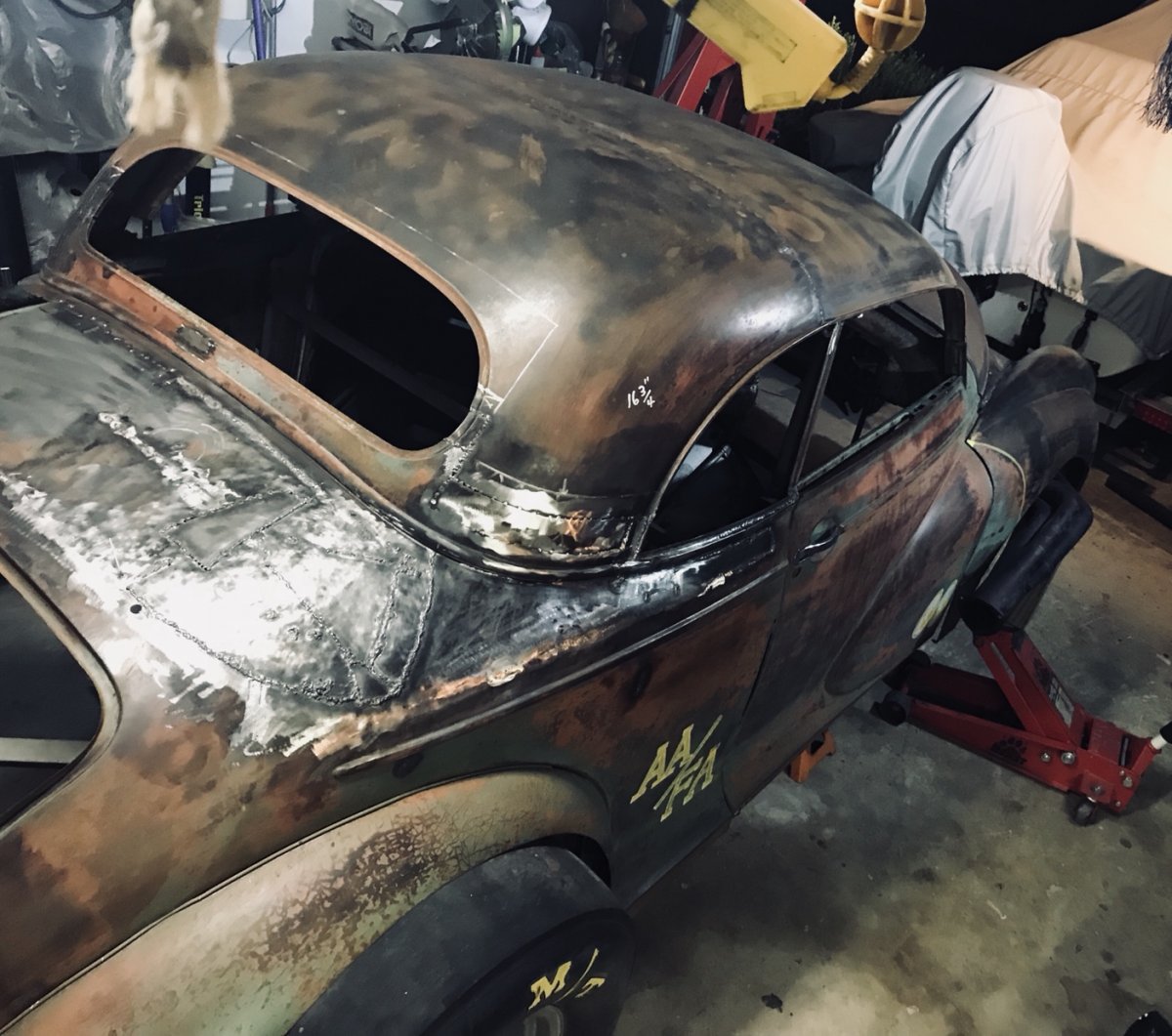

    Hanging in the garage, mocking up tires and headers to get an idea of the direction I want to go.. This will be an Altered so front wheel is going way forward. Tire will hand just past the nose Probably 3-4”.. front end will tilt with Clevis pins in hinge so I can completely remove front end if need be.. headers are not the headers I’m using neither is rear wheel.. just trying to get an idea of what it’ll look like. Need to re-order frame and look for suicide door hinge kit.

    [​IMG][​IMG][​IMG][​IMG][​IMG][​IMG][​IMG][​IMG]
    Getting a little closer started the frame work this morning.

    Body / chop top is just tacked together but Also getting closer.

    [​IMG][​IMG]
    I have not buffed any of the welds, still need to take a wire wheel to the welds, I’m using a g***less welder with .035 shielded flux core wire. Any questions ask away
