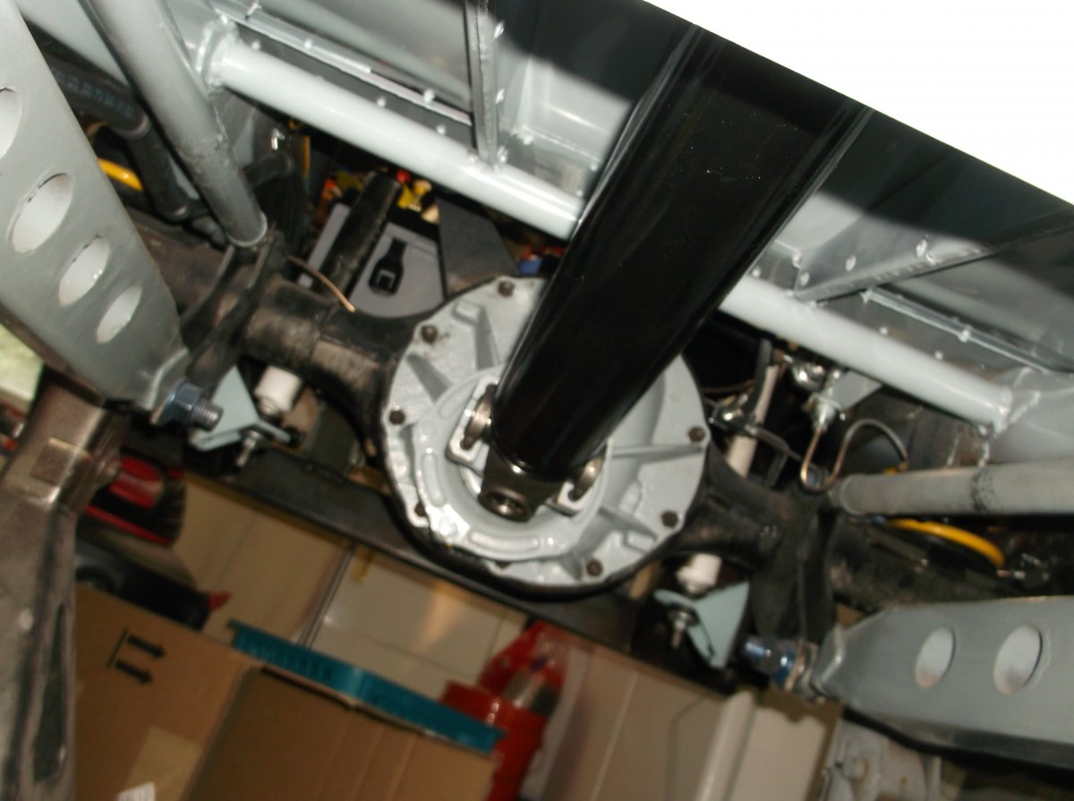

    Looking good. You may want install your engine and trans and make sure the dip in your ladder bar crossmember doesn't intersect with your driveshaft travel. I also noticed your ladder bar adjustments are all the way bottomed out. You should have some room both ways to adjust. Right now you can only adjust to make everything longer.
    I had the same issue with my Morris G***er project. Had to cut the center out and remake my driveshaft loop . You can also set your pinion angle at the same time. Very important to get right in short wheelbase cars as your drive shaft will quite short. Mine is going to a little over 18 inches. Not much room before you get into binding issues.
    Have fun finishing your Morris. I am in the home stretch on mine.

    20170411_1250461.jpg Do you have a bead roller You can flair the rear fender's with it and then hammer out the flare. That's how I did mine. Looking good so far.
    My driveshaft ended up being 26 1/2 inches . I had to roll the rear up to get correct pinion angle DSCF3512.JPG View attachment 4317247

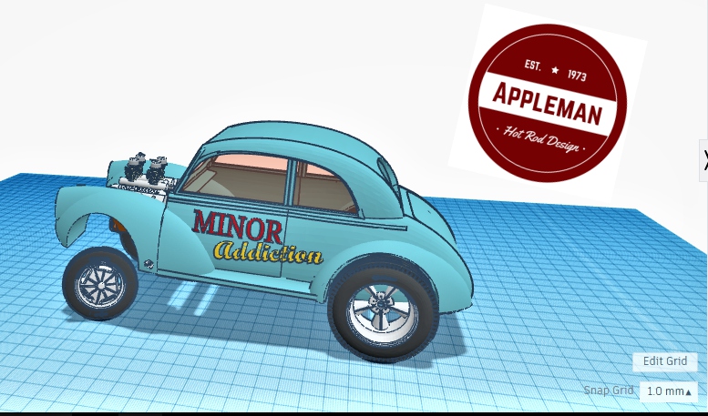

    Been following along Rigor..Just MY thoughts here..........is there any way you could keep the front wheels in (or near) the wheel well openings? I sorta question the altered look with the front wheels sticking way out in front of the car. The old Comp coupe cl*** with the coupe body sitting on a dragster frame was too-cool but yours............I think would be better with the wheels in the stock location (or "near" stock location). Would the engine be in your lap?? Is that the reason.
    Jus wonder'in
    6sally6
    LM14, RigorMorris and loudbang like this.
  29. RigorMorris
    Joined: Apr 2, 2017
    Posts: 207
    RigorMorris
    @ 6sally6 :
    Yes I've changed my mind on the altered look I'm going try and keep front wheels as close to stock location as possible. I believe there will be plenty of room for engine without it being in my lap.. and from what I've read from Quain Stott is, in these short wheel base cars you want the engine as far forward as possible to keep it from being a wheelie machine.. lol. So yes I believe you are right on looking more correct with front wheels as close to stock location as possible.. what I am worried about is header clearance. Really appreciate the motivation.
