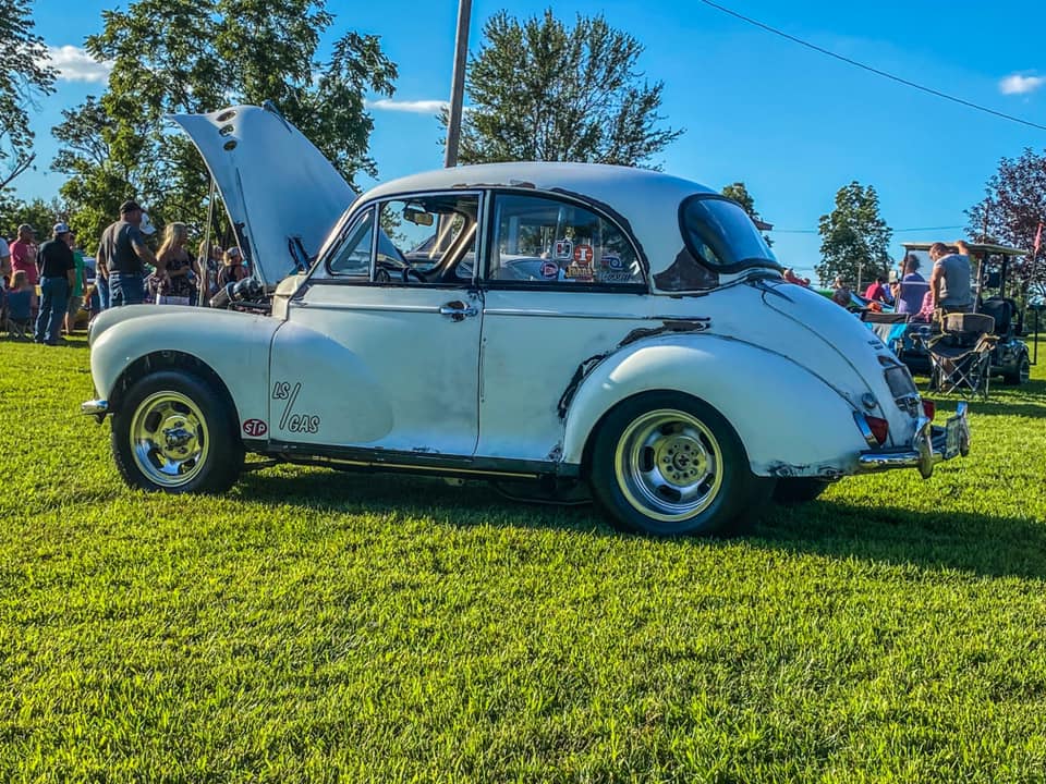

    Joined: Apr 2, 2017
    Posts: 207

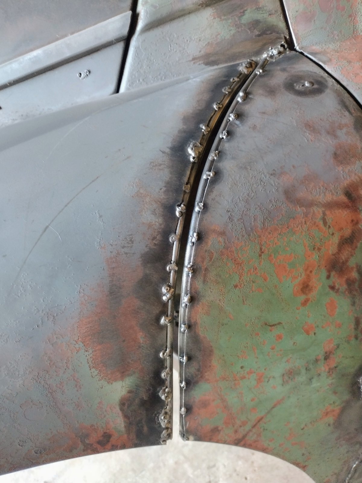

    I'd try to get away with body filler instead of grinding the weld out/down. Less chance of a crack ruining your paint later.......+ EZ'er!

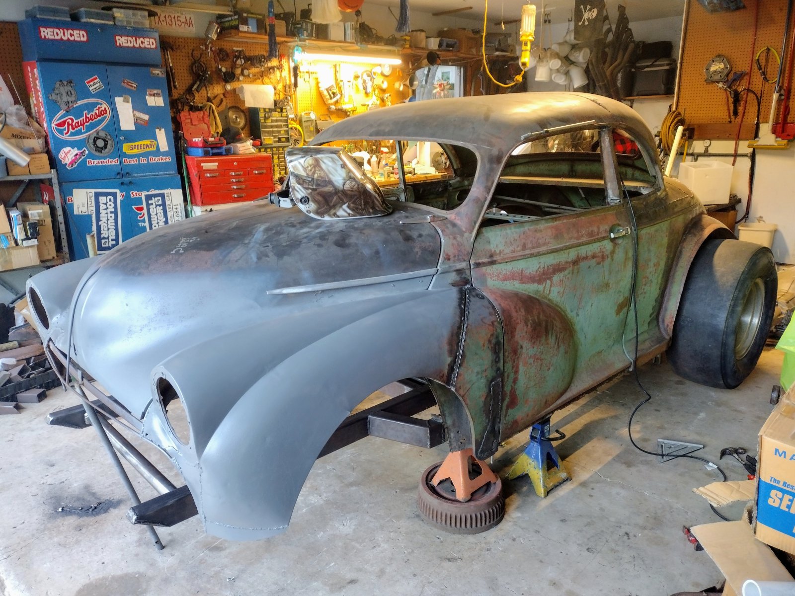

    I'm still working on the front sheet metal. It was wrecked in p***enger front not bad but lots of body hammer work and rust repair. This thing was laying in a yard of tall gr*** and covered in vines for 30years so it has been a challenge. I do not like the grille or nose section so I welded the fenders to the hood when one piecing the front end in away to make them a little fatter so they are tweaked up and out and a little forward. Kinda hard to explain. But makes for a lot more work, but worth it. Gives it a more flatter front and open grille area.. little bit like an Anglia 100e.. but any how I need to make a bunch of poster board patterns and piece it back together, I've been avoiding it. I'll take some more pictures looking straight on and y'all will see what I mean. I also wanted front frame rails to stick past nose about 4".. I just didn't want it flat cut wanted a slight taper. I have the Griffin 4 row aluminum radiator that fits between the frame rails. Oh and if you have never welded on Morris Minor sheet metal it's really thin, like arc welding tuna cans together. So I promise I can weld. I haven't really ground any welds. To give you an idea each fender weighs 9lbs and the hood weighs 18lbs plus my 3/8" round stock bracing. I can lift the cab up by myself. So it's very light, like too light, like gonna have to add weight light lol. Still can't decide if I want the front to flip open, nose down or nose up. I may fab some sturdier hinges in stock location and have entire front flip up. Rear section of front fender is welded to cowl and you can see in the picture the cut line between rear section of fender and one piece front end. Sorry for the long post. More pictures coming. 123_1~3.jpeg

    Yeah they look worse in the picture but are very stout welds no fender flex, it's just structurally stronger. So not too much grinding there. But definitely understand what you're saying.

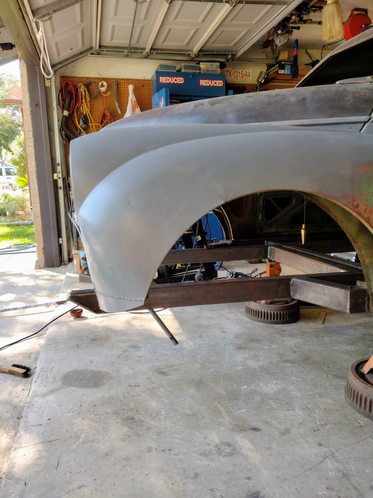

    Pictures of front frame cross member and frame rails.

    Front frame rails extend slightly past nose.

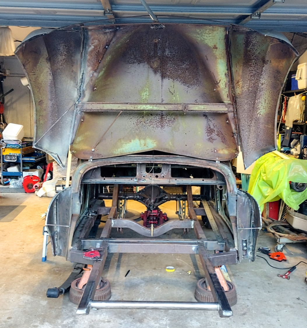

    This will show you what I'm going for when I say flip up front end. I still need to fabricate external hood hinges and add more bracing. I'm still utilizing the stock hinges and even though it's light for a one-piece front end, I don't think they are strong enough.

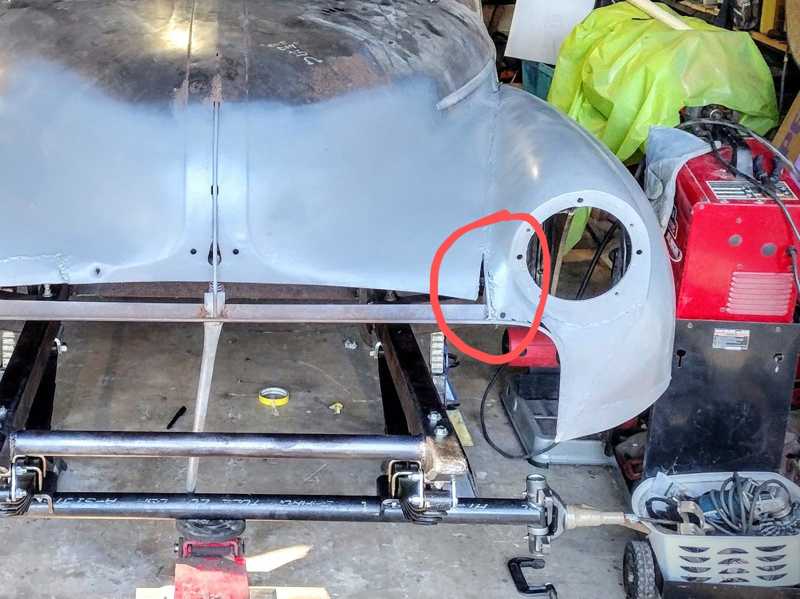

    Also I don't know if I mentioned it. But the front fenders are welded to the hood with 3/8" solid round stock in between. But I wanted the fenders in the front to appear to be fatter so I tweeked them out a little and moved them forward a little. Gonna start making the poster board templates for front sheet metal. I've been putting it off because it will be a PINTA to piece it back together.
    Here you can see how much the fender is pulled up.
    It is by no means finish welded on the front sheet metal. Welds are not ground down anywhere. The metal is very thin.. like 25+ gauge sheet metal but I wanted the body to be all metal. I just wanted to get it in the general shape I liked for mock up.
