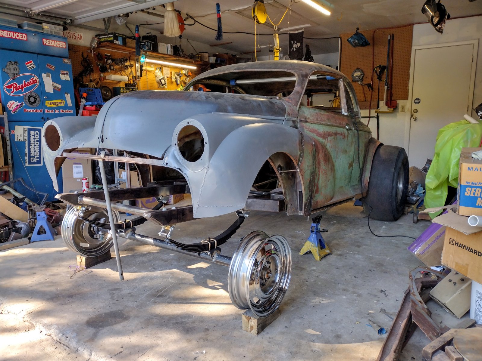

    So this is a guesstimate.. because my wheels have not come in yet.. but I have spindle centered off the ground around ride height with a imaginary 28" tire. And there is no engine weight in the ch***is yet. The very most front part of rocker is 18" off the ground and rear part of the rocker is 13.5" off the ground at ride height. I would like the front to come down about 3".. so with BBC engine weight and maybe removing a leaf I'm hoping to accomplish that.. The diy engine mount kit should be here the 21st and I'm going to get engine tacked in the frame with 1/4" metal bar bolted to front engine plate mounting holes probably tomorrow. It will have a rear engine plate between trans bell housing and engine.

    The way I have it now.. and nothing is permanent, just tacked so I can roll it. They would not be able to reverse themselves.

    If the springs are that stiff, you may not get to much movement out of that. Your in the ball park, it probably just needs to go forward on the frame side a bit more. But again, hard to tell without some weight in it.
    I also think I would reach out to some of the Southeast G***er guys on here. They obviously have played with setting up their cars, I am sure at least a couple would lend some suggestions to you for proper front axle/ suspension set up. Might want to hit them up maybe before you get to far into this. I'm sorry my experience lays basically in rear suspension.
    BTW, Killer build. I love it!

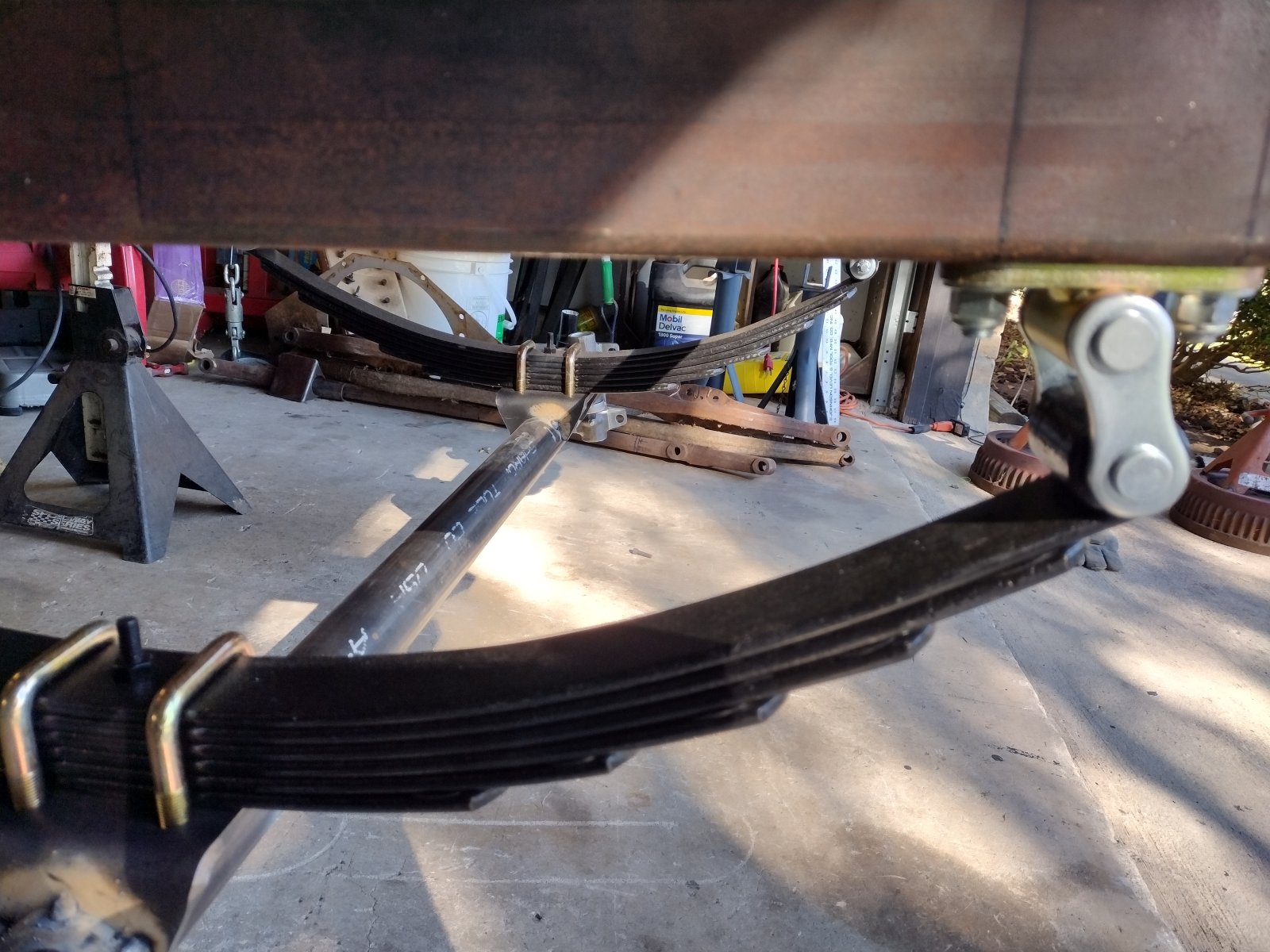

    If I remove a front leaf spring to bring car down a little, which leaf do I try and remove? It's a six pack spring.

    IMG_20211119_142549837_HDR.jpg With my dad and I sitting on front of the frame, we can Not bounce it.. It's really stiff so what spring or springs out of the pack should I try removing? Or should I wait till engine is in it? It's a BBC with aluminum heads and intake. These are pictures of it sitting in its own weight.

    BBC with aluminum heads and intake isn't much heavier than a SBC. I'd leave the springs alone until it's on the ground with engine/trans at least. Then bounce it and see how it compresses. Likely need 2 leafs removed. Im down to only two leaf springs on my Speedway spring packs in the front of my Austin, and it's still plenty firm enough!

    So if I do need to remove leafs, which ones do I remove?

    The most effective leafs to remove are the longest. But I prefer to keep the first longest after the main leaf, so the springs aren't trying to bend the main leaf hanging out as a single unsupported. The shortest do the least, and removing them wont have as much effect on the stiffness.
    Because of how cramped my engine bay is, #1 cylinder sits right over the axle centerline. I wanted it back as far as I could reasonably go, but I'm looking out the rear side windows when I drive now, and going further back wasn't good for my driving position.
    I've never used the dogleg shackles you pictured, but I would toss those wimpy little Speedway shackles. I had the same that came with the tube axle I put in my Austin, and they just looked to wimpy. And the even smaller 3/8" threaded ends didn't make me feel very confident either. So I made up new shackles from 3/8" x 1.25" flat bar, and used full sized bolts in them. I see a lot of those little shackles in use, so they're probably OK, but I didn't like them myself.
    I have my kingpin angle at 10 degrees, so my car wants to go straight if it ever got out of shape at the drags. With only a 89" wheelbase, I figured it will correct itself if I let go of the wheels. It tracks very straight at any speed, but I do feel resistance when backing up, and cranking the wheels hard against the stops. So I just don't do so.

    I took 1 leaf out, the smallest one and seemed to make a lot of difference in stiffness and brought it down some. I tried taking 2 out and it was too much. They are 490lb spring rate, each spring. And as far as I can tell they are not binding, shackles move freely. I think the BBC will bring it down 1".

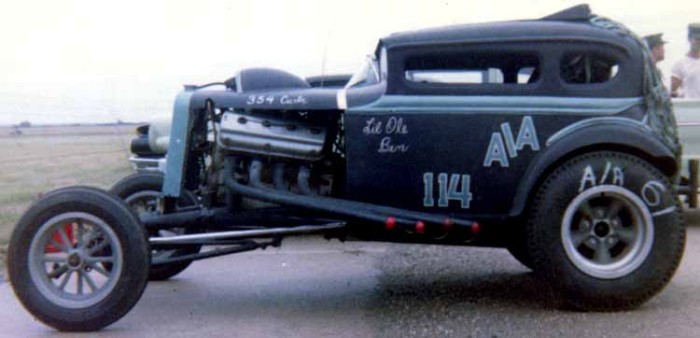

    When you say realistic height, what would that be? I like the high boy look but not extreme. I think I can achieve the right stance without looking street freak, without axle on top of the springs.
    I'm building an A/A or B/A cl*** Hotrod. Although I know a lot of the Altered's were low, a lot were high boys. It will be one of the late 50's early 60's looking Altered's.
    Morris, Crosley, English Ford's like e100 and Austin's were thrown into the A/A B/A or C/A cl***es back then because of wheel base.. Anglia although a short wheel base, was given a hall p*** by NHRA into G***er cl***es from what I read and understand but also had a 2" increase in wheel base to 91". The Morris is around 92.5" wheel base. From what I read even moving the steering box threw you in Altered cl***.
    The Morris will probably only run on fuel due to high compression and will eventually be mechanically injected and or supercharged when I can afford it. Right now it will be carburetorated with a 1050cfm dominator which I know is not period correct but all I have right now. It could easily be period correct with a dual quad tunnel ram. I use to own an Edelbrock TR1 dual quad shoebox intake, it even had the patent pending on it, but I sold it.
    I'm also running a 2spd Powerglide which I have read would designate it as an A/AA. Manual transmission Altered was designated A/AM from what I read. Also in an altered you sit in front of rear axle, compe***ion coupe typically you sit behind rear axle. But even back then cl***ification was confusing.
