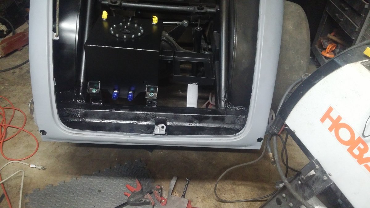

    Fuel cell installed. Now for the battery tray. Then plumb it and install the floor.
    Then remove every thing for paint. 5 gallon cell. Wanted a Moon tank up front , but no room unless it was in front of the grill and then it would interfere with the tilt front end. Did not like the no grill look on this car. Just have to put my battery charging lugs under the tail pan out of site so I won't have to open the trunk except to pour in some gas. Having 5 gallons allows me to go to the local cruise- in without running out of gas. Checked on registering this car for the street and the lady at the DMV was very helpful.
