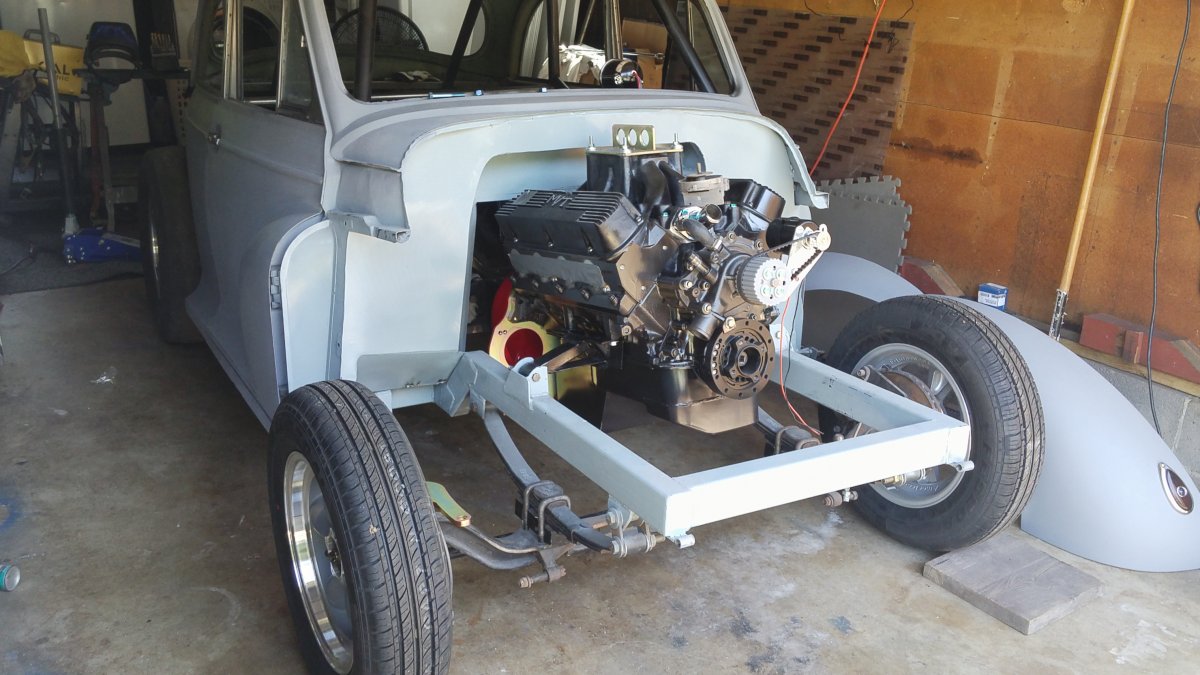

    southcross2631
    Well got motivated today and drug my motor off the stand and put the ****tershield and transmission on. My wife and I installed it in the car. After looking at it I am going to redo the motor mounts.
    The motor sets too high in the front. The center of the crank is 26 inches off the ground. I need to lower it to about 20 inches . It will give me more foot box room and a lower trans tunnel.
    I will probably have to change the transmission crossmember also. One change leads to another. 20180503_150554.jpg 20180503_152454.jpg

    southcross2631
    Got my motor mounts modified to lower the motor 6 inches in the front. Now to do the frame mounts . I have the patterns made. Just need to transfer them to steel. Then drop the trans to get the drive line angle correct.
    It should handle better with the motor lower The center of the crank is now 20 inches off the ground ,well within the Southeast G***er rules of 16.5 inches minimum.
    It also gives me more room inside for my pedals and a lower transmission tunnel. Before and after 20180503_152454.jpg 20180504_130037.jpg lowering the motor.

    southcross2631
    Thanks for directing him to my other build. Got my frame mounts built today and got the motor bolted in. will start on the transmission cross member next. 20180505_153518.jpg

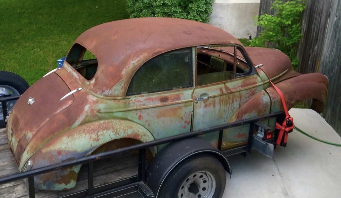

    RigorMorris
    Your Morris was in such great shape when u picked up, mine was is a rust bucket, which I’m repairing but man it would have been so much better being able to focus on other issues. Very time consuming.. mine sat in a field with no suspension for god knows how long.. before I found it for the whopping price of $300 ... lol still think I over paid but it was love at first sight and had to have it. I saw what it’s becoming not what it was.

    southcross2631
    I only use the outside skin of a Morris when I build them . I pay a little more up front for a better car and in the long run it pays me back by not having to do a bunch of rust or wreck damage repair.
    I ended up selling over 300 dollars worth of parts off this car to bring the cost down.

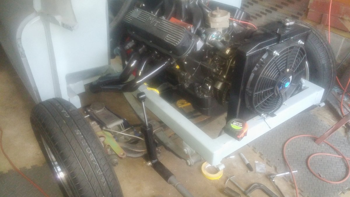

    southcross2631
    Things at starting to go fairly quickly now and the car is coming together. I should have the steering box on and connected by the end of the weekend so I can start building the headers.

    southcross2631
    Wrapped up my radiator/ cooling fan mount. It is cool when you can use one bracket for more than one thing. Now I can remove my radiator and electric cooling fan by removing one nut and unplugging the 2 wires. Honda Civic radiator and electric fan, $78.00 off ebay delivered to the house.
    My pinion bearings came in today and got the races pressed in and the rear pinion bearing pressed on. going to set up the chunk very soon now that I have all the parts.
    Going to start on the steering box mount so I can get the steering shaft in place. Then I can build the headers. 20180511_163351.jpg 20180511_163421.jpg
