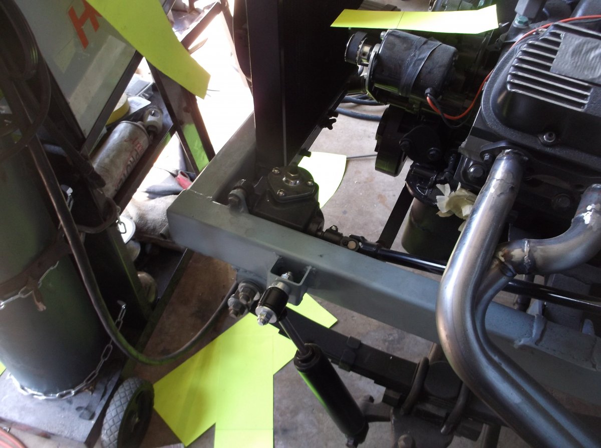

    A few more photos of my shock mounts and my pedals . Reused the original Morris minor pedals ,just modified them from floor mount to hanging pedals . Going to use a cable clutch system modified from a 5.0 fox body design . DSCF3450.JPG DSCF3451.JPG DSCF3454.JPG DSCF3453.JPG

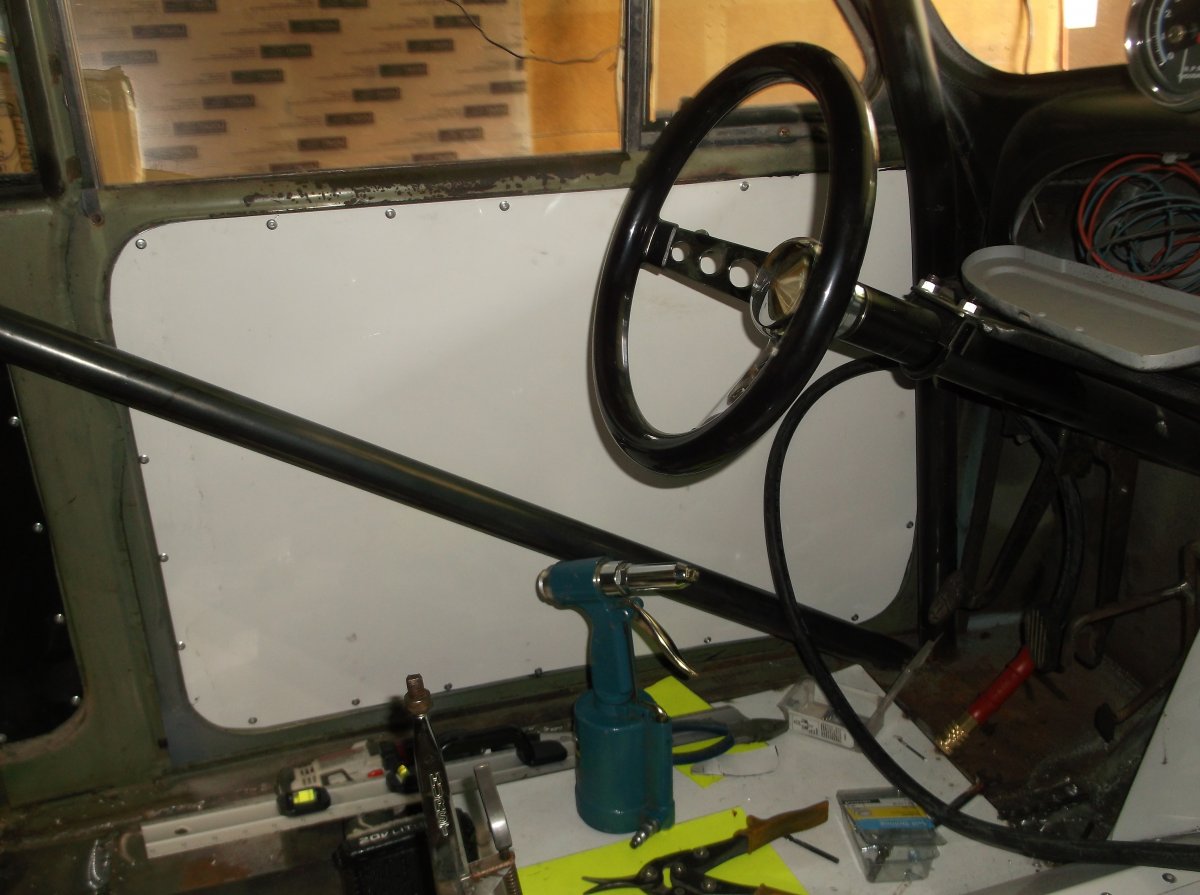

    DSCF3457.JPG DSCF3456.JPG Got the front door panels done this morning. Going to get some pattern paper to make the rest of the interior panels. DSCF3457.JPG DSCF3456.JPG

    Hey! Is that one of those sweet Harbor Freight air powered pop rivet guns?! I love mine. Best money I ever spent, and I got a free tarp with purchase! :)

    Yes it is. I have had it for 5 years and it still works like new.

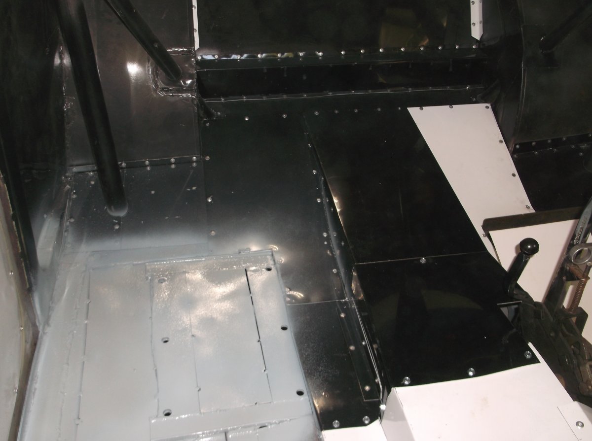

    I have finally gotten floor pans done. I still have one piece on the driver side between the seat and the shifter, but that is just a small piece.
    My steering linkage pieces came today and the final bends for my driver side header. So I can wrap those 2 items up.
    Time to get ready to weld in the door bars and get ready to paint the cage and the inside of the car. DSCF3458.JPG
