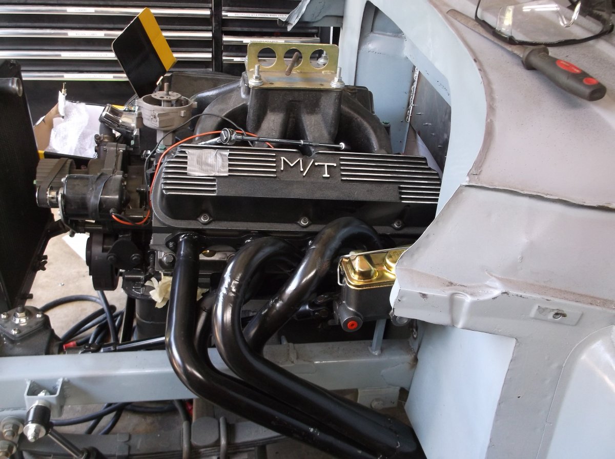

    Finished the driver side header today. These are just temporary as I will be building a set of bigger primary tube headers later. These will get me started. Getting around the steering shaft was a little tricky, but not bad. Had to take into account a firewall mounted master cylinder. DSCF3462.JPG DSCF3461.JPG

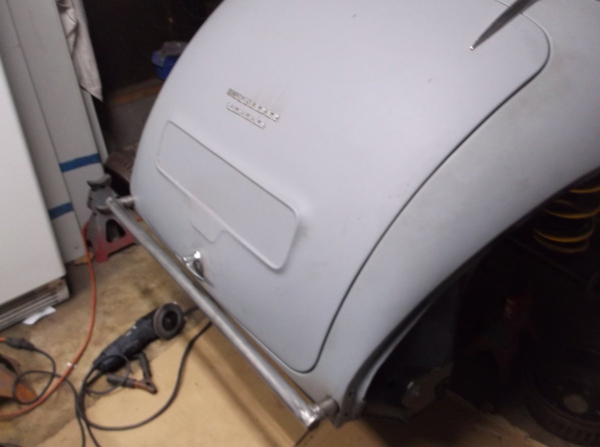

    Decided to make my Southeast G***er required back bumper today. Enlarged the factory bumper bracket holes and used some 1.25 inch roll bar tubing . Leaves plenty of room for my wheelie bars. DSCF3466.JPG DSCF3467.JPG

    Got my master cylinder mounted today. One step forward and one step back. Got the master cylinder mounted and the primary tube for # 8 cylinder would not allow me to take the cap off.
    So I cut up the header and had to remake the tube to clear the master cylinder. That's the problem with putting an American V-8 in an English tea bag. Before you folks get on me about the header tube being too close to the master cylinder. I am going to put a heat shield on the header tube, since wrapped headers are against the rules for the Southeast G***ers. It would be a bigger concern if it was a street car , but this is a drag race only car. the master cylinder is from a 1975 Mustang 2 for manual disc /drum and it works great and is cheap.

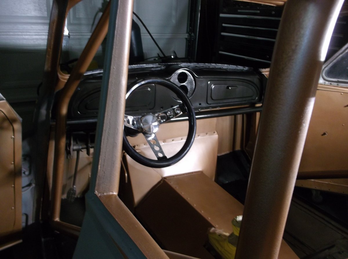

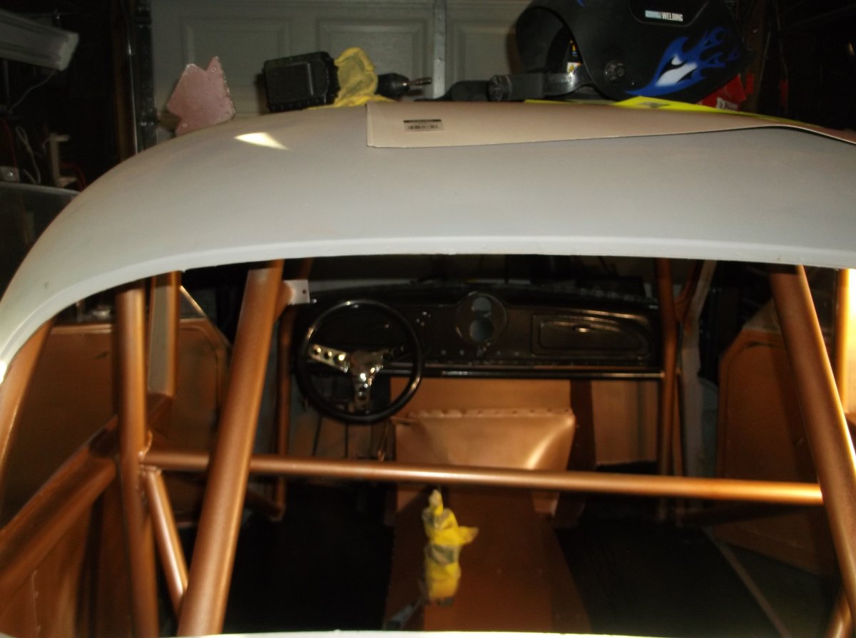

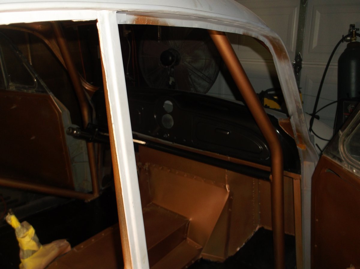

    Well not much to post . I did get the inside of the car painted . Now I can install the gauges and wiring and the seats.

    I got my gauges mounted in the dash and my tach on the dash . Now need to start on a switch panel.
