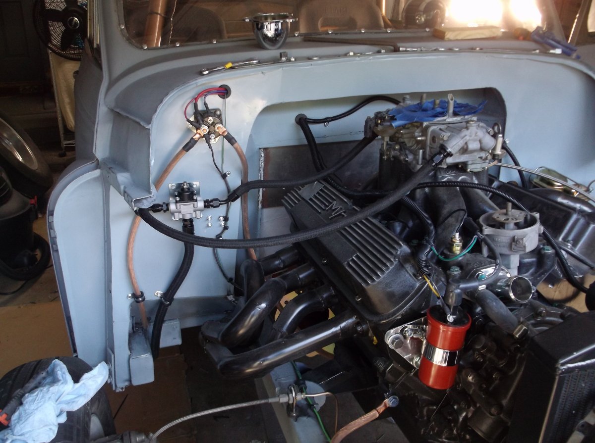

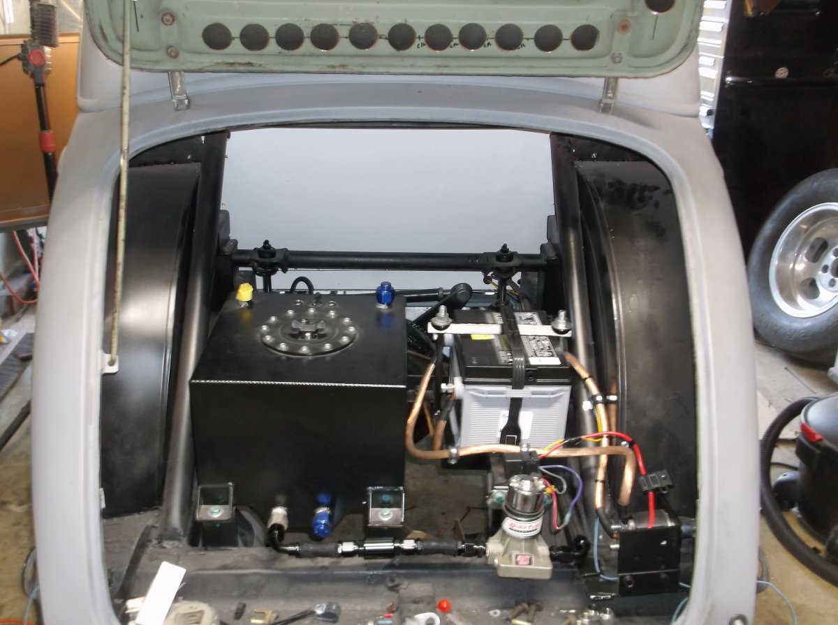

    I got my brakes completely plumbed with my line lock. Got all the battery cables run . Got the fuel system plumbed and the fuel pump installed.
    Got the battery shut off switch in and wired.

    I have been waiting on you to give me a holler to help but you haven't given me a call.
    Looks like you are about ready to race.

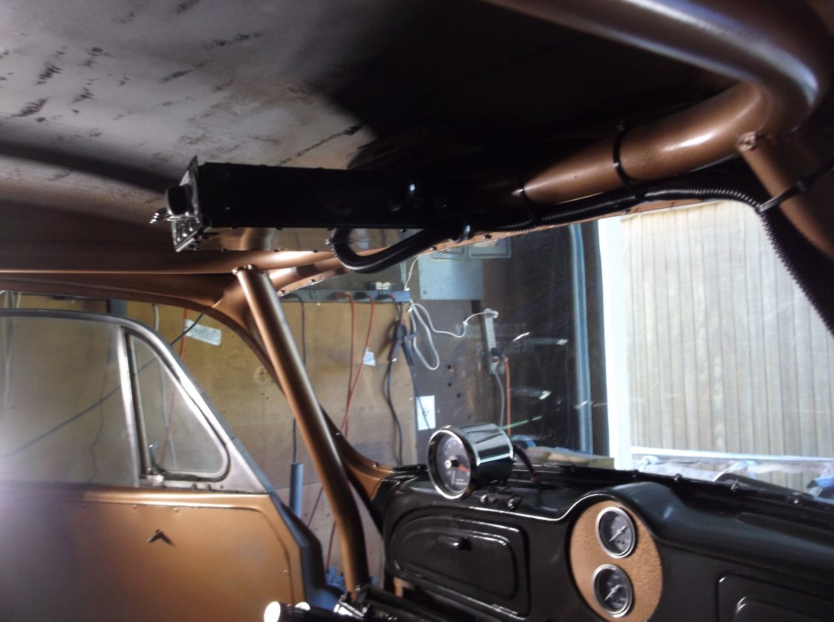

    Built my overhead switch panel today . Will get some pictures tomorrow when I get it installed.

    Got my switch panel installed today and my cooling fan wired. Should have about everything else wired and my ignition box installed. DSCF3490.JPG DSCF3491.JPG

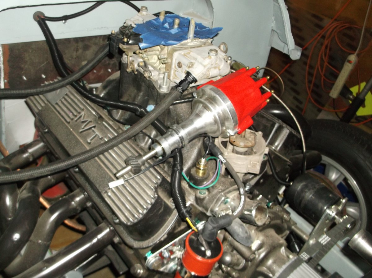

    Contacted the NHRA div 2 tech line . Have been waiting almost 2 weeks for a reply on an answer to the fuel pressure regulator mounting. I think a 2 inch spacer should put me far enough ahead of the flywheel area.
    In the mean time I have completed the wiring on the car and have tested all of the circuits and everything works as it should.
    I also sold my motorcycle on Sunday so I have ordered new slicks and front tires. I talked to Spec clutches today and got the price for my clutch set up.
    Setting my pinion angle so I can get my drive shaft measurements. It is finally coming together.
    Now if I could just get some relief for this pinched nerve in my back . Working on the car would so much more fun and a lot less of a struggle. DSCF3492.JPG DSCF3495.JPG DSCF3493.JPG DSCF3494.JPG
