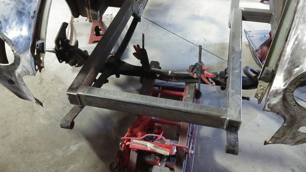

    Got a little done today. Went and got some welding gas and and whipped up a driveshaft loop.

    Got my driveshaft loop installed and my front frame welded in between getting my mother from the hospital to a rehab center after her getting a pacemaker installed.
    thanks for all the prayers and kind words.
    Sorry the picture is upside down, don't know how to turn it.
  12. loudbang
    Posts: 40,351
    Right side up LOL

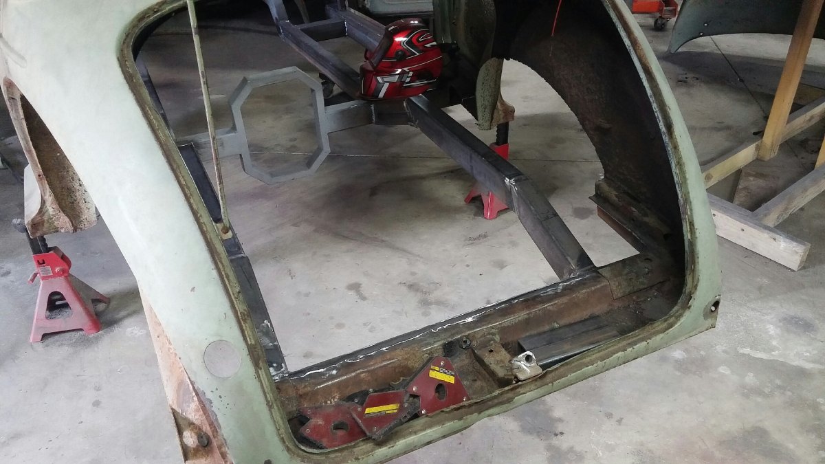

    Today ,I will be welding up the back of the ch***is. It is going to be a coil spring rear and waiting on the coils from Speedway. Thanks for the encouragement. It will be a handful to drive, but that's what g***ers are all about.

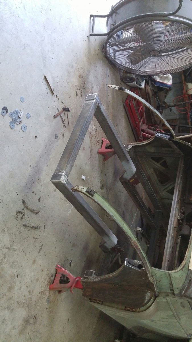

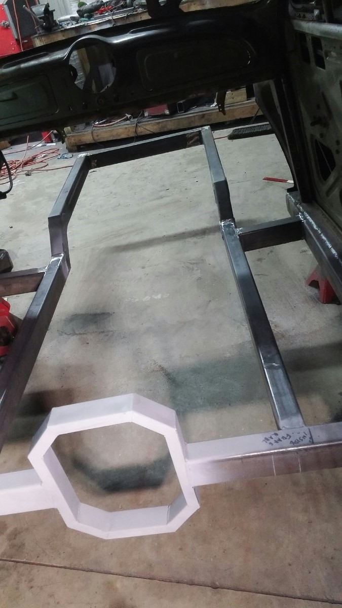

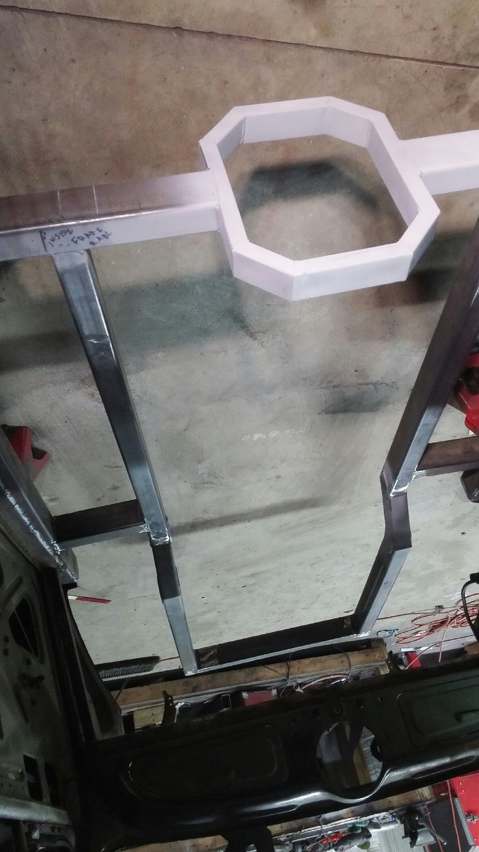

    Finished installing the frame rails all the way to the back of the car, still need to weld gusset plates at
    the frame joints. It is coming slowly,excuse my duck **** welds, but I can't see as good as I used to.
    I am almost 70 and half blind.
    Getting ready for the rear suspension and start on the cage.

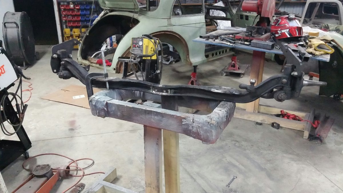

    Got my frame fishplated today and got my f100 front axle cut and narrowed. It is jigged up and ready to be welded back together. So I can drill some lightening holes in it. Trying to cut at least 5 lbs off the axle. It was 2 lbs just cutting the 6 in chunk out of the middle.
    Started on my rear bars, was going to build them like the ones Quain Stott put on the Moonlighter Willys. I decided to use heim joints on the front instead. I can adjust the wheelbase a little this way.

    Narrowed my free 54 F100 front axle to fit the Morris yesterday. Had to cut 6 1/4 inches out of it.
    Now I need to drill it full of holes to try and get some more weight off. Fortunately it drills fairly
