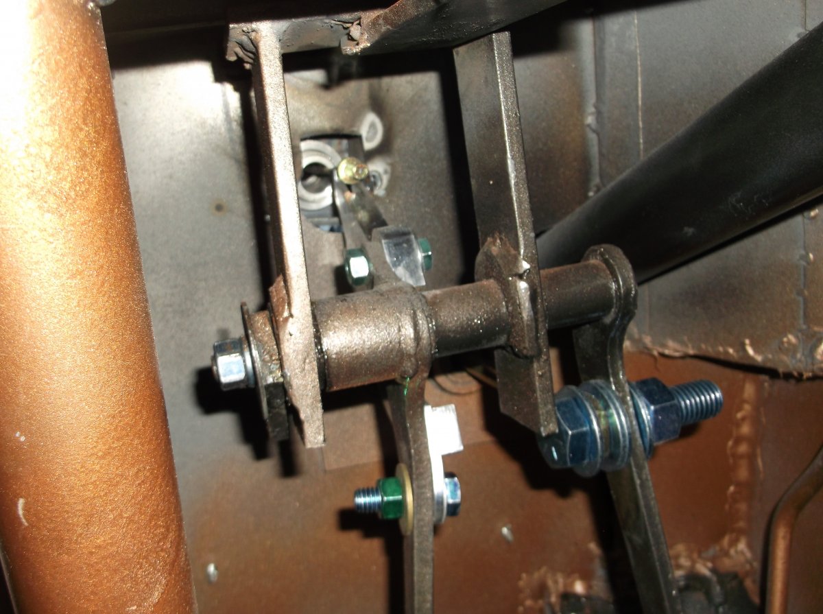

    Figured out my clutch cable set up. I thought I was going to have to make this big elaborate bracket and linkage rod system to go to the pedal. After sitting there and looking at it and thinking about it I came up with a much similar solution.
    I drilled one hole in the pedal used the return spring hole for my top bolt. Then I made a little box for the adjuster to set in and used a hole saw to make the hole and here it is . Easy Peazy.
    I need to make a little bracket for a cable anchor on the frame and get a heat sleeve where it runs over the header tubes and it is done. DSCF3501.JPG DSCF3503.JPG

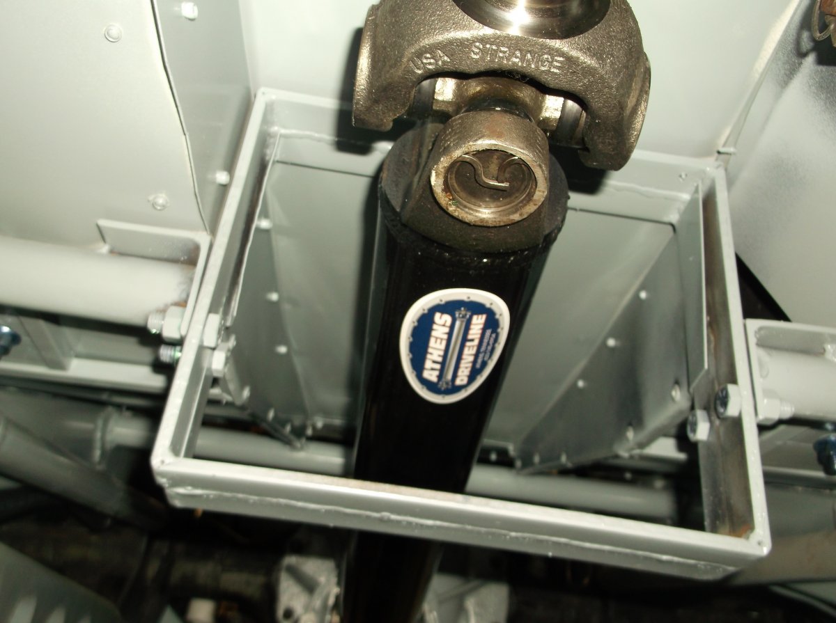

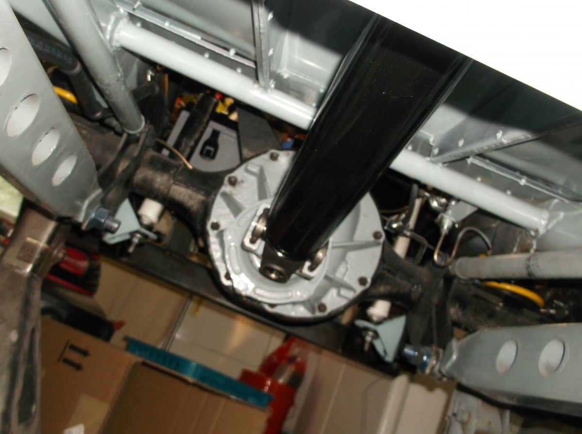

    Got my SEGA legal tires mounted today. I also dropped my new distributor in.
    Went to Athens Driveline and gave them my slip yoke and the measurements for my driveshaft.
    They told me Thursday or Friday it will be ready.
    I realized on the way home that other than the machine work on the block . These are the only things that I haven't done myself.
    As soon as I make sure the drive shaft fits ,it will be time to pull the motor and trans out to install the clutch . Finish the metal work on the firewall and paint that . Then get started shooting some color on the car. I have 2 Gallons of school bus yellow single stage urethane and all of the activator and hardener. I will paint the rear fenders to see if I like the color if not I have a gallon DSCF3507.JPG Candy Apple red.

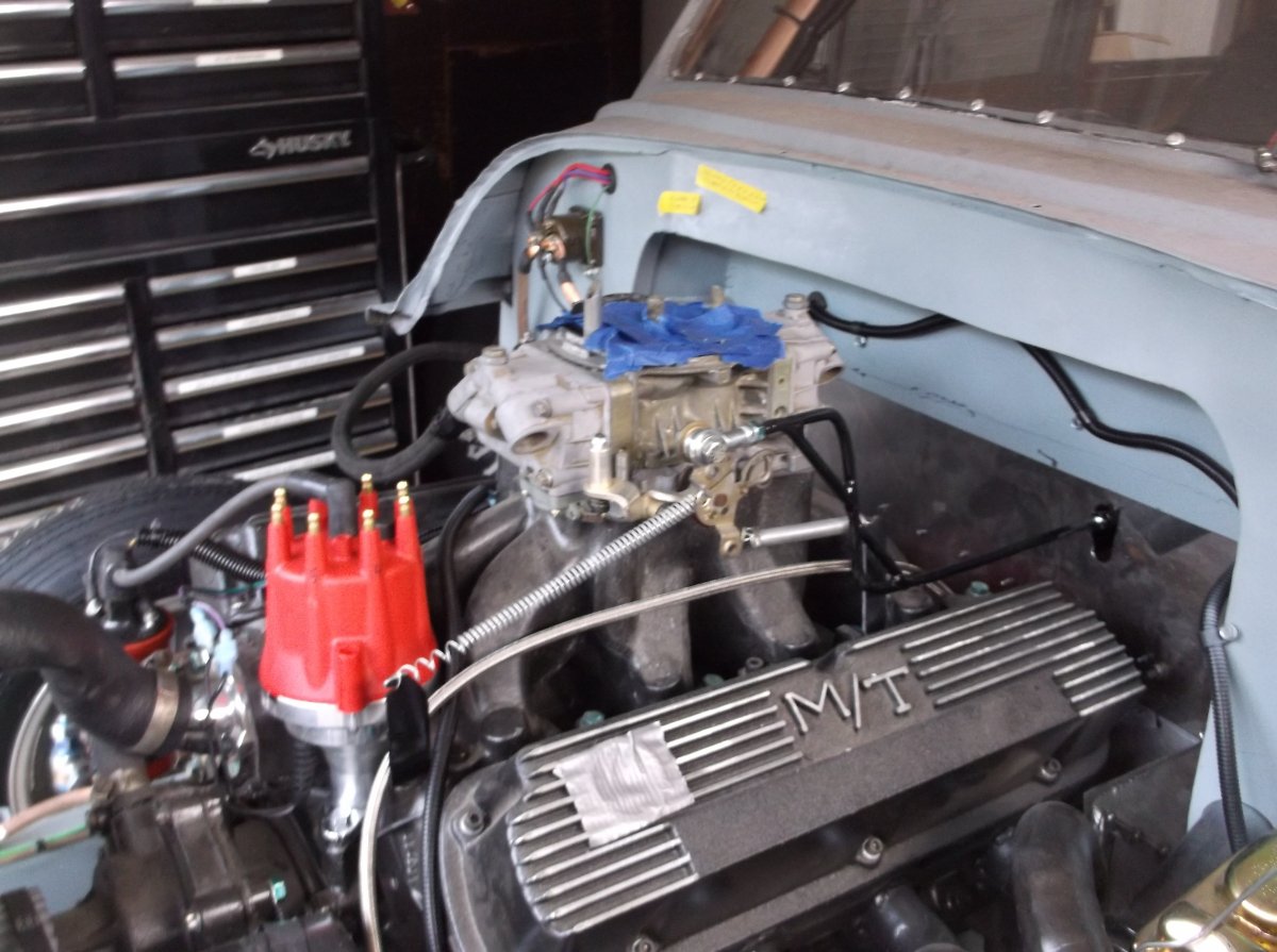

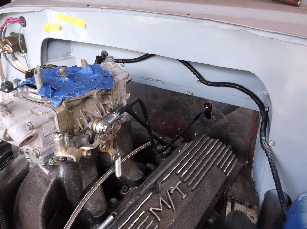

    Got my drive shaft yesterday and it fits so I made my throttle linkage rod from the carb to the pedal.
    Had quite a bend to match up so I braced it a bit.
    Will pull the motor and trans on Thursday so I can install my flywheel and clutch. As soon as I get the metal work done on the firewall ,I can paint it and install the engine and trans and fire it up. DSCF3512.JPG DSCF3511.JPG DSCF3513.JPG

    I also got my return spring for the throttle linkage finished. Hopefully all of the fabrication is done and now it is just pull the motor and install the clutch and reinstall everything and fire it up.

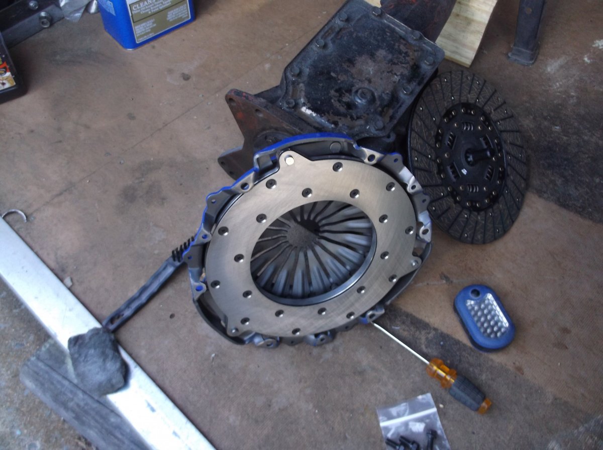

    Screwed again ! I got my flywheel on and my clutch and pressure plate installed. I went to set my clutch pivot height and the clutch fork that I ordered was too short. It is a Lakewood part and a Lakewood bellhousing ,but there is no way to hook up the clutch cable as the fork barely reaches the edge of the bellhousing.
    I call Summit and their tech guy was lost as a dog with a bible , but he did manage to give me Lakewood's tech number and they knew right away what the problem was and gave me the correct part # .
    So now I have to return this part and they will send the correct one.
    For future reference if anyone is using a Lakewood ****tershield and a cable clutch in a Ford application the part # is Lak- 15525. It is longer than the Lak- 15535 that they say works.
    My clutch looks really good .I hope it works like they say it will. The pressure plate is rebuildable for $99.00. It has an aluminum ring to take weight out, and a steel plate for friction. Spec says they have lot's of small tire Mustang's in the 9's with this clutch. DSCF3519.JPG

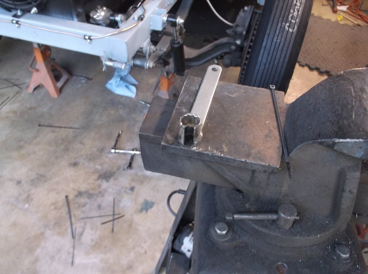

    I decided after looking at it to just cut it and make it longer rather than wait 10 days to 2 weeks for another one that might not work. That way the motor can be back in the car tomorrow night and be running this weekend.

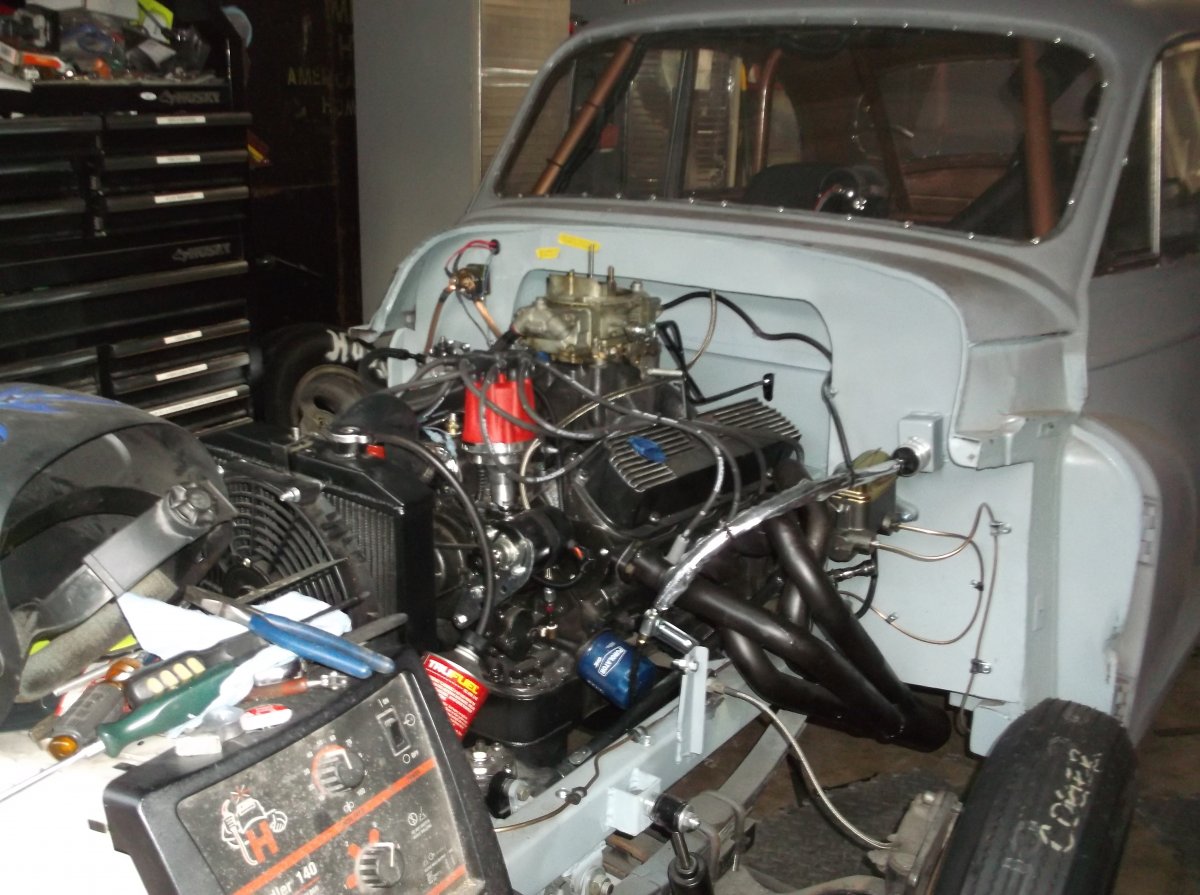

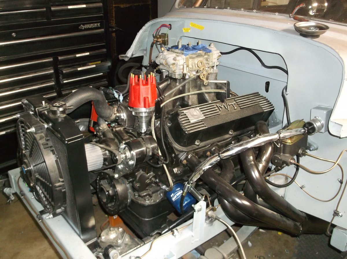

    Well the motor and trans are back in the car. The firewall is painted and almost everything is hooked back up. Got a little too much slack in my clutch cable that I need to address. The clutch fork got extended 1 3/4 inches and lines right up with clutch cable.
    My brake parts are supposed to be here tomorrow so I can finish that and get them bled.
    Got to get all of my fluids and then I can piss off the neighbors. DSCF3522.JPG DSCF3520.JPG

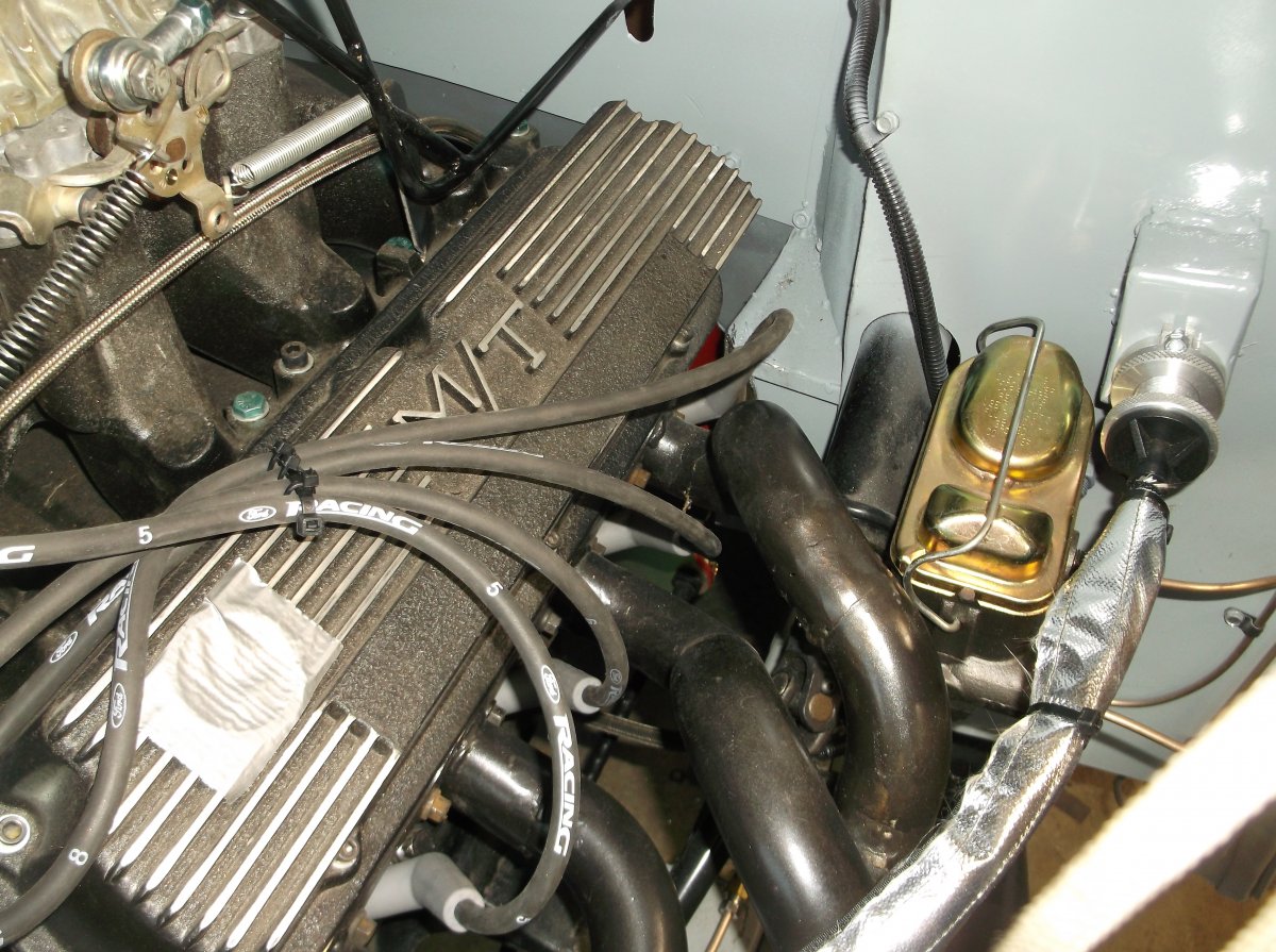

    I thought I would work on the simple stuff today. Like installing the spark plugs, well it went well until I went to put # 8 in and tighten it. That's when I realized after all this time of planning and measuring . I didn't leave enough room for a spark plug socket.
    The room I had to make for the gas pedal and my right foot took up that space. But with the sacrifice of a Chinese socket and the handle to one of my angle grinders. I made a special spark plug wrench for # 8 spark plug.
    The next time I have the motor out I will dress up the spot I had to remove some metal with my air saw. Now the plug goes in and the plug wire does not rub on the firewall. 5 DSCF3524.JPG DSCF3523.JPG minute project took about 2 hours to accomplish.

    I did manage to figure out my clutch cable. It was a simple remount of my pivot at the pedal and a
    small bracket.

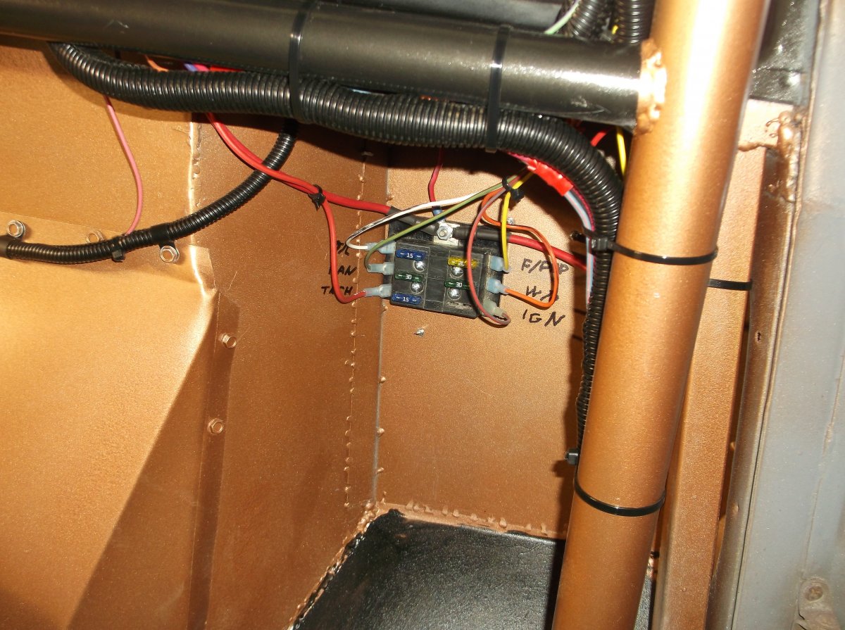

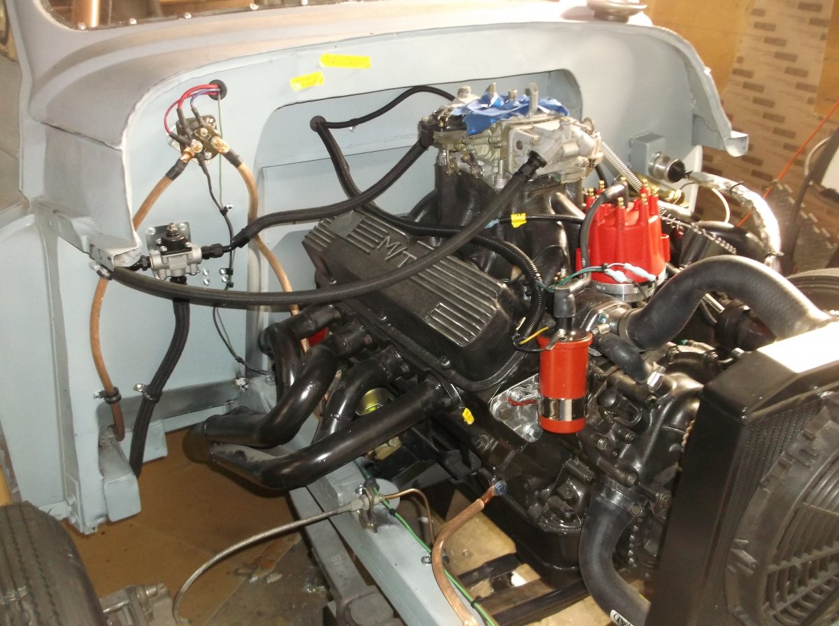

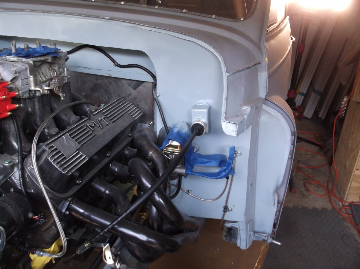

    Thanks for the kind words. I have a confession to make . Being so **** about the electrical .I totally forgot that I had pulled the fuse for the ignition box and so no juice means no spark. I traced the wiring
    using the trouble shooting guide that I downloaded.
    it said the little red wire needs 12 volts or no signal and that's when the
    duh ! moment stepped up and said you pulled the fuse to weld on the car. Popped the fuse back in and got spark. By that time it was too late to crank the car as it was time to go to work.
    So tomorrow morning it should be running. Bottom right hand fuse slot marked IGN empty slot. DSCF3494.JPG

    I would like to announce to the hamb . The awakening of the Morris Minor !! At 6:30 pm on June 21 st 2019, she drew her first breath and it was a loud one the windows rattled scared the hell out my cat and my wife was as happy as I was.
    It has been a struggle for the last few days of trying get this thing to run. It backfired , farted and then flooded. I pulled the plugs and reset everything again figuring I had done something wrong .
    I put it on top dead center and dropped the distributor 3 times . It blew the power valve out of the carb. Then it hit me , this damn thing is firing out of the headers which means late timing.
    I went and looked up the firing order for an old 302 rewired the cap stuck a fresh set of plugs in it. Went over to my neighbors and borrowed his 650 Holley and stuck it on and it fired right up.
    Turns out the guy who sold me the cam told me it was for a 351 firing order and it was for a 302.
    Had I known I would not have bought the cam. Because they changed the firing order to gain power in the H.O. 5.0 which is 351 firing order. Oh well it is mine now and I am looking in the Comp catalog and they have about what I need when I take it apart this winter.
    So I can get me a new power valve and put my carb back on until my new AED carb gets here in about 2 weeks.
