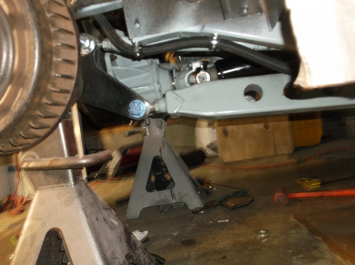

    After I got home from work today I finished up my rear brakes. Then I did my final pinion angle adjust ment. Very critical on a short wheelbase short driveshaft car. Not much room before the u-joints start to bind. I also rechecked my ladder bar adjustment to make sure the wheelbase is the same on both sides.
    I am going to start out with a neutral setting. I am not going to try and flip it over backwards on the first p***. Just get a feel for what the car likes. Next on to building my wheelie bars. My wife told me she is going to buy me an early birthday present. A new AED carb. What a gal! DSCF3527.JPG
    I had made so many p***es in my old blue coupe that I could dial the height of the wheelstand depending on whether I was at a nostalgic show or actually trying to win Super Pro at a big money bracket race. That car actually had a quicker 60 ft with the back tires than if I kept the front wheels on the ground. The car beat lots of much faster dragsters bracket racing . One guy even told me he liked watching my car leave and he forgot to let go of his transbrake ****on.

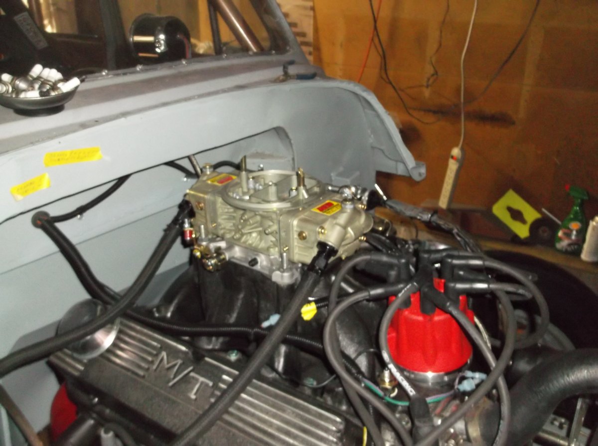

    Got a gift from the horsepower Santa today. My new AED carb came in today. Had time to bolt it on before I had to go to work.
    Got some of my wheelie bars done last night. Will try and finish them tomorrow. Trying to get ready to test by the end of this month. Hoping to have some color on it. Can't just send it to the paint shop so it will be done right here in my driveway. DSCF3528.JPG

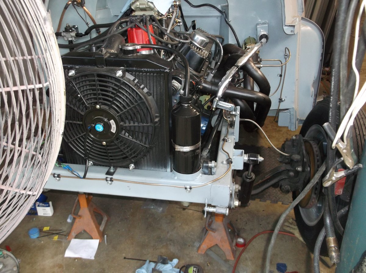

  19. southcross2631
    Joined: Jan 20, 2013
    Posts: 4,412
    southcross2631
    Well it did not see daylight today. I need to work on my clutch cable set up. I need a little more travel to get it to release. Hoping I don't have pull the transmission and adjust the pivot ball.

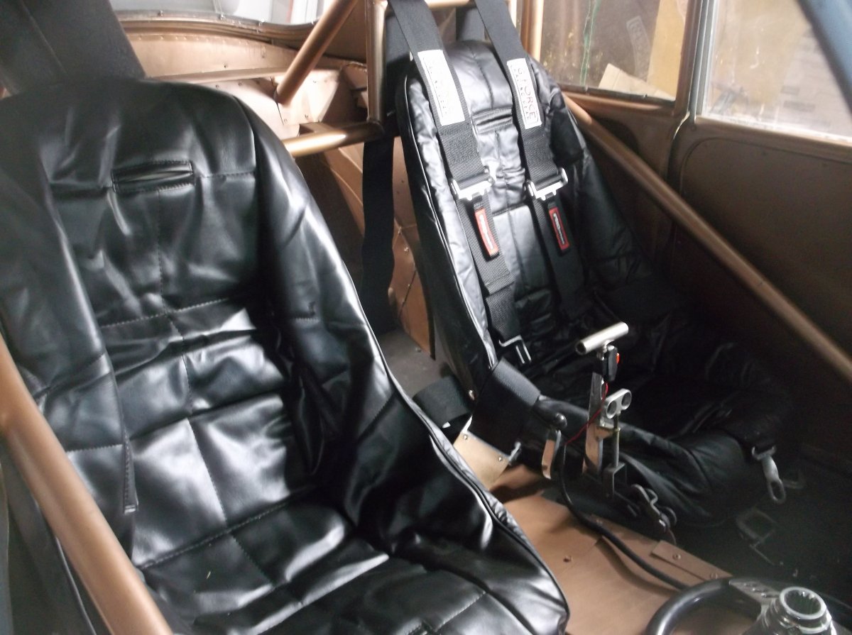

    I did however thanks to Higgy from Canada sent me the seatcovers for my seats. Thank you very much for the good deal.
    I also installed my fuel cell rollover valve, and my radiator puke tank. Also got my slicks on the car.
    My list is getting shorter every day, Just last minute little things that consume time.

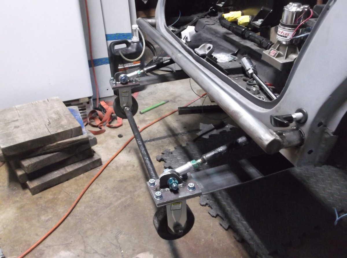

    Yes those wheelie bars are flat plate from Lowes , Heim joints and nuts and bolts from Rural King.
    Casters from an old engine cart. 98 degrees here today. Hotter than Florida was when we lived down there. DSCF3532.JPG DSCF3531.JPG DSCF3533.JPG DSCF3533.JPG DSCF3534.JPG
  20. southcross2631
    Posts: 4,412
    southcross2631
    Well I raised my pivot point on my clutch cable bracket giving me more throw. The pedal pressure got less which tells me I am going in the right direction, but still not enough.
    So I pulled the transmission and adjusted the fork pivot ball and lengthened the fork a half inch which gave me perfect alignment of the fork to the cable.
    Now to put the transmission back in this afternoon after I get off work and hopefully that fixes it and I can take it around the block.
    Wish me luck it all works out.

    Well got the transmission back in the car this afternoon before the storm hit and knocked out the power for a while went in the right direction but not far enough . have to pull it back out and adjust on the pivot ball some more.
    Won't be until Monday .
    Fiddle Picker likes this.

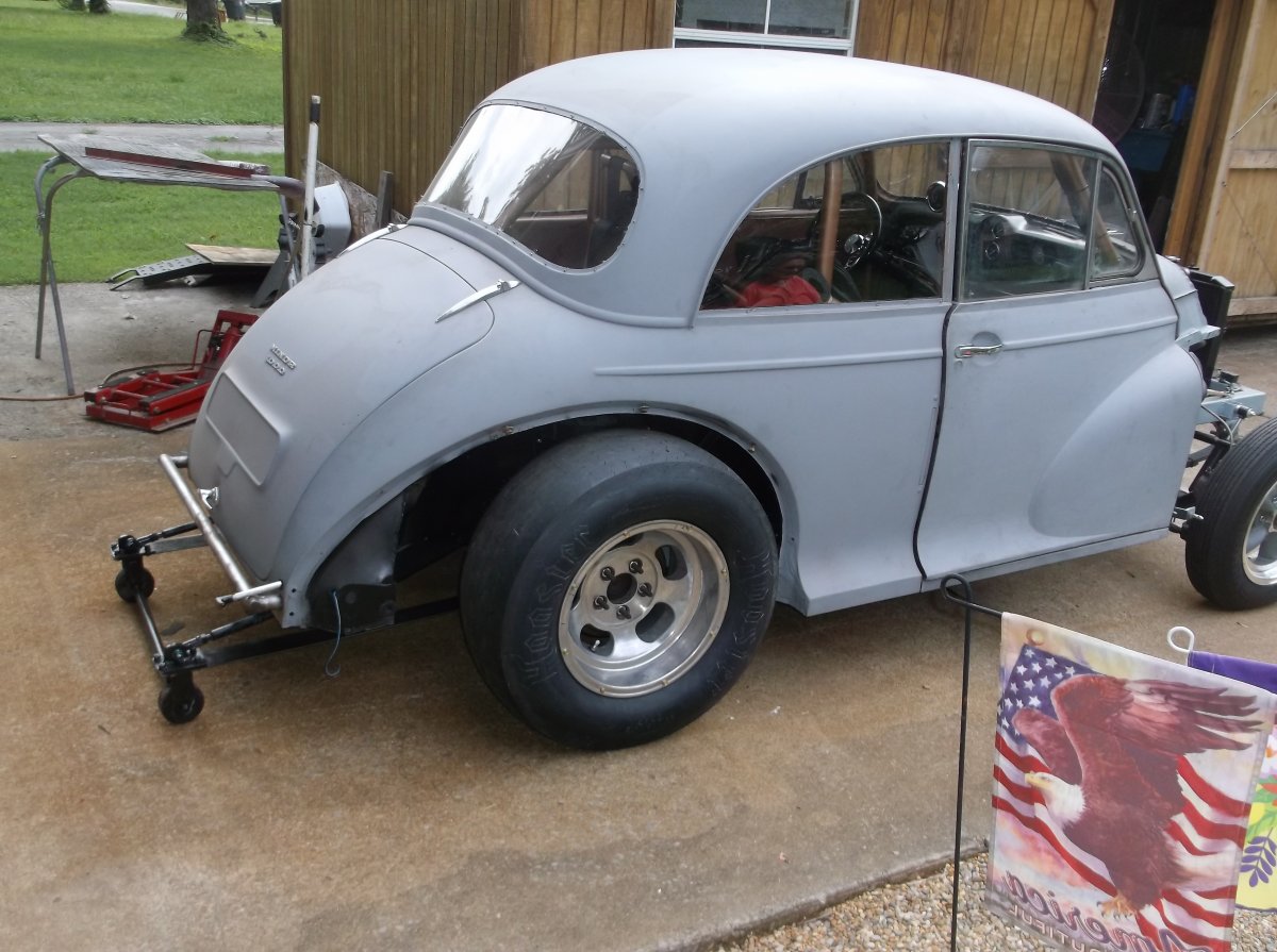

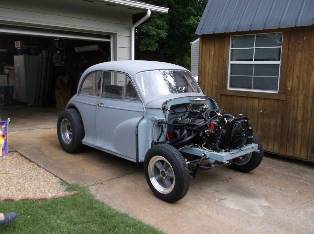

    Well after 3 tries today I have a clutch and a running driving car! Started out this morning by pulling the trans and adjusting too far . So back out with the trans again adjusting some more. Still not enough so back out and a another half turn on the pivot ball and success.
    I redid my upper cable adjuster mount. This time bolting to the firewall instead of welding it because I had to raise it to get a straight pull on the cable at the pedal.
    Put everything back together and took it off jack stands for the first time in over a year.
    Set the ride height to the SEGA minimum required ride height and adjusted the wheelie bars So I get 8 inches of wheelstand before the wheelie bars touch down.
    Drove it outside and ran it for about 15 minutes, set the timing and adjusted the carb . Turned it around and drove it back inside. Tomorrow I will shoot a video of the first trip around the block. DSCF3536.JPG DSCF3537.JPG DSCF3538.JPG
