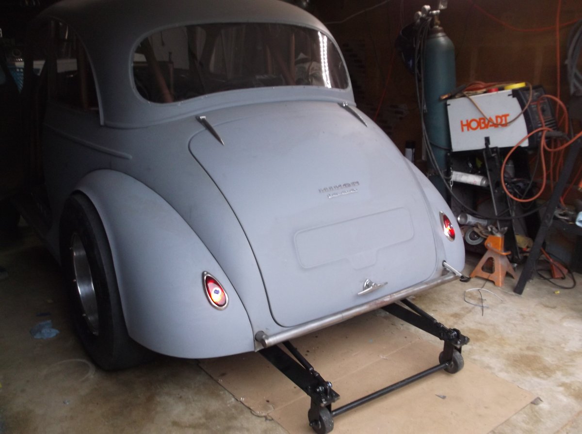

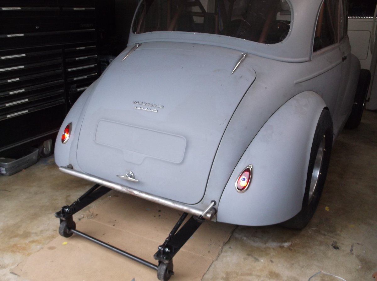

    well got the back fenders on and the taillights wired. Discovered the cooling fan is a puller and not a pusher so had to reverse the wiring to make it a pusher. It rained all morning so we couldn't get the front clip out of the storage shed. We would have had to put the car outside and it was raining a little too hard for that. then we had to go to work. DSCF3539.JPG DSCF3540.JPG

    I know you already know this...but the slick on the driver side sticks past the fender lip further than the slick on the p***enger side. Is the driver side fender pushed in or the p***enger fender pulled out?

    It bothered me too. I was going to adjust my Panhard bar to pull the body over to the left until I looked at the fenders and realized when I flared the fenders that I brought the driver side straight down and the p*** side is flared out staring at the crown of the fender. I am going to see if I can work the p***. side fender down to match the driver side. Thanks for noticing, my wife picked up on it when we were admiring the tail lights.
    This is the first time I really had a chance to stand back and look at them. I slammed it together down in Florida when we moved and then took them off when we got up here to put the tubs in.
    I figure maybe it throw my compe***or off in the other lane when they are looking at the back of the car and see the fenders are not the same and miss a gear trying to run me down.

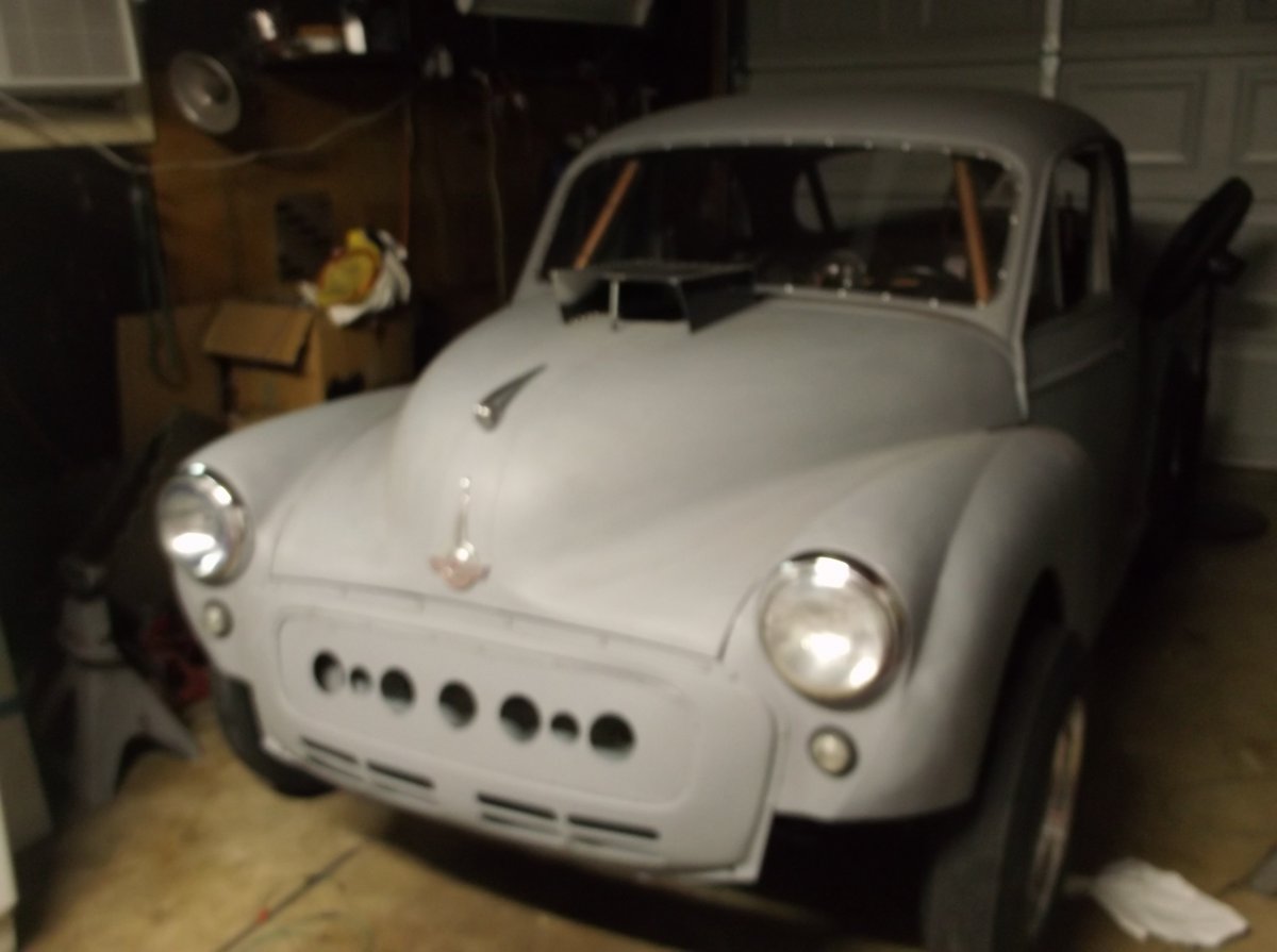

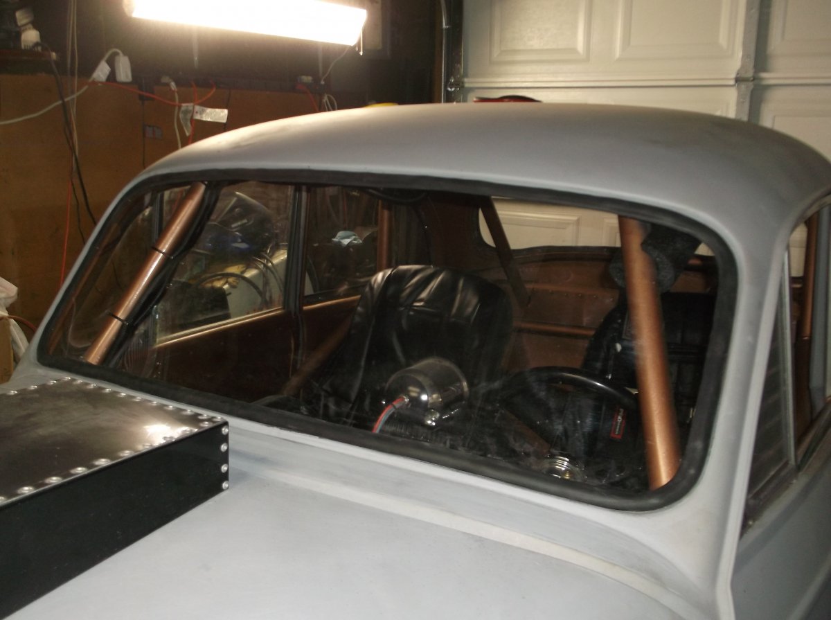

    Got my molding on around the windows so you can't see the rivets that hold the lexan in. A SEGA rule. DSCF3546.JPG

    What kind of molding did you use and where did you get it?

    I got it off ebay. It comes in a roll. Just type in windshield molding. Mine came from a place called GoodWillStores . It has 2 peel and stick strips on the back. Probably Chinese made, but it works.

    Hemibert, hold off on ordering that weatherstrip. I went to the garage this morning and the contact adhesive let go in several places and was hanging down. I am either going to have to get some 3M weather strip adhesive to try and repair this . I have contacted the ebay seller and am waiting for a response.

    3m super(black) weatherstrip adhesive can fix anything! Awesome product

    cleaning the surface before sticking would be important

    I did like I always do .I cleaned everything with alcohol. It was just a ****ty Chinese product . The ebay seller is replacing the order and it is being shipped out.
