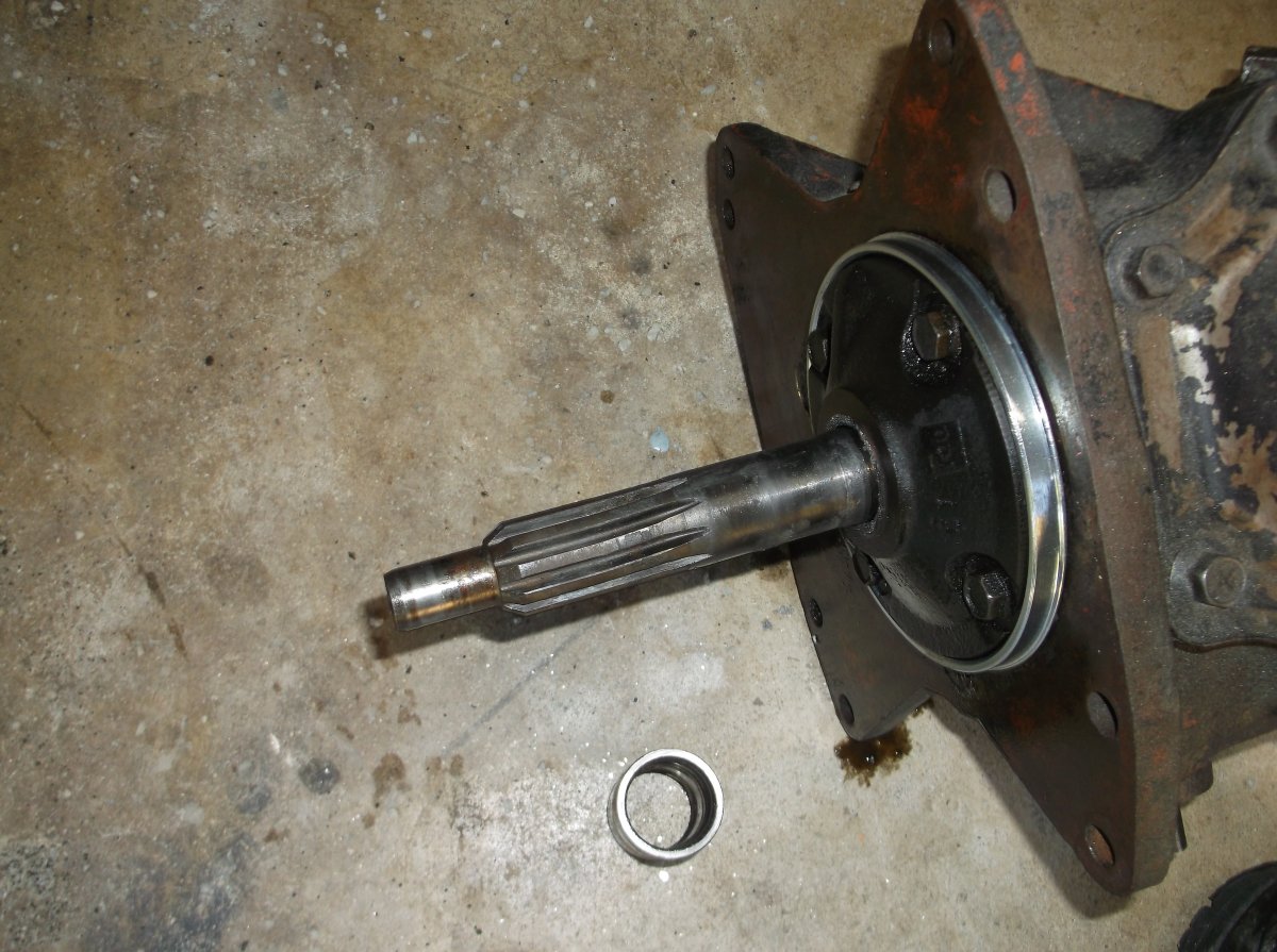

    Well the autopsy is completed. It broke a rear main cap and then it spun a main bearing. Or it spun a rear main bearing and then broke a main cap.
    The damage wasn't limited to the motor. The input shaft collar broke and the input shaft was twisted.
    It probably twisted on the launch because I could barely get it in gear on the return road.
    Surprisingly I was able to drive it back to the pits and it still had good oil pressure and no knocking noises coming from the motor.
    It is time to break out my 289 block and start building for next year. I will need rods and pistons and a new cam. Talking to Jimmy Huff, noted Ford engine builder . He has a Boss 302 crank and I can either go that way or use my 289 crank and build a 294 and take some more weight out of the car.
    Going to contact Liberty about a cryo treated input shaft or just go with a big block input shaft. DSCF3563.JPG DSCF3565.JPG

    surprised that the rear main cap broke, that's the one with the most metal. Can't see significant heat coloring on it either. Who knows, sometimes things just break. That's tough luck on your first race, glad to see you're planning to return with some improvements. Were the rods and pistons hurt?

    Ouch. Racing ain't cheap. At what point do most guys step up to a Hightower trans over a Liberty? What are the cost of each?
    loudbang and Fiddle Picker like this.

    brian, none of the big boys are running toploaders. Some are running hightower, a bunch are running G-force, and a few are still running jericos. Cost kind of depends, deals come up pretty often for used hightowers/jerico/g-force. Or you can spend just about as much to make a toploader handle the beatings short term, but after you repair it once you might have so much invested in it that you'll wish you'd have bought a hightower/jerico/g-force and saved a bunch of time, maybe a wasted race trip. I believe Mike got a really good deal on his toploader with some good work already done to it.
    loudbang, Fiddle Picker and brianf31 like this.

    I bought the top loader with all of the Liberty guts except for the stock input shaft for a grand. I can upgrade to a big block input shaft for about 300bucks ,That includes the input shaft ,bearing collar,throw out bearing and fork.
    We ran a similar trans in a 67 Firebird in G/Gas. that was way heavier with way more tire. It had a 9,000 rpm small block Chevy.
