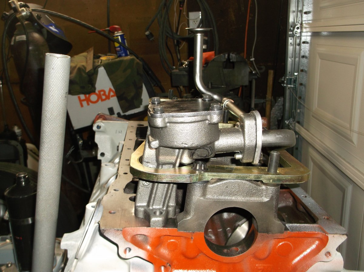

    Got my main girdle in yesterday. Started mocking it up today and ran into a slight issue.
    Contacted PRW and they are working on getting me the correct hardware so the oil pump will set down on the block. DSCF3573.JPG
    Fiddle Picker, brEad, Crosley and 4 others like this.

    In spite of being busy with the SEMA show. Shaun from PRW managed to take the time to send me a shorter stud and the nut needed to attach the girdle and to clear my oil pump.
    Customer service is not really prevalent in a lot of companies these days. It's good to see some companies take care of their customers.

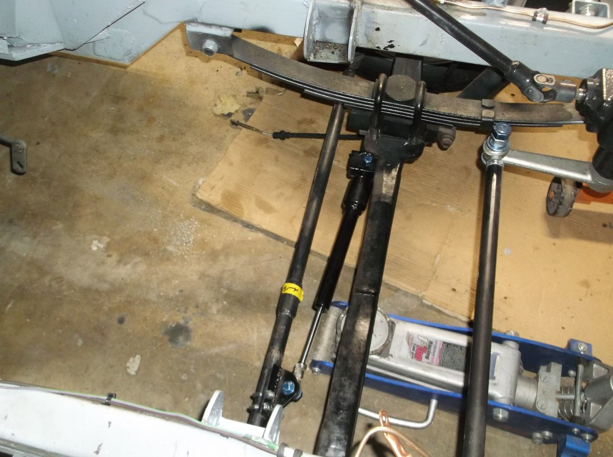

    Finally healed up a little bit from my back surgery to do a little bit. Still can't lift over 30 lbs until Jan.
    I made my steering stabilizer brackets and got the stabilizer installed. Should help cure the death wobble that I experienced at Knoxville.
    Got my main girdle mocked up. Now just need to order some bearings and polish the crank. DSCF3575.JPG DSCF3574.JPG
