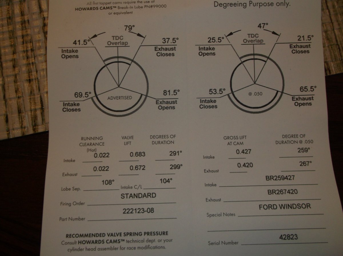

    It's not all bad news today, my cam came in. This should make my little ford sound sweet and run like I hope it can. DSCF3578.JPG

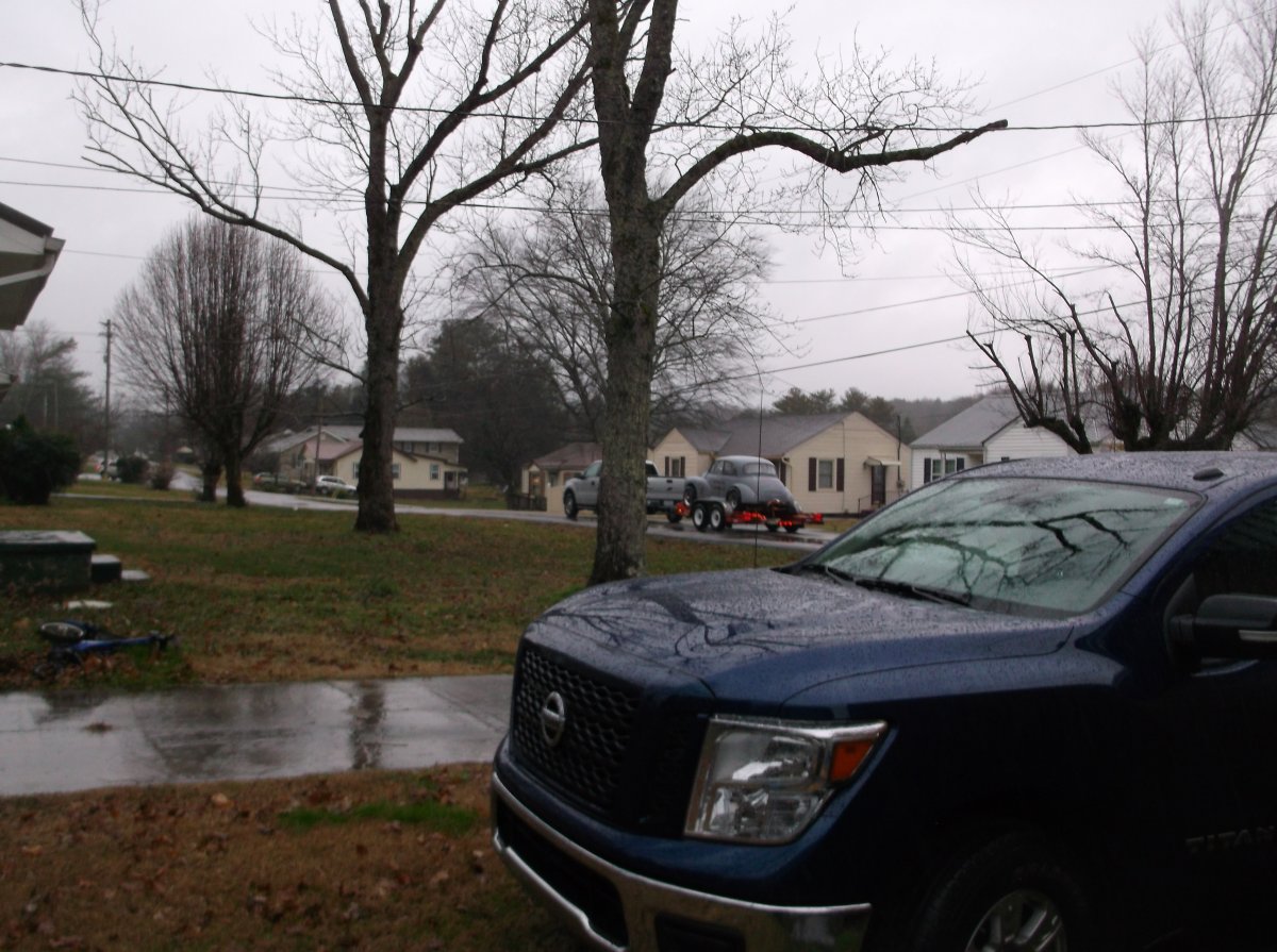

    Loading it up in the pouring rain today. Me in the green jacket getting soaked. Good bye car. New owner Heath. DSCF3589.JPG DSCF3586.JPG DSCF3584.JPG
