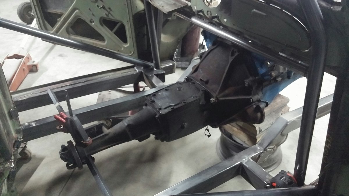

    Got the motor and trans mocked up in the car tonight. Will be making mounts and cross member this
    weekend as it is going to be too cold to paint .We are in Fl. for crying out loud it is supposed to be 33 this weekend with a high in the low fifties. Danged global warming. 20170105_1900201.jpg
  8. southcross2631
    Joined: Jan 20, 2013
    Posts: 4,412
    southcross2631
    here it is from the front. The tabs off the heads to the frame are just to hold the motor in place so I can build side mounts. 20170105_1900511.jpg

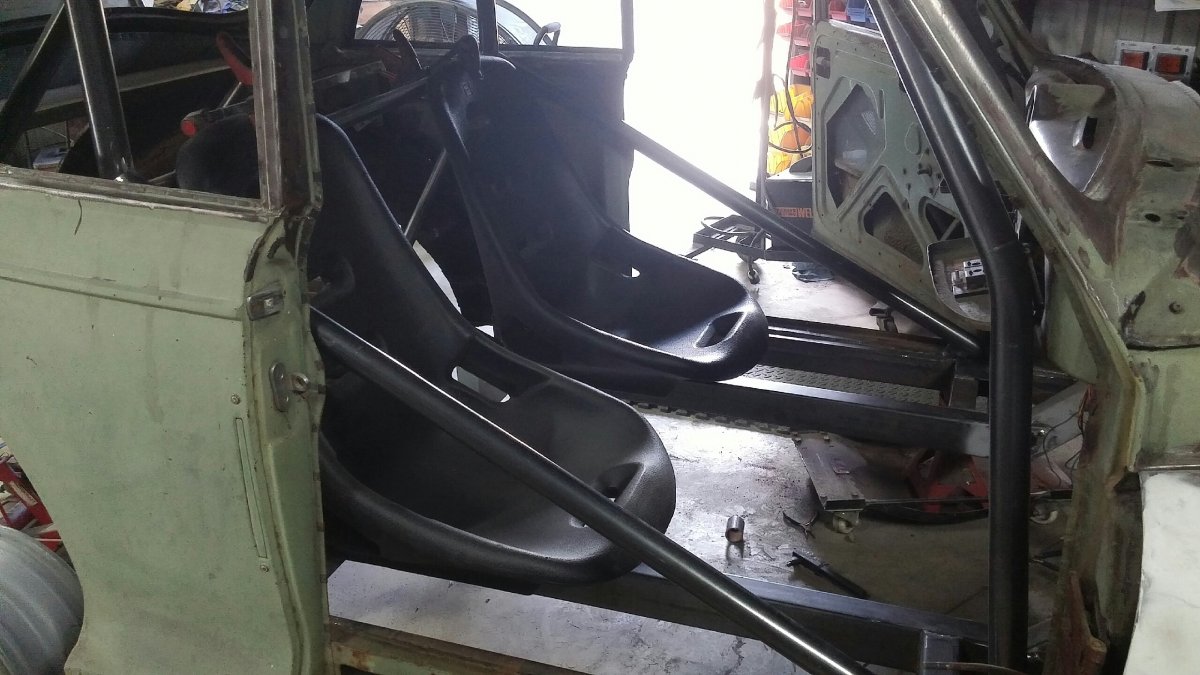

    Like it a lot but under no cir***stances would I use those plastic seats...just me.

    You send me some nice aluminum seats and I will be glad to install them and put your name on the car.
    These are the same type seats a lot of the Southeast G***ers are using. I would have used the original seats ,but they did not come with the car.
    My build , my wallet, my choice ,but that's.... just me.

    Got the trans cross member fabbed up today. Welded some sleeves inside the tubing to keep it from collapsing when I tighten the bolts. Will start on motor mounts tomorrow afternoon. It should be warmed up by then. Supposed to be 32 degrees here tonight. Almost a tornado last night and freezing tonight. Welcome to sunny Fl. 20170107_1617521.jpg 20170107_1618221.jpg

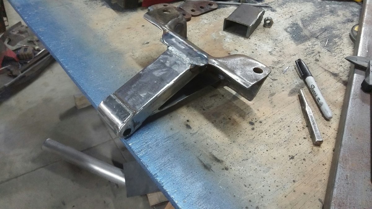

    southcross2631
    Got the mount in the car. Used part of some old broken stock motor mounts by separating them and grinding the rubber off. Then welded tubing to the half that bolts to the block . Made sleeves for the bolts to go through and bent some flat steel around the sleeves, welded it to the tubing making it much stronger. then added a brace to the bottom with some 1/th inch steel plate to gusset the tubing.
    Real strong and real easy and cheap to make. I have less than $ 4.00 in them and about an hour labor. Need to make some gusset for my frame tabs, should hold my little 306 with no problem.

    This is the driver side motor mount made from old broken stock mounts. Quick , easy, strong using s****s from my metal barrel. 20170109_1044431.jpg
