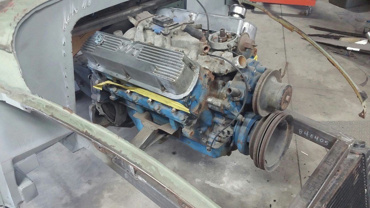

    20170203_0758271.jpg I got in my old school M/T valve covers . Trying to decide whether to paint them with black wrinle paint or just buff them out the best I can and clear them.

    Just 'gl*** bead blast' and coat with a quality satin clear, no fuss valve covers.

    Don't paint them with wrinkle paint it will take away from the old school look. Just blast them and use them. I don't even put clear on mine because that don't look just right to me. No sure i would even blast them.

    Black between the fins and polish the ribs.

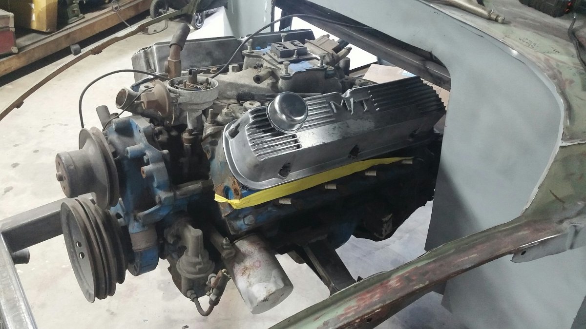

    They are right out of the parts washer in the picture and that's the way they are going stay. Got too much work to do on other things right now thanks guys for the suggestions. Here' 20170203_0758381.jpg s the other side.

    What's that oil pan? Long pickup?

    Double sump fox body. It is a mockup motor a guy gave me so I don't know much about it. It is a bunch of parts, he said ran when it got pulled. Has a an early 80's block , fox body pan, aluminum 2 barrel intake and a points distributor. It is super clean on the inside.

    Ford offered their over the counter "cobra" lettered valve covers in black wrinkle with polished fins in 64 or 65. I ***ume this is the look he was trying to replicate.

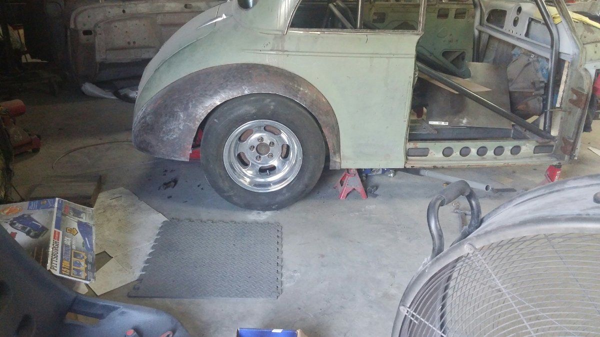

    20170217_1655381.jpg Got the rear end with the wheels mocked up yesterday . Had to open up the inside and outside fenderwells a little more to make room. 28 x 9 inch slicks on 15 x 8 Ansen's. Ride height set at Southeast g***ers rule for short wheelbase cars. 10 inches minimum measured at rocker panel in front of rear tire and 11 inches at rocker panel behind front tire. Not a nosebleed street freak.

    P***. side. Still to cut a little more out of the wheel well. Also from the rear to show how much the tire will stick out. Please excuse my messy shop. I have been really trashing on the Torino from hell and haven't had time to clean. 20170217_1656431.jpg 20170217_1656141.jpg

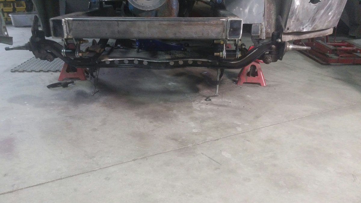

    Got my front springs mounted and my axle drilled over the weekend. Here's a picture of the narrowed and drilled front axle. 20170305_1456091.jpg

    You might want to have a bit more distance from the rear tire to the fender I case you hit a good bump, as you don't want to bend your fender
    On my 37' the body man was able to roll the sheet metal under to form a rolled edge, so the sharp edge will not cut your tire
    Maybe you can weld in a tube for your finished edge

    Thanks , I am going to make one more cut on the wheel wells and split some conduit and mold it to the fender to give it a finished look. Don't need the fender to put a slice in the tire in case this Cadillac gets a little sideways. Nothing like a 89 inch wheelbase 4 speed car launching at 6 grand.

    They look more period if the roll is flush with the outside surface of the fender, and not so much like a custom car with a molded bead

    Got my front axle up under the car finally . Got the steering rod shortened and installed. Still need some caster wedges and some ubolts. Now I can put the brakes back on and get some front wheels. 20170312_1858001.jpg
