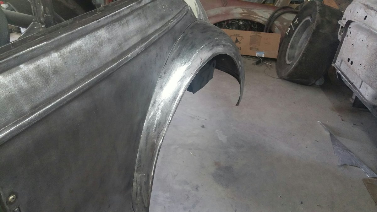

    Can't afford to send my junk to someone to build for me. So I have to do it all including paint. Figured out how to flare fenders with a bead roller . Now just hammer and dolley and grind the edges. 20170330_1512081.jpg 20170407_1009511.jpg

    Got my fender flares hammered out today . Time for a little bit of fibergl*** to get the final shape. Got the doors in primer today . Really boring stuff that has to be done. Lots of block sanding ahead. Any volunteers ? 20170411_1251141001002.jpg 20170411_1250301001.jpg

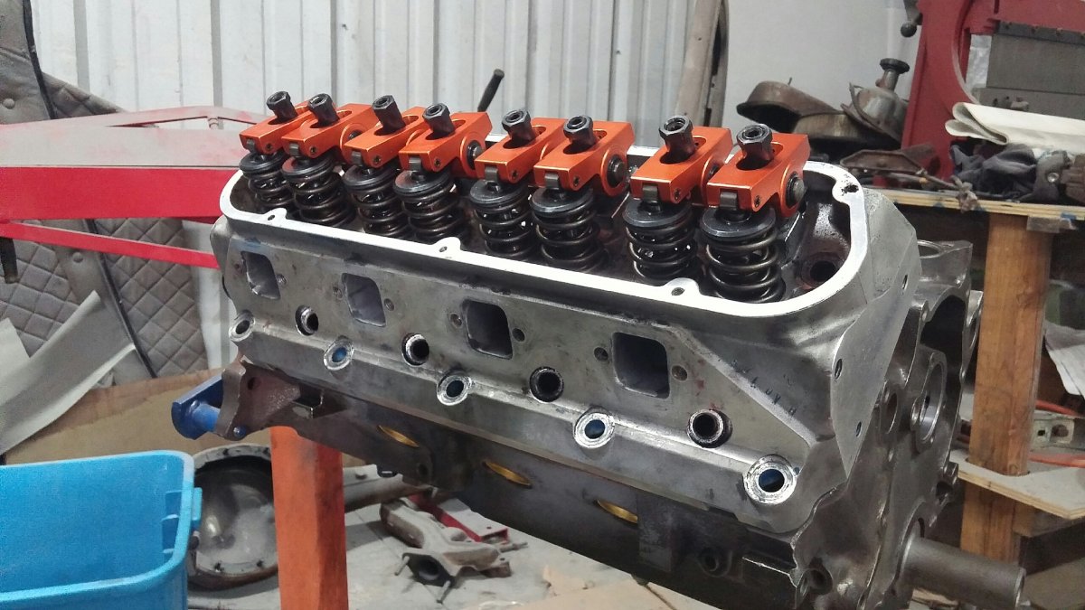

    These are my latest hand me downs. New valves, new springs, new retainers, new roller rockers, less than 60 p***es. Made over 500 h.p. on 357 Windsor. Got a cam Research solid roller . .600 lift should make this little 306 buzz. 20170502_0921391.jpg s.

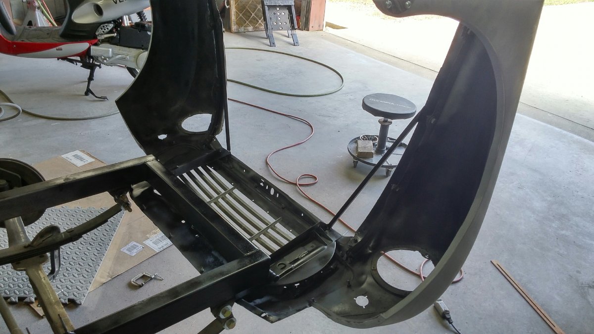

    Thought I would show a few photos of the simple Hinges and hood pin brackets in case someone was thinking about building a tilt front end. I put built in stops in the hinge so I would not need cables or chains, but can't see them in the pictures. Just pull two clevis pins and the whole front end lifts off. 20170514_102257_HDR1.jpg 20170514_1022091.jpg 20170514_1022401.jpg 20170514_1017441.jpg
  21. Crosley
    Posts: 1,141
    Crosley
    from Aridzona
    Are you bolting the hood to the fenders? Clean setup on the hinges , simple, easy
  22. southcross2631
    Joined: Jan 20, 2013
    Posts: 4,412
    southcross2631
    No I welded the hood to front fenders , but it could have been bolted, Trying to get my phone to talk to my computer so I can post some pictures. I made the tilt hinges from some black iron conduit. Just reamed it to 1/2 inch and bought clevis pins and clips from Rural King . The rest is just steel s****s from my steel barrel where I throw all my cut off pieces. The Morris Minor has a rib in the core support right at the width of my frame. So as you can see I had to use a piece of metal to match the height of the rib.
    When the front end is tilted the bottom of the core support hits the bottom of the frame rail and acts as a stop for the front end. So no cables or straps needed to hold it from tipping to far.
    Just pull clevis pins and the whole thing lifts off. Will start on hood scoop this weekend.

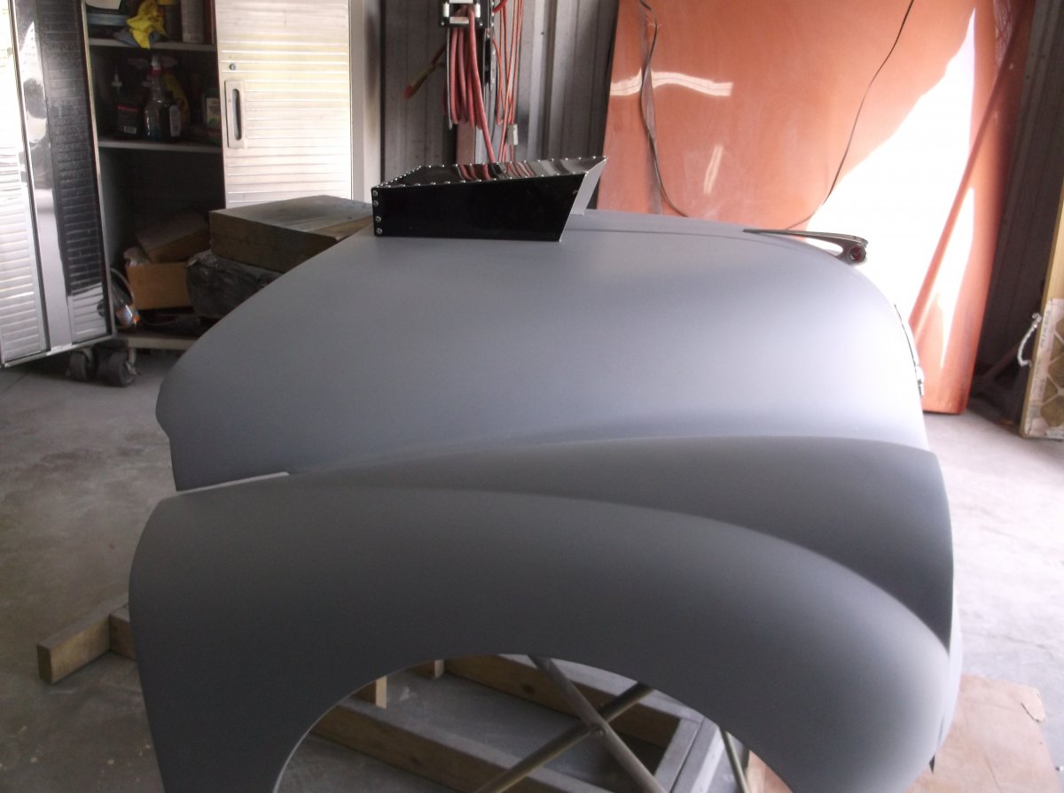

    Built my hood scoop this morning . I am smoking some slabs of ribs today and so the smoker is right outside of my shop so there is no sense standing around watching meat burn. Still not sold on the design, but I gotta put something there because the carb is going be above the level of the hood. DSCF3384.JPG DSCF3385.JPG

    The Scoop looks perfectly period correct to me.

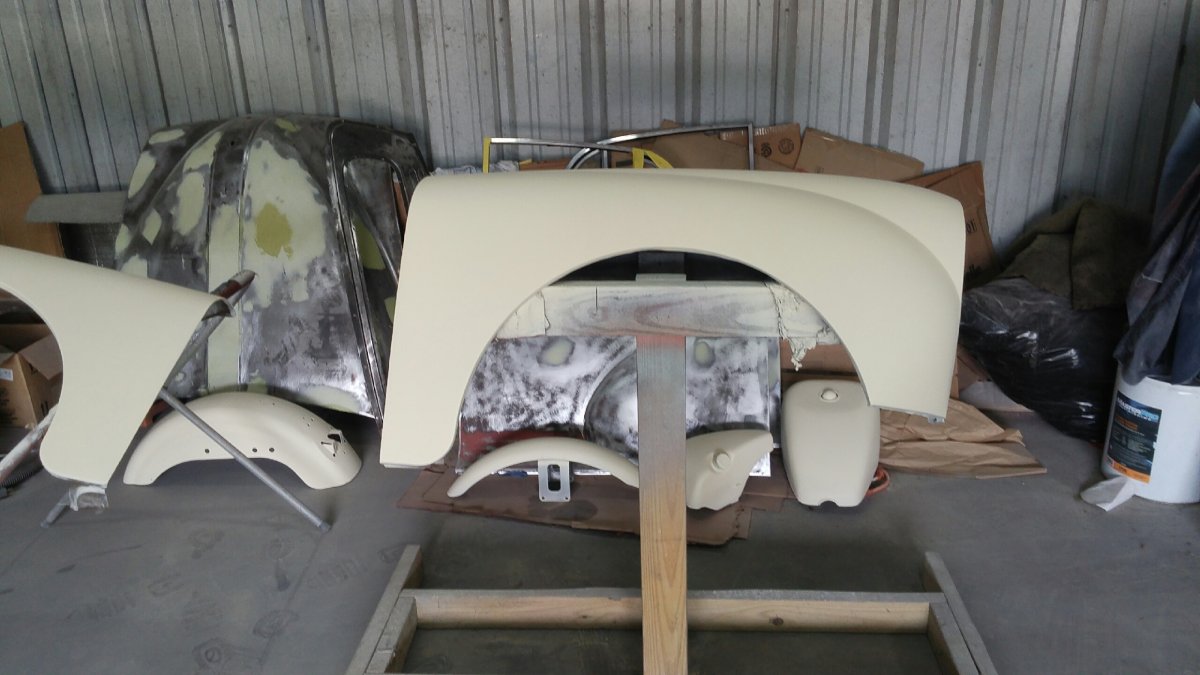

    Ready for paint. Or at least to lay out the stripes. Got a little blocking on the roof then primer and the car is ready to get some color. DSCF3387.JPG
