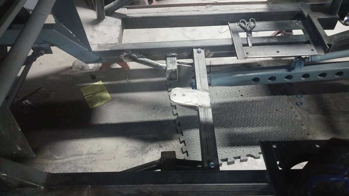

    Got a little more done today. Worked on the front mounts for my ladder bars. Still got the braces underneath the mounting brackets to do. Excuse my ugly welds. I don't see as good as I used to.

    That ladder bar top tube is going to pull on its front mount pretty hard?
    Lotsa ladder bars have xig xag fillers?

    These are old school bars before the bridge work bars became popular. These will allow me to adjust pinion angle, wheel base , and change the instant center to control the wheel stands.

    Still reminds me of the pump handle on a well jack.. lots of
    leverage on that front upper bar mount.

    Quain has built a few of this same design bars for the south east g***er cars. They have way more power than my little Ford with no issues. The stress is on the front lower bar mount, that's why it has been sleeved and mounted in a piece of 1/4 inch steel drilled to fit the heim sleeve and then slotted into the front of the bar, Then welded. If I bend them or break the top bar mount, I will gladly beef them up because I built a bad*** 289 that is making way more power and getting way more grip than I expected.
    WillyB I hope that explanation allows you to sleep at night knowing that I have considered exactly what you are talking about.
