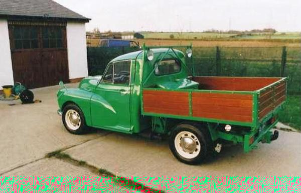

    No idea how popular Morris Minors are in the US, but there's lots of upgrades available for them that anyone who doesn't want to go down the separate ch***is etc route can fit.
    With some mild lowering, the torsion bar front suspension gives good handling, the rack and pinion steering is light and positive by comparison with other 50s cars. I rebuilt this '68 pickup 20 years ago with a 1275cc Morris motor and a 5 speed transmission, along with a power disc brake conversion, it drove nicely and could cruise at the UK motorway (highway) 70 MPH limit all day without any drama.
