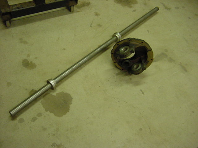

    Mandrels with the solid bar would be the best and accurate way to set up provided you had a press should you need one to straighten the housing? I wouldn't like to second guess something so critical with my eyes.

    ^^that's how its done, for Stumpy. The housing ends go on last, and they are lined up off the bearing journals in the 3rd member, NOT the axle tubes. I think the reason it looks so bad is because of the section of tubing they stuck in there, if the housing ends are welded into the ends of the original axle tubes, there can be considerable mis-alignment between the ends and the tubes, and you wont really even notice it with the naked eye. Functionally, what matters is if the housing ends are concentric with the bearing saddles in the 3rd member.
