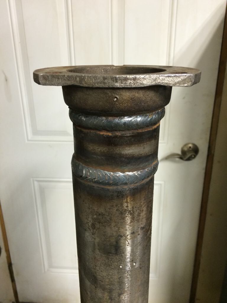

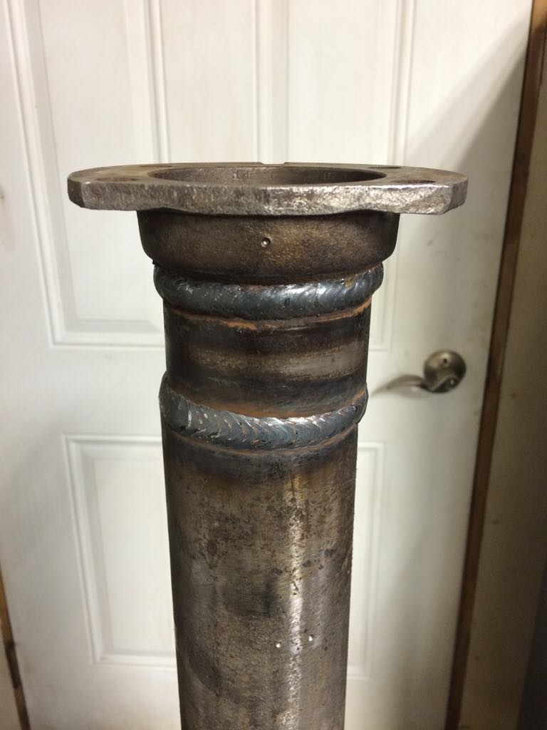

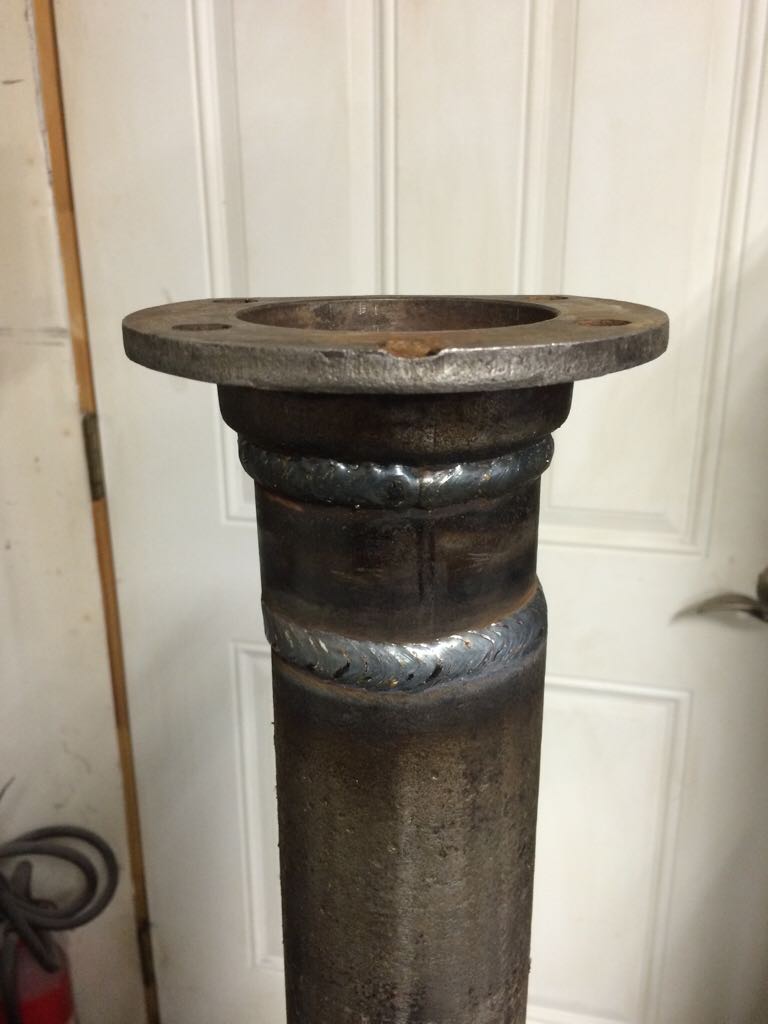

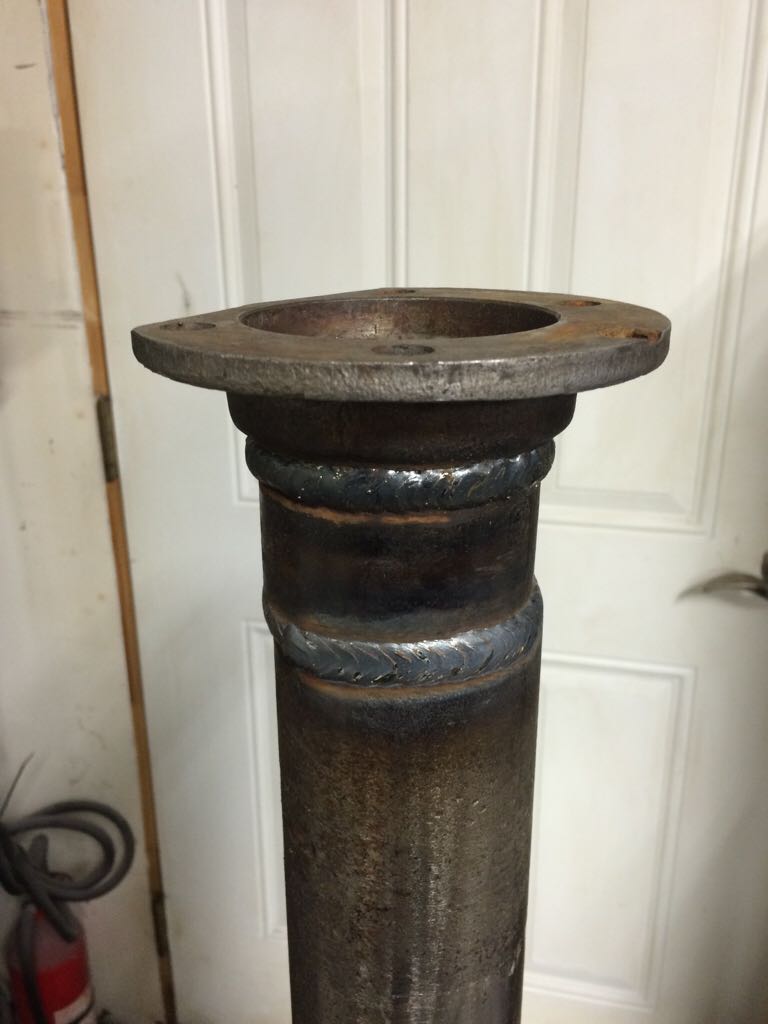

    That added on pice made me wonder if they lengthened one end instead of shortening the other.

    I would be bummed too. **** work. Will it work. Probably. Does it look like ****? Absolutely.

    If you read the (many) stories in Street Rodder (sorry) and such about how Currie builds rear ends they always emphasize that the final step before welding the housing ends in place is to straighten the housing. Obviously that policy does not apply at Moser. And if, in fact, they screwed up the original job and got the pinion off center they should have fixed it the right way rather than adding a chunk of tube.
    Most reputable shops should charge less than $100 to narrow a housing (using the original ends) and if you spent $650 for one new axle and one modified one (along with the housing mod) you got clipped. Brand new 28-31 spline street axles from Strange go for $405 a pair with bearings and studs.

    It's simply a **** job, even if it's mathematically square with the world. Sending that out as a "finished job" is not only a ding on their craftsmanship but on their (total lack of) shop pride. They must have thought this was destined for a fleet vehicle not a Hot Rod?
    If that was under a race car and an inspector spotted it, they'd probably start the inspection over with a finer screen.
    Great welds but a crooked housing is akin to a perfect $10,000 paint job where they didn't spend the prep time to set door gaps.

    At this point I'd s**** that housing, save the axles etc and just make a new rear. What we don't see is brackets, tabs etc welded to the tubes in your picture. That stuff needs to be welded on the tube first and the ends welded when all other work is done.

    And any bracketry is going to be located... guess where? Yup... right in the middle of that off-center short piece that is ****eyed by a 1/4".

    I've read about a couple of other complaints about Moser Engineering recently. Your axle "looks" pretty messed up, but it's probably concentric and straight, but if it is't, Moser needs to make it right. Try checking from one axle bearing end flange to the other using a lazer pointer; it's not the perfect way to check it, but it may be close.. I am Butch/56sedandelivery.

    Narrowed 100's of rear ends before reasonably priced new housings became available. If I'd have turned out a product like that I wouldn't have lasted long. I used a heavy wall DOM tube with mandrels in a center section and at the axle ends. Still use it to check rears when we weld on brackets.

    What baffles me is if they had welded the short piece to the housing and then the ends they could have gotten the short piece concentric with the long tube. If the ends are off it's much less noticeable. This looks more like a backyard job than a "professional" one. I know that when the old man died maybe 10-12 years back ( plane crash ? ) prices went up and quality down because the son wanted more profit.

    That's not the way to true it .... That right there is not my job ... **** it ..mentality
    If I remember right they narrow a housing for under 100$ so for that price time wouldn't have been allowed to straighten housing,
    BUT bussiness etiquette would be to call and inform customer and ask what route to take and notify extra time is needed to straighten and cost will be higher not just blast ends on like that...
    I would hate to see anything leave my shop looking like that ... Even if that's what customer wanted!

    Agree that housing most likely was bent or something similar to get tubing off sets of that extreme. What counts for function is the alignment of both axle bearing bores with carrier bearing bores of a bolted in (with gasket) 3rd member, using a line up bar and machined slugs. And if the housing is crooked with the tubes, then when the ends are welded on could be offset. A housing that has the line up bar and 3rd member with slugs in place would show the bar offset in the tube bores in such a case if so checked. and then it, by replacement or straightening, should be corrected before the ends are welded on.
    I think also another misnomer is in this thread, and that's the difference between the terms "pinion centered" and "differential housing centered". There's a difference, and it's more pronounced in a 9" Ford.

    I have been contacted by Moser asking me to clarify the situation regarding the work done, ironically not to resolve the issue . Unfortunately our interpretations of the facts are not the same.
    I originally sent the rearend to Moser asking for my axle housing to be narrowed to 56 inch axle face to axle face with the center section centered.
    Mike from Mosers was kind enough call me back and offer to use both axles I sent and have a slight offset, my understanding and perhaps it was inaccurate on my part was that this was approximately 3/8 of an inch.
    The work was done quickly and the housing returned . Upon inspection the center was visually off and off more than an inch. I called back and Mike was great, he offered to fix the problem, flopping the ends and adding the piece you see in the pictures.
    I want to make something very clear , I am not trying to defame Moser with the posts I've made.
