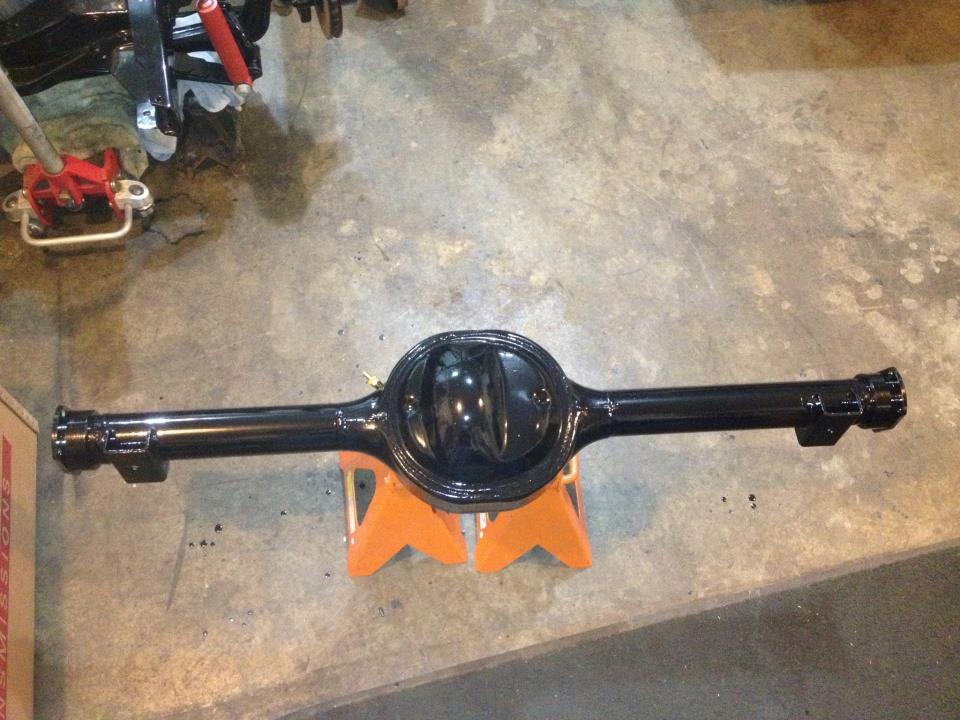

  11. rcnut223
    Joined: Oct 12, 2006
    Posts: 1,282
    rcnut223
    from wisconsin
    I was not contacted regarding the housing being bent
    ImageUploadedByH.A.M.B.1451775902.532295.jpg ImageUploadedByH.A.M.B.1451775941.512673.jpg ImageUploadedByH.A.M.B.1451775962.182589.jpg ImageUploadedByH.A.M.B.1451775982.982732.jpg
    Here are pictures of the housing when relieved back the first time .
    Note the measurements
  12. rcnut223
    Posts: 1,282
    rcnut223
    from wisconsin
    If contacted I certainly would have approved and paid to have it straightened
    This was not about being cheap, I wanted the look of the old rearend .

    It looks to me like they had it jigged up and saw the mismatch, but they just wanted to get it over with and finish the job. I think somebody didn't want to delay production in the shop, so they neglected to call you about the issue and just welded it up.:oops:

    Hmmm...according to your measurements of the original job they did, the housing WAS offset 3/8ths of an inch...just like they said it would be.
    Regardless, what is odd to me is that the original job doesn't appear to have the housing ends welded offset to compensate for a "bent" housing.
    Weird.

    Original repair was dead on everything was straight , if the difference side to side was not visible I would have left it
    To clarify the measurements are
    20 & 13/16 vs 19 & 9/16
    Difference of 1 & 3/16

    In the pics it looks like 20 3/4" and 19 15/16th...which I rounded off to 20".
    The measurements are a moot point anyway.
    Wow....I wouldn't let that housing out of my backyard for free looking like that...let alone charge for it.

    In my eyes, you would have to really work at getting those axle tubes to look that way.
