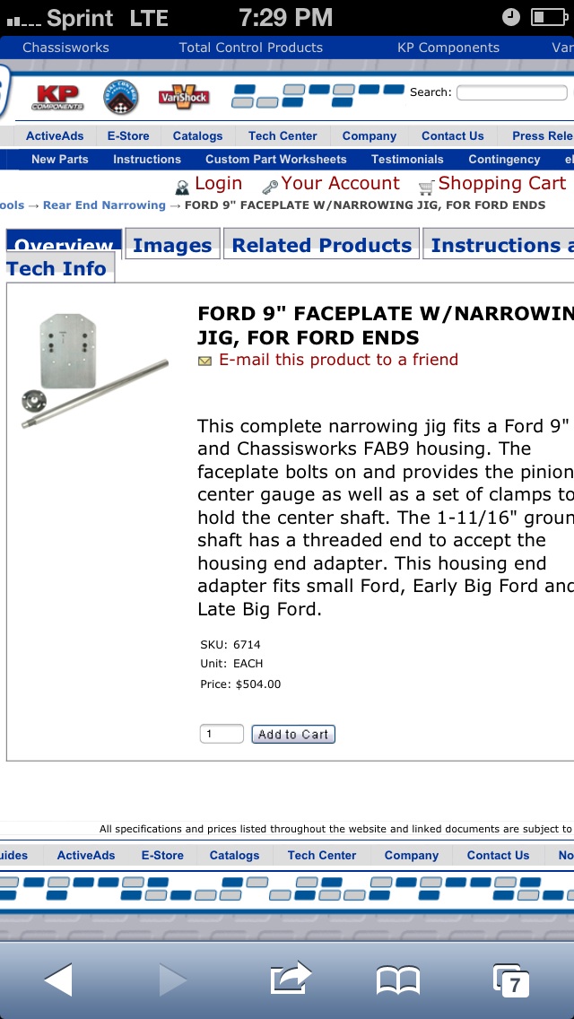

    The shop I work at now has one of these do-hickies and I think it's a piece of **** and I refuse to use it... I garentee you a rear done with this thing... isn't within .005 , I favor a bar full rearend width an old center section and 4 bushings

    I agree 100% on both counts, total POS, I wouldn't even consider using that. As to the factory ford tolerances versus the way I do it, I can only offer advice based on the tolerances I use when I build one for myself. I don't do it half-***ed just because its for someone else. Your mileage may vary...

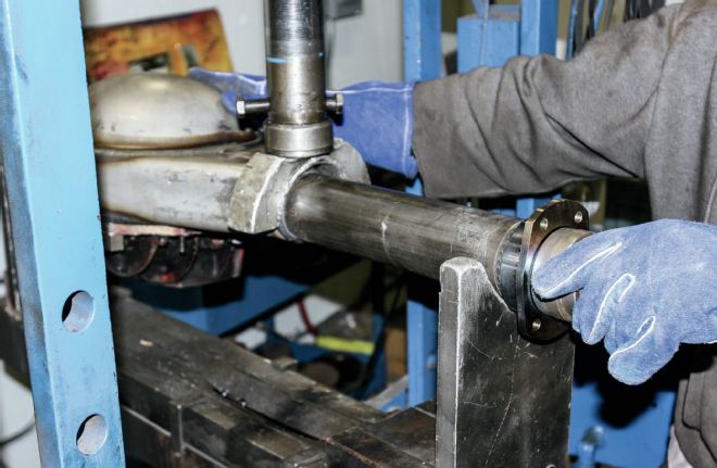

    As luck would have it I am narrowing a Dana 60 right now, I'm not ready to weld the ends on it yet but slid them on so you can see how an alignment bar works. The 1st you can see inside the case there are fixtures where the bearings go, the alignment bar (1.450" tool steel) is slide thru and the saddles torqued and the bar can be rotated, it isn't bound up. This is a very precise, machined fit - probably to the .005 mentioned earlier.
    The new housing ends are fastened inside another fixture and this is slid onto the alignment bar to weld to the axle tube. I just stuck them on for the picture, I am still working on the brackets and not ready to weld. the 2nd picture show the new ends and the fixture.
    The new ends are precisely aligned to the bearings in the carrier, the tubes are always a little wonky but when welded the ends are true to the carrier bearing and not true to the tubes. The ends are also the last to be welded to the tubes.
    The 3rd pic is shows getting the brackets positioned (I don't have a fixture for the Dana, I do have fixtures for 9" ford to hold the brackets where they need to go, and had to do a manual setup) but in the welder needed to weld these things properly, I am welding the Dana at about 350ish amps to get penetration. DSC00027.JPG DSC00030.JPG DSC00031.JPG
    kidcampbell71 and falcongeorge like this.
