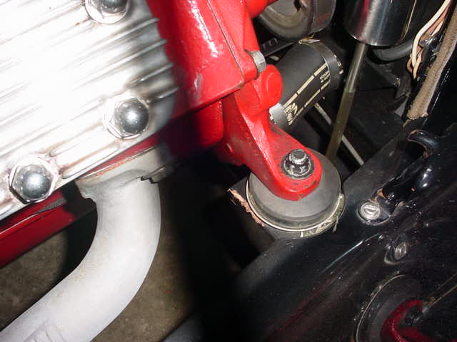

    Typically the motor mounts are set at the top of the frame rails with the rubber pad above that. That should line up well with the lower radiator hoses. You're using truck pumps so you're on the right track there. My opinion is that the motor should be somewhat paralell with the frame. The rear looks a little high to me but you may be able to loer it a bit when you fabricate the rear mount. Good luck, keep us posted. I'll take a picture of my '32 frame tonight if I can remember.

    You can see the elevation of my mount pad above. The same as DD discribed. I was able to get straight hoses to hook up. Not perfectly straight but very workable.
    Mine is an 8cm with the truck pumps.

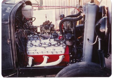

  11. a picture to show location of flathead engine mounted in 32 frame..HRP

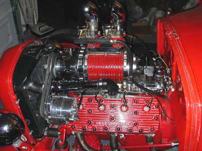

    Neal, here is my F-100 mock up. I made the headers but I think Reds Headers makes a set for this set up. I can't drill the holes and fab the wedge untill I get the body/dash in place.

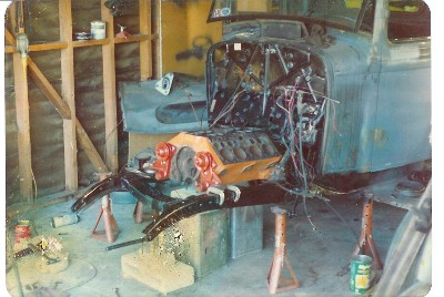

    here's how i set my up in '73
  29. cheap-n-dirty
