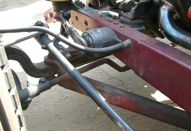

    Neal, yes, on kevs roadster the tie rod would bump and we had 2-1/4". We made a droped tie rod and solved the problem when you saw the car it didn't have the dropped rod.It would only hit on a bad bump, most of the time it was ok--TV [​IMG]

    TV - As you have probably seen, it's not a real rpu, just a cut off. I hope it turns out convincing enough. There will be alot of metal work involved though.
    Now on the tierod...How much of a drop did you put in it? Any problems with adjusting toe-in?
    I was looking at this pic of Keith Weesner's Model A. The drop in the tierod will take care of it hitting the frame going straight, but not if you were in a hard turn, but I guess that would be a rare case.
    Neal

    do you need to drop the tierod? after all as long as it clears the A bar on full lock both directions your home free. As its a solid unit and cant ever hit the A bar.
    As for the chassis, just heat and bend your spindles so that the clearance at the draglink is a 1/2" above the A bar and that should give you clearance.

    The tie rod on my sport coupe is dropped like the one in the picture for the same reason...Hurst motor mount on the Chevy motor. When I put it on the flatty frame it wasn't necessary. I used it anyway.
    Get the tie rod as close to the wishbone as you can. The drivers side has chipped the paint, the pass is untouched. (lard ass driver) I could have gotten it closer to the wishbone. I started the drop with the oposite wheel on its stop. The drop will still be close to the outside of the frame.
    If you want to be different, set the tie rod up on the center of the wishbone. Put a heavy oval tube into the wishbone for the tie rod to pass through. I've seen it done but, I think those bones were split. Shouldn't make any difference they both move together.

    [ QUOTE ]
    [/ QUOTE ]
    I've seen it done too. Plan to do it on my coupe. Here's a picture!
