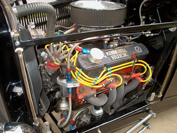

    Another "sleeper" motor is the 350 Buick...lighter than even a small block Ford and 350 cubes! It has a funky bore to stroke ratio (almost square), and performance parts aren't easy to come by...but they run pretty strong in stock form with a factory intake, four barrel carb, headers and a mild cam. Kenne Belle and Poston make specialized parts for them for those who want to take the flyweight V8 even further! A mid 70s Buick Century with a 350 should only set you back about $300 for a rusty runner!
