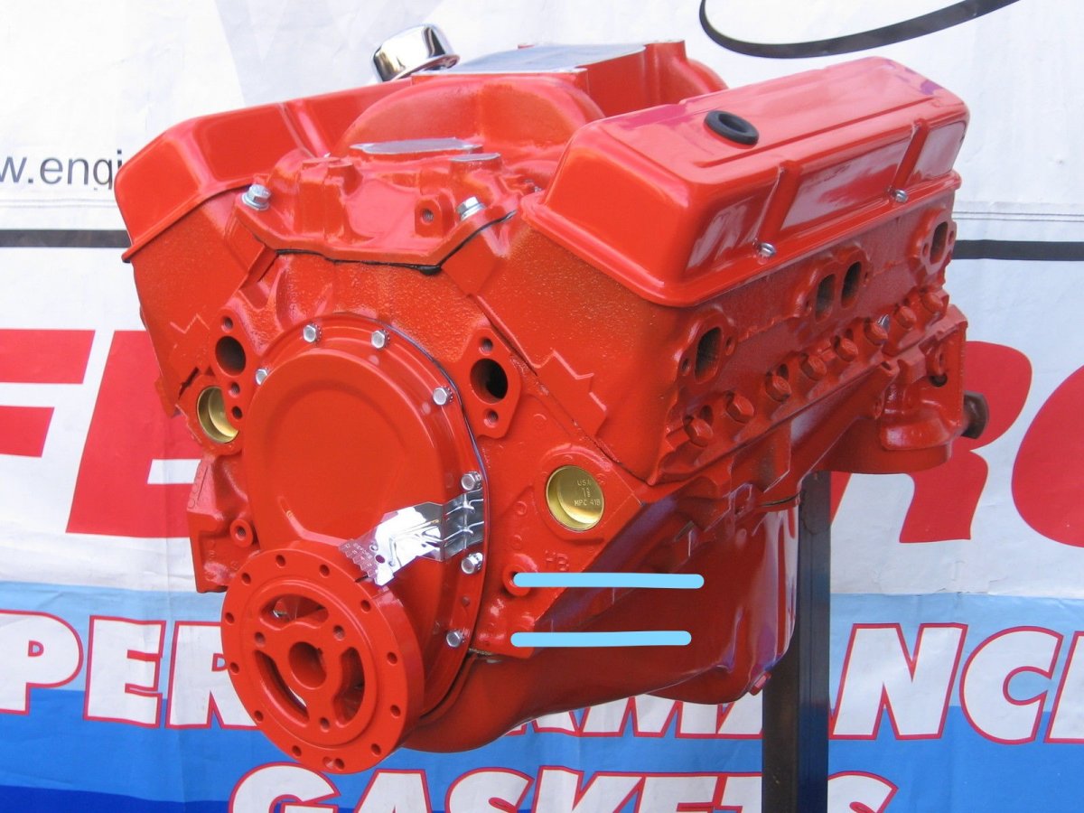

    Does anyone make an engine mount for the 283 that utilizes these holes (indicated in picture) in the front of the block.

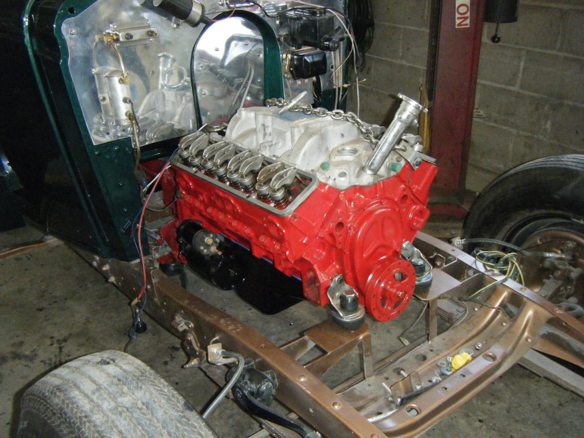

    55 to 57 Chevy with a 265 or 283 used those "L" mounts that @dana barlow mentioned. other wise you can use the old Hurst type front mount.

  5. Would be easy enough to fabricate .Use the large rubber flathead round cushions,and weld flat tabs on the frame.I read once that the Hurst type can have clearance problems with some fuel pumps so double check before going that route.

    Look into the 50s v8 vettes front motor mount. It used the front holes on the motor and was one piece ran from one side of the frame to the other. Great for eng swaps

    The Corvette mount will work but looks a bit ungainly compared to the other options, and because it mounts so high on the block it needs tall frame risers for the rubber insulators.
