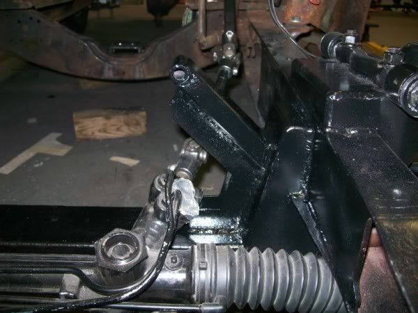

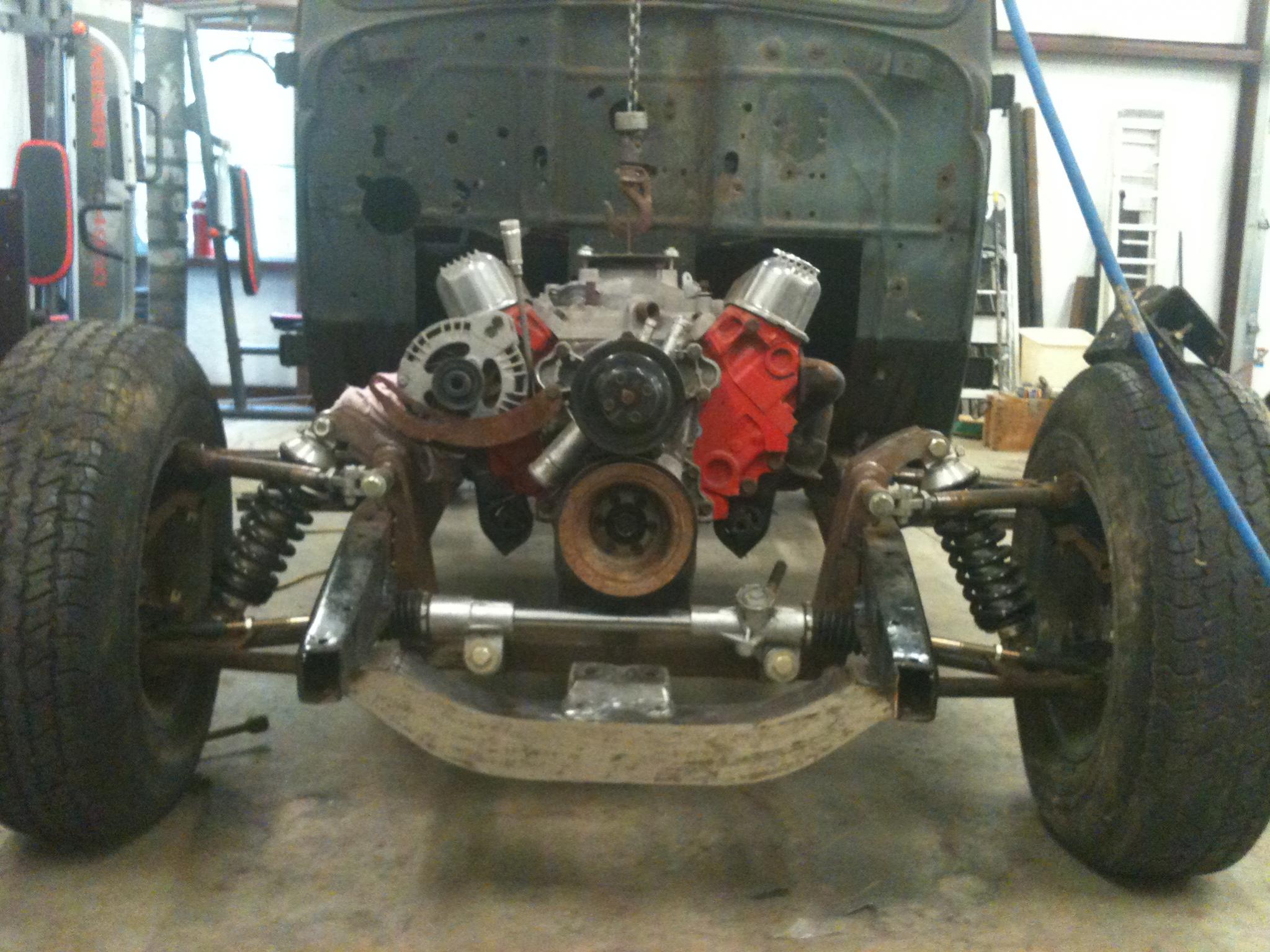

    Hey guys, Im building a 46 Dodge truck with a 360/727. I put an IFS under the front with a rack and pinion.
    From what I know, its best to have the engine/trans as low as possible as long as it does not cause any ground clearance issues and the drive shaft is within a couple degrees of the rear end yoke. Correct?
    So, with that in mind, if you look at the pictures you will see my issue. If I mount the engine in the position shown in the pictures, the drivers side engine mount will be in the way of the steering shaft for the rack.
    In my mind I have a few options here.
    I could change the type of engine mounts from the "spool" type to the "pancake" type (not sure if that would help at all.
    I could build my drivers side mount with a hole for the steering shaft to pass through.
    I could make solid mounts to the front of the engine block mounting pads, then the steering would pass under it with little or no issue.
    I could raise the engine up higher so the shaft would pass under the fabricated mounts.
    Solid mounts or try to use some stock type rubber insert style mounts?
    What do ya'll think?
    Oh, and also, the engine mounts are directly over top of the IFS cross member. Should I just build the mounts to weld to the cross member or should I build them and weld them to the frame?
    Thanks guys.

    can you build a cradle that welds to the underside and inside of the frame goes under the engine to the other side of the frame with motor mounts coming off of it? like a K member?
    You engine seems to sit pretty far back compared to the norm.

    I could build a K frame for it. But I would think there is a better way, just not sure yet which way is better.
    The engine is set back quite a bit, and I CAN bring it forward. If I bring it forward, it will have to move up about 4". Its set back like that for a couple reasons, clearance between the radiator and water pump pulley, clearance between the oil pan and IFS cross member. I can change to a rear sump oil pan if needed and then bring the engine forward.
    Hmmm.... maybe thats the best idea.... back to the shop to measure and eyeball some more.

    Thanks for the advice, pictures and comments. I like that mount you made for that Shivvey motor. Looks simple enough and effective.
    I have some similar to the ones on that Hemi, maybe I'll bolt them on the engine and see how that looks. Might work out better.
    I just hooked the torqueflite up to the engine and slid it all in there as a unit. Turns out, I am going to have to take the "car" oil pan off and put an aftermarket rear sump pan or a rear sump "truck" oil pan on it. I'll try it with a truck oil pan tomorrow evening and see what happens.
    I will have to keep it pretty low in the chassis, pretty close to how its sitting in the pictures so that the tail shaft on the transmission will line up with the rear end and not have any crazy angles. There is also a cross member that goes over the top of the trans tail shaft. Its located under the cab about 10" from the back of the transmission. I could remove or modify it, but if I can make it work, why change it.
    The good news is, with it sitting so low in the chassis, I could put a blower on the dang thing and still keep the entire engine under the hood. Anyone have a small block Mopar blower manifold they wanna donate. ;-) Dont I wish.
    Also, it appears that if I line up the "spool" type mounts centered directly over the IFS crossmember it will all work out just fine. The crossmember is 4" wide as are the spool mounts. The only modification I'll have to make is to the radiator. I'll have to move it deeper into the nose piece or have a custom radiator made. If the original will hold water I'll give it a shot.
    Any more ideas guys? Nothing is set in stone yet thats for sure. This is my first 40's vehicle and my first MAJOR build. I have always been a muscle car guy. Figured I'd try my hand with a hot rod truck once. Im diggin it.

    How about something like this? You'd have to fab them, but it may be a solution.
  9. LMopar69
    Joined: Oct 2, 2010
    Posts: 60
    LMopar69
    That looks similar to the plan I have in mind right now.
    With the Mopar "spool" type mounts being 4" wide and the IFS crossmember being 4" wide, I think I can sandwich the crossmember with two pieces of 1/4" flat steel, brace them up a bit drill a single hole through and put a bolt in.
    I just gotta get the oil pan swapped out tonight and try again to get everything lined up. Should end up looking similar to what you just posted there 52pickup.
    Im probably going to have to modify the original crossmember under the cab by the trans tail shaft so I can raise the back of the transmission up a couple more inches. Or, I'll remove it and make a new one. The current one goes over the top of the tail shaft. I will probably have to make one that goes under it. Sure would make the trans mount easier that way.
    Laine.
