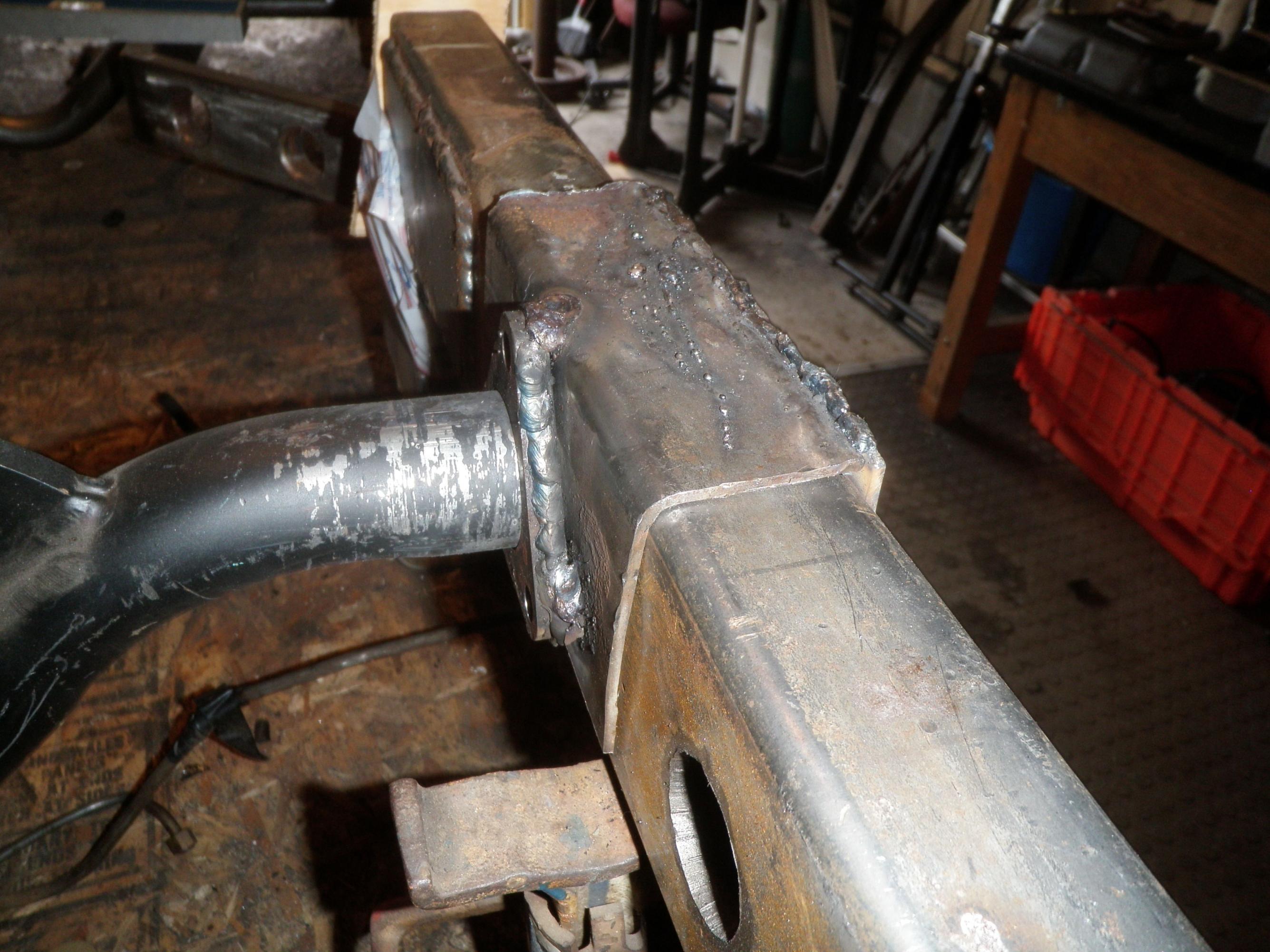

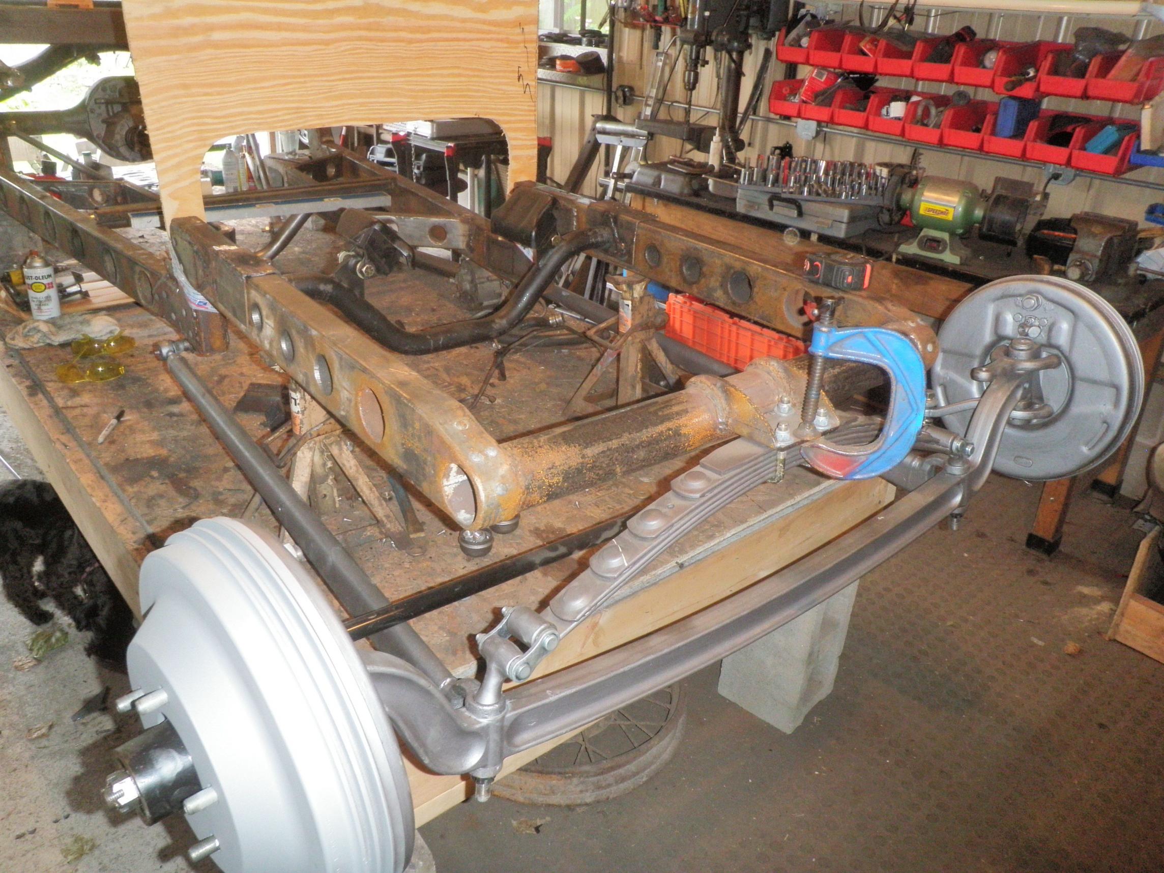

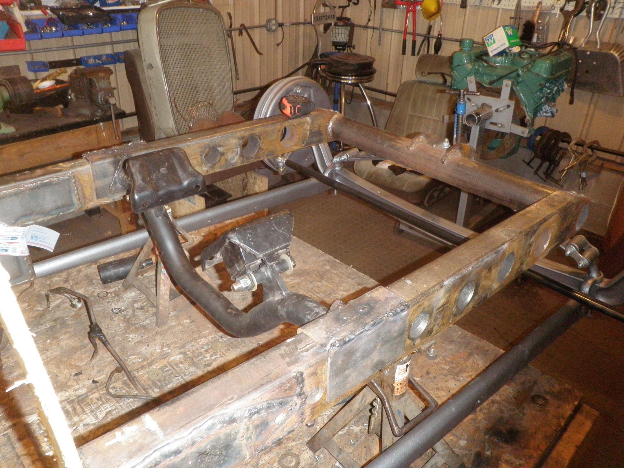

  2. The crossmember worked out well..I added on each end of the crossmember a couple of half ass bracket that fit over the frame..these were made so I could slide the engine along the frame rail when it was mounted into the crossmember mounts. Once the engine was into postion I marked the location... then I jacked the engine out of the way and took of the sliding brackets off....see pics below..
