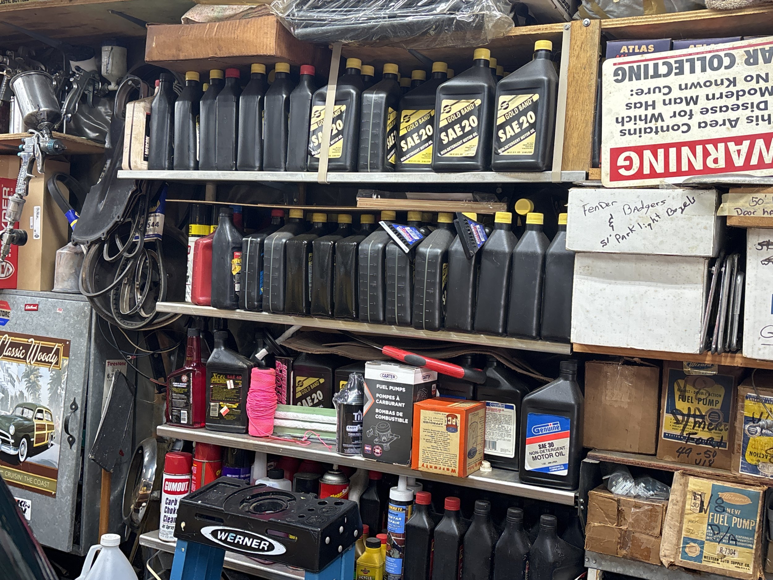

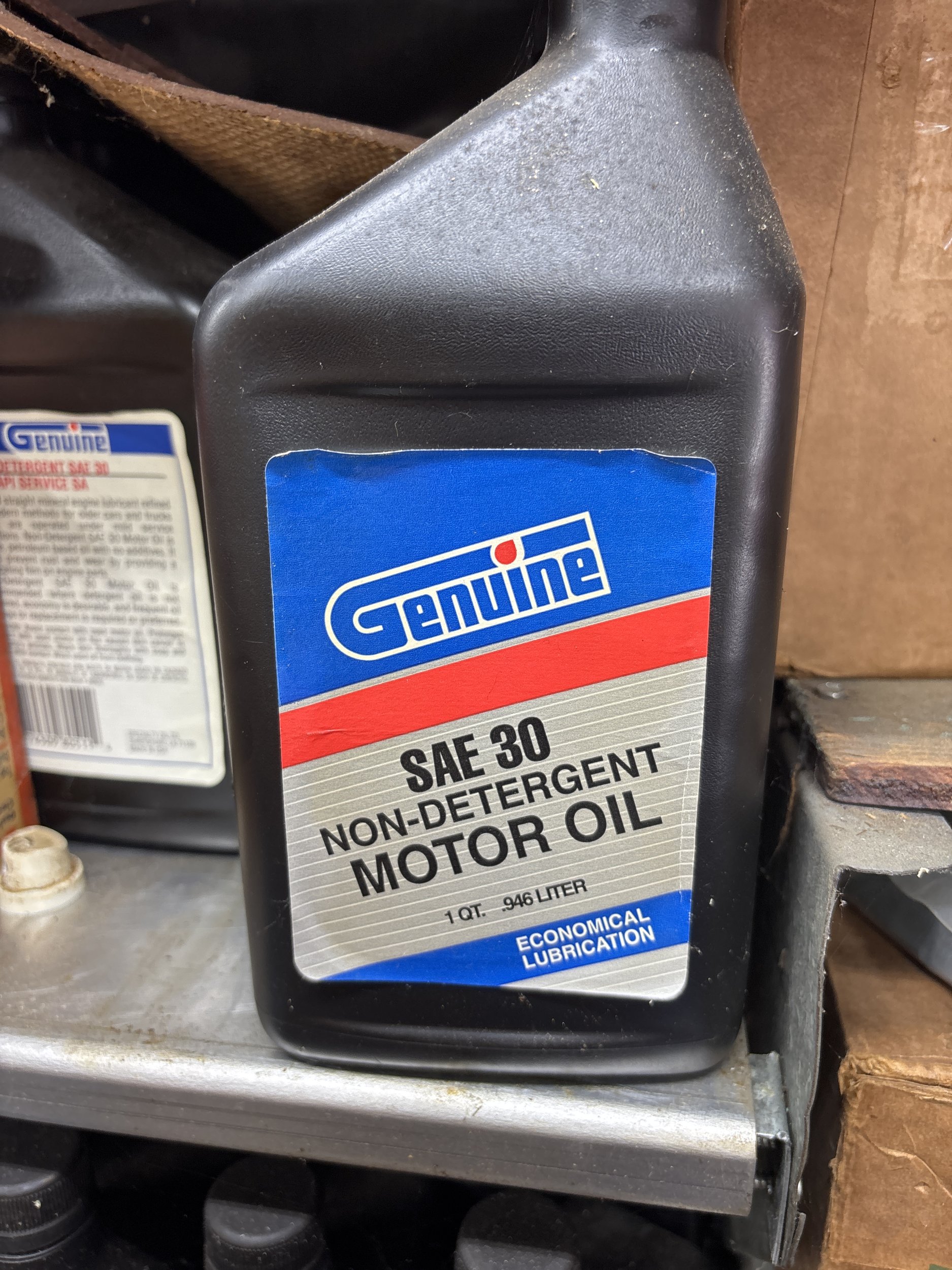

    Okay since I like rubbing salt into a good wound for kicks and giggles and I want to get a good laugh out of @anthonymyrick here is the oil that I use in my flathead. If I remember correctly my dad bought cases upon cases of this stuff on close out for like .25 a quart at our local grocery store 30 something years ago. Now my ex wife would say that the honey out of a teddy bear bottle tastes better than out of a regular bottle so does that apply to oil? Just like my boy Anthony says “oil is oil just run it”:D
