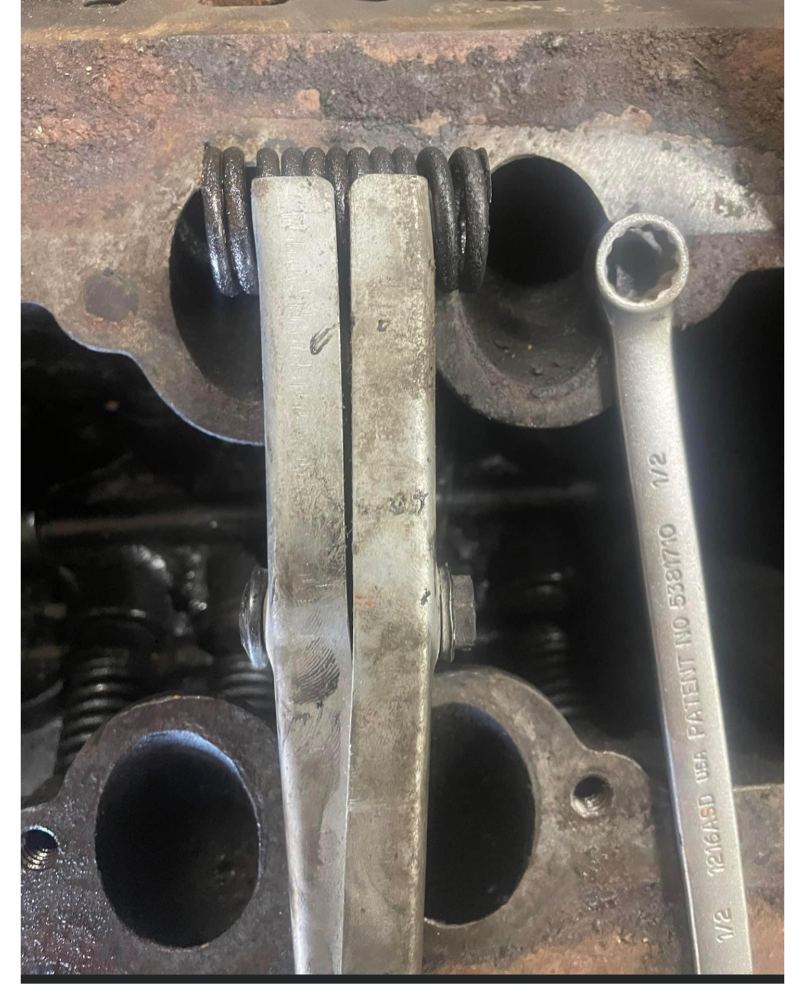

    Thanks for the info. I watched all the vids on removing valve springs on YouTube, it looked real easy. E
    ven with a flathead valve spring tool I had a helluva time. A big screwdriver got the job done, but I'm wondering if that stiff spring had anything to do with the broken valve. Or somebody tried to race the car? (It has a bit of a lopey cam and dual carbs.) Hope my cam lobes don't wear because of the stiff springs.

  10. I used a gm door spring removal tool on a FH once
