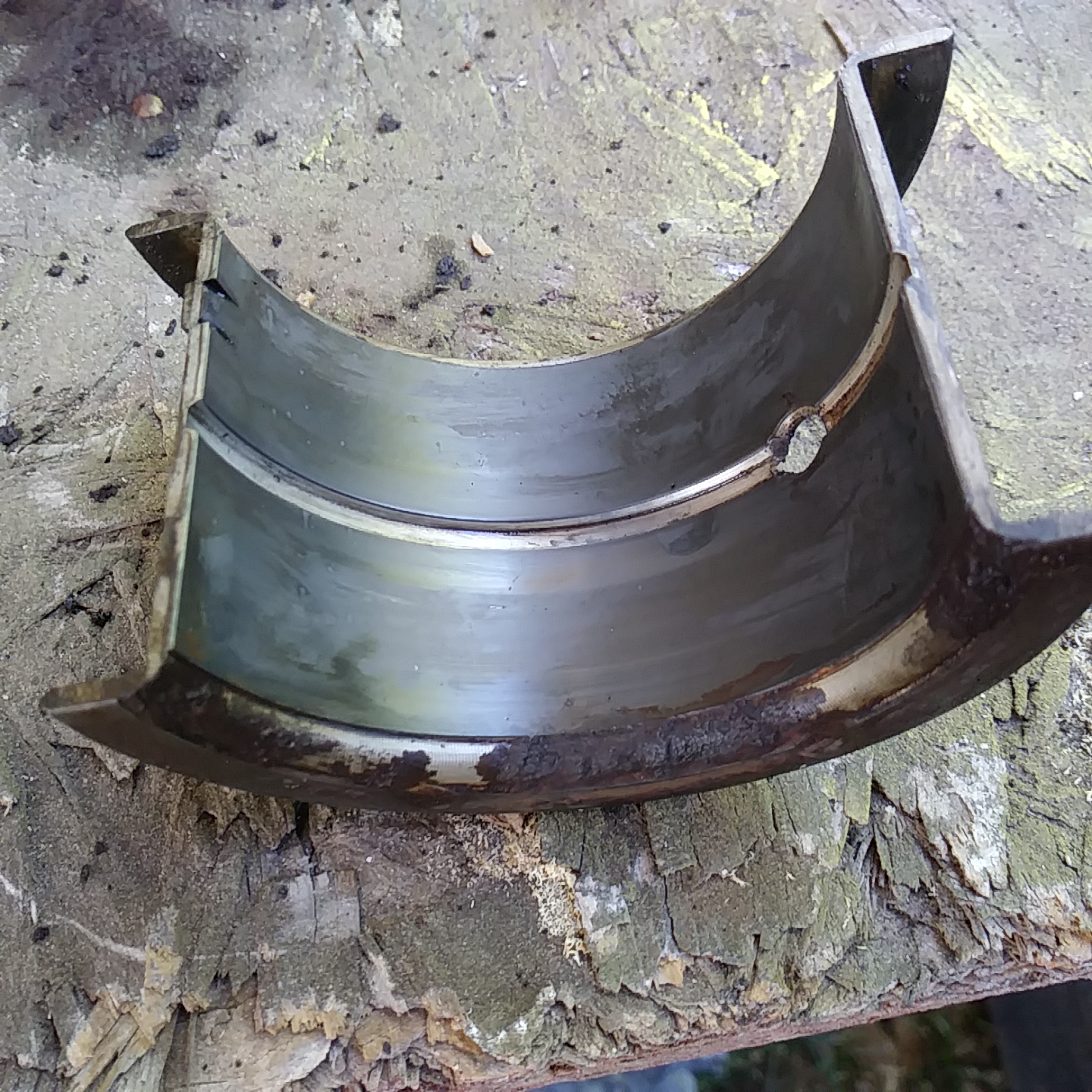

    The mouse piss did some damage on mine. It got down into the rear main bearing & had the bottom end locked up. The crank shows a little discoloring on it .... I just wiped it down for now.
    All the bearings, rings, pistons ... look great, just the 1 bearing is damaged.
    I was only inspecting it as I saved it from the s**** pile, curious what I had and where I was going to store it ... I have no use for it at this time.
    I still have the valve train installed & it is locked up from 3 frozen lifters. From the piss.
    I think it will be a pretty simple engine to get running when the time comes.
    That piss will get everywhere .... I ***ume the longer it sits the worse it gets.
    Because I'm not a mechanic with all the special tools, I would want the machine shop to install the cam bearings for me after the block is hot tanked.
