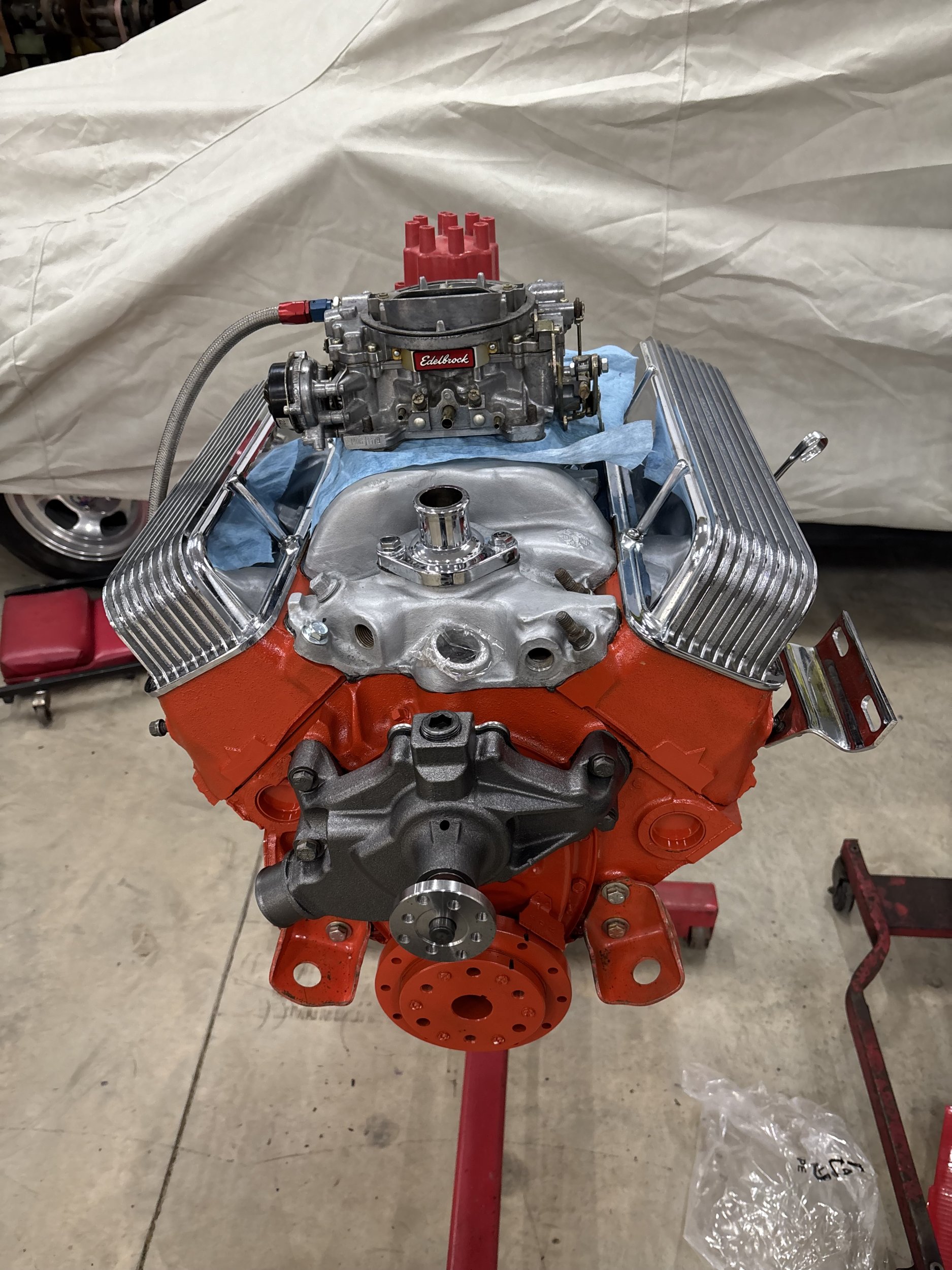

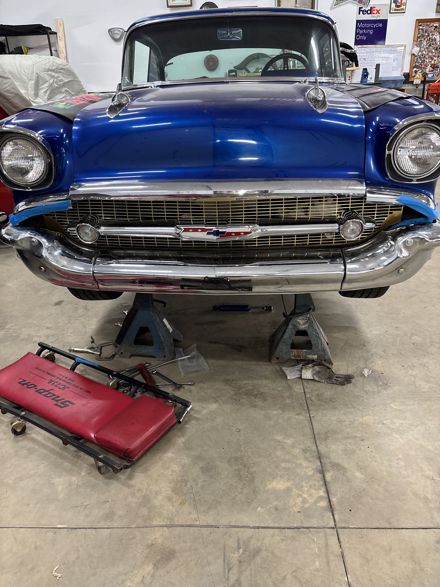

    Just got motor back 283 bored 30 over. One sleeve,10/10 on crank. 302 intake with eddy carb. I think 650 Needing clutch. What’s a good all around clutch. Not racing. New intake bolts ordered too. Lol
