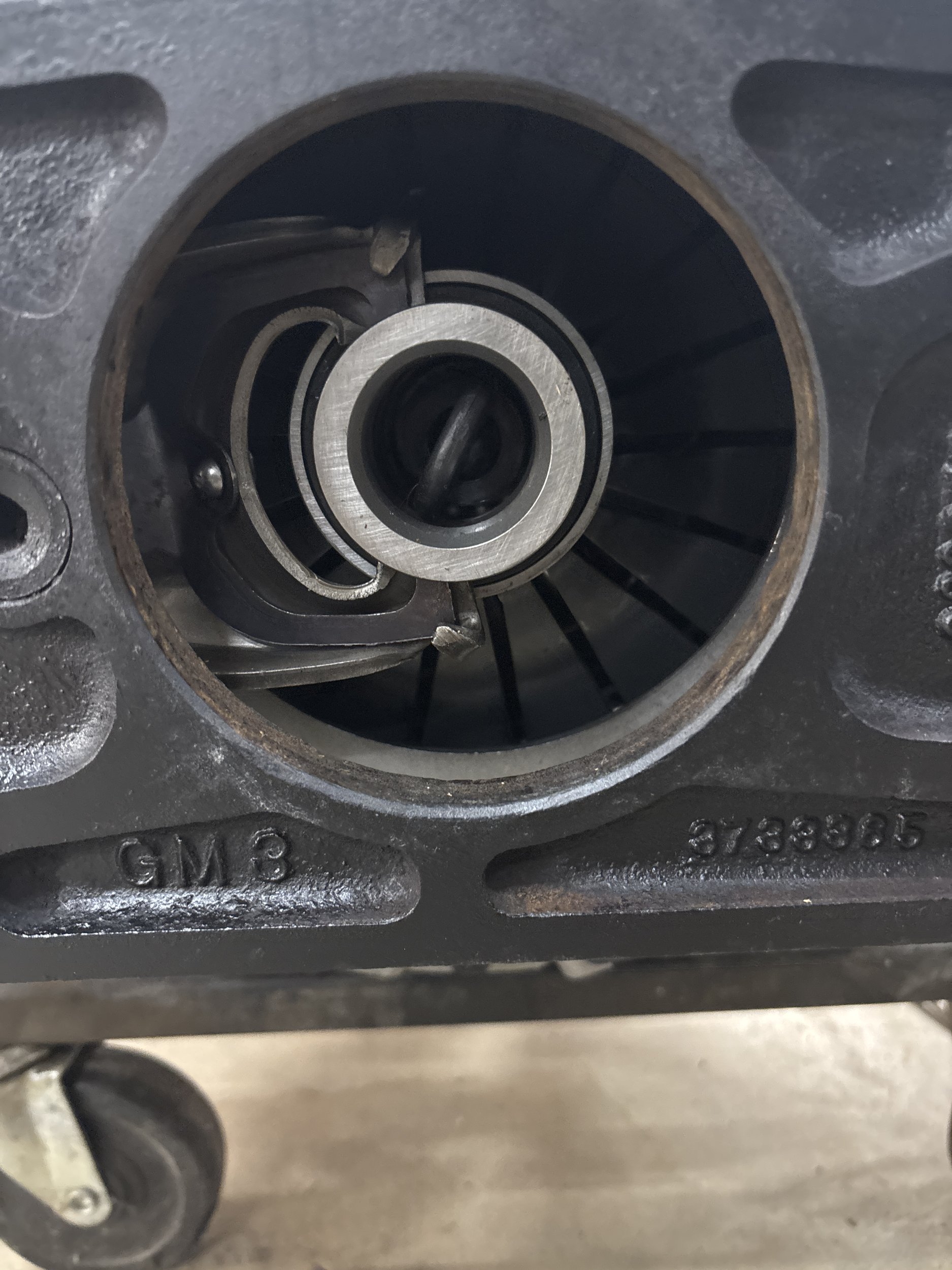

  9. Huckster59
    Joined: Aug 21, 2008
    Posts: 577
    Huckster59
    look right? image.jpg i thought it would grip it more but that’s with the ball set

  10. patsurf
    Joined: Jan 18, 2018
    Posts: 3,404
    patsurf
    shove a pilot shaft in next!

  12. SS327
    Joined: Sep 11, 2017
    Posts: 4,531
    SS327
    Don’t forget to take out the clutch alignment tool first. Then just stuff the trans in and see how it all fits together. Than take it from there.
