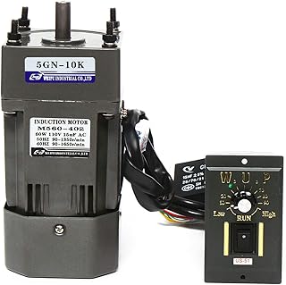

  15. gatz
    Joined: Jun 2, 2011
    Posts: 2,316
    gatz
    another choice of drive motor
    Amazon
    110V 60W Ac Gear Motor Electric Single-phase Motor Gear Motor Electric Variable Speed Adjustable Controller Governor Geared Motor and Adjustable Speed Controller Combo Rated Speed 0-135 RPM
    fiftyv8 and fauj like this.

  18. Mr48chev
    Joined: Dec 28, 2007
    Posts: 36,251
    Mr48chev
    This is a good and timely for me at least thread.
    The Amazon link is 110V 60W Ac Gear Motor Electric Single-phase Motor Gear Motor Electric Variable Speed Adjustable Controller Governor Geared Motor and Adjustable Speed Controller Combo Rated Speed 0-135 RPM - - Amazon.com
    They actually show several similar motor setups on that link. I'd have to quiz my brother on what wattage would be best for something like that.
    I've got an Eastwood Bead roller I'd like to do the same thing with.
    I'd agree on the foot control though.
