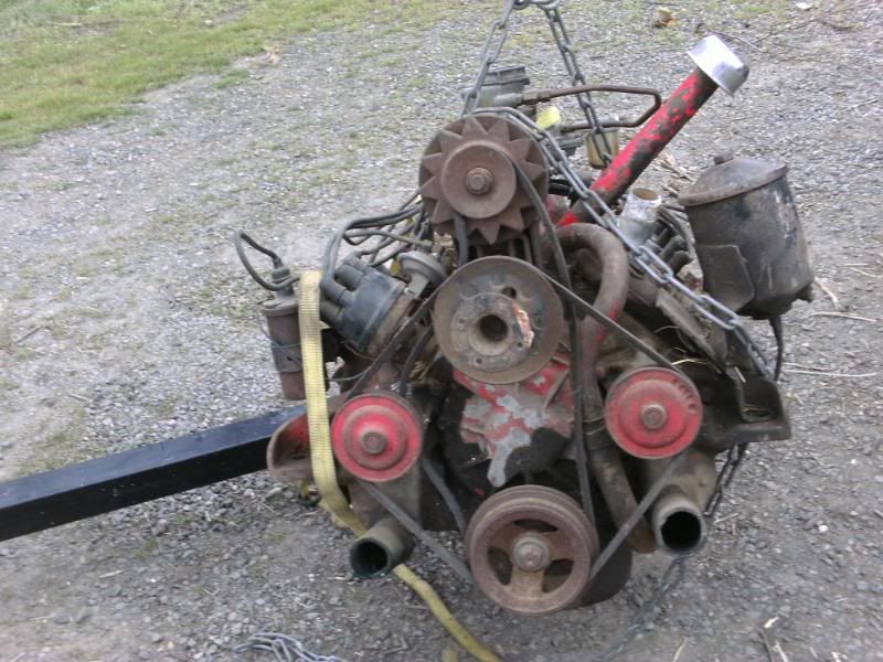

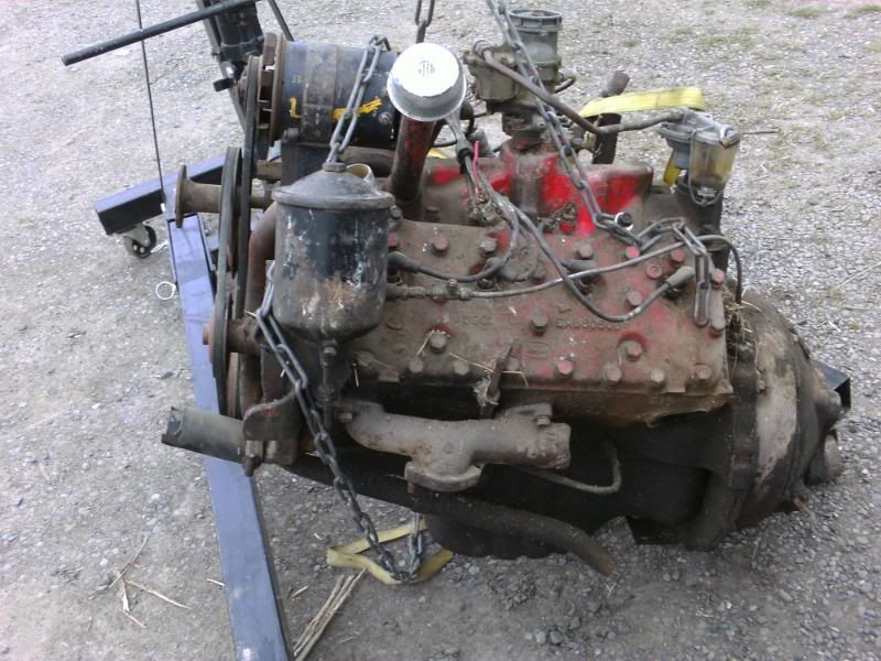

    It might sit too low for your application but my 8BA came with a fan that mounts on it's own bracket below the generator.
    Not the best side shot but it shows where it sits. And yuppers the Exhaust manifold is a mess because they had it in a Jeep wagon.

    Yeah, PowerGen doesn't recommend putting a fan on their alternators, but guys do it. If you want to use a fan on your PowerGen, I'll sell you the pulley you need for half price. Speedway gets $70.
    I was going to run it on my PowerGen, but wound up going a different direction--specifically, a remote fan like shown above in Mr48chev's post.
