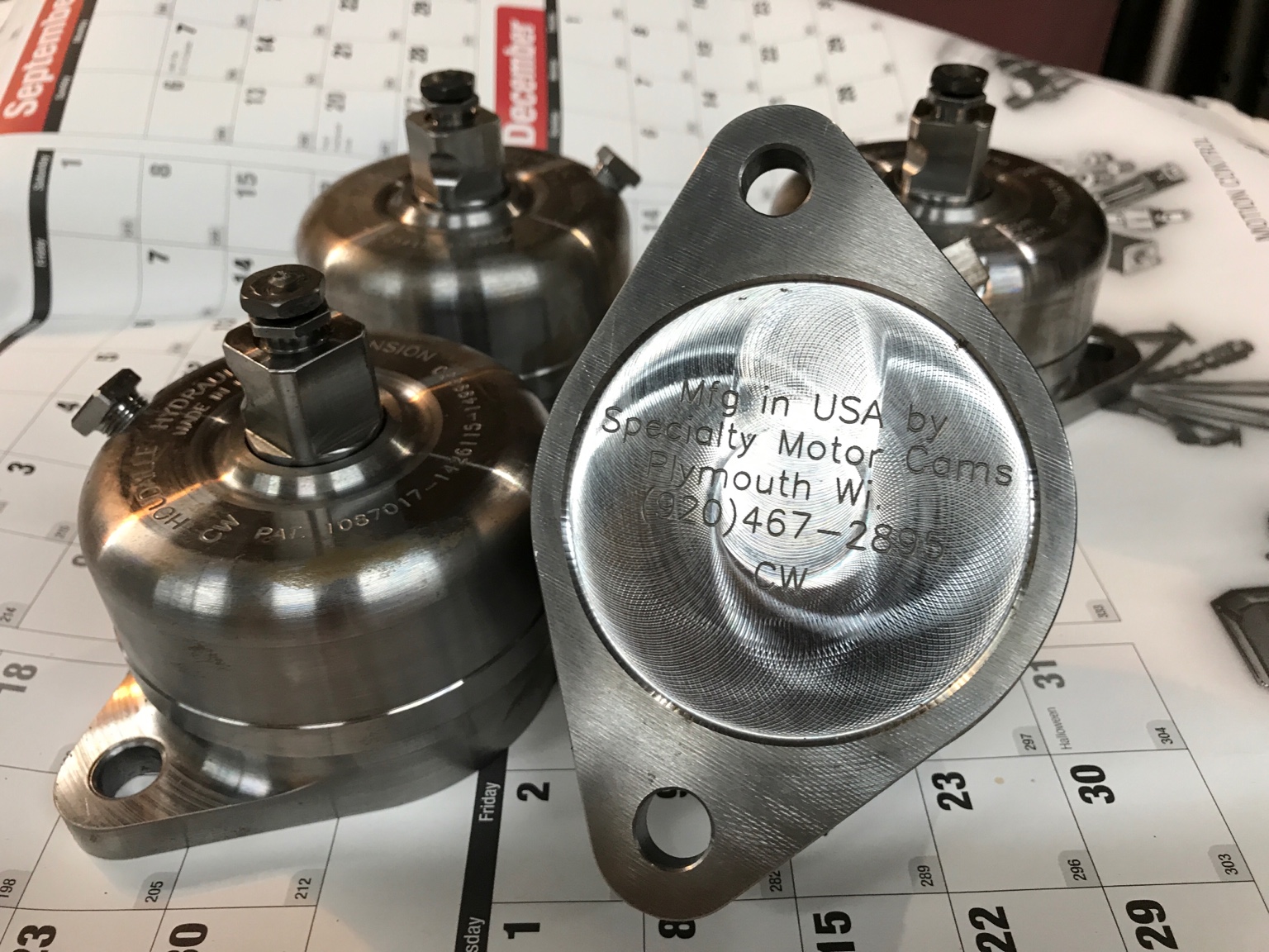

    I got my new killer Stipe shocks in the other
    [​IMG][​IMG]

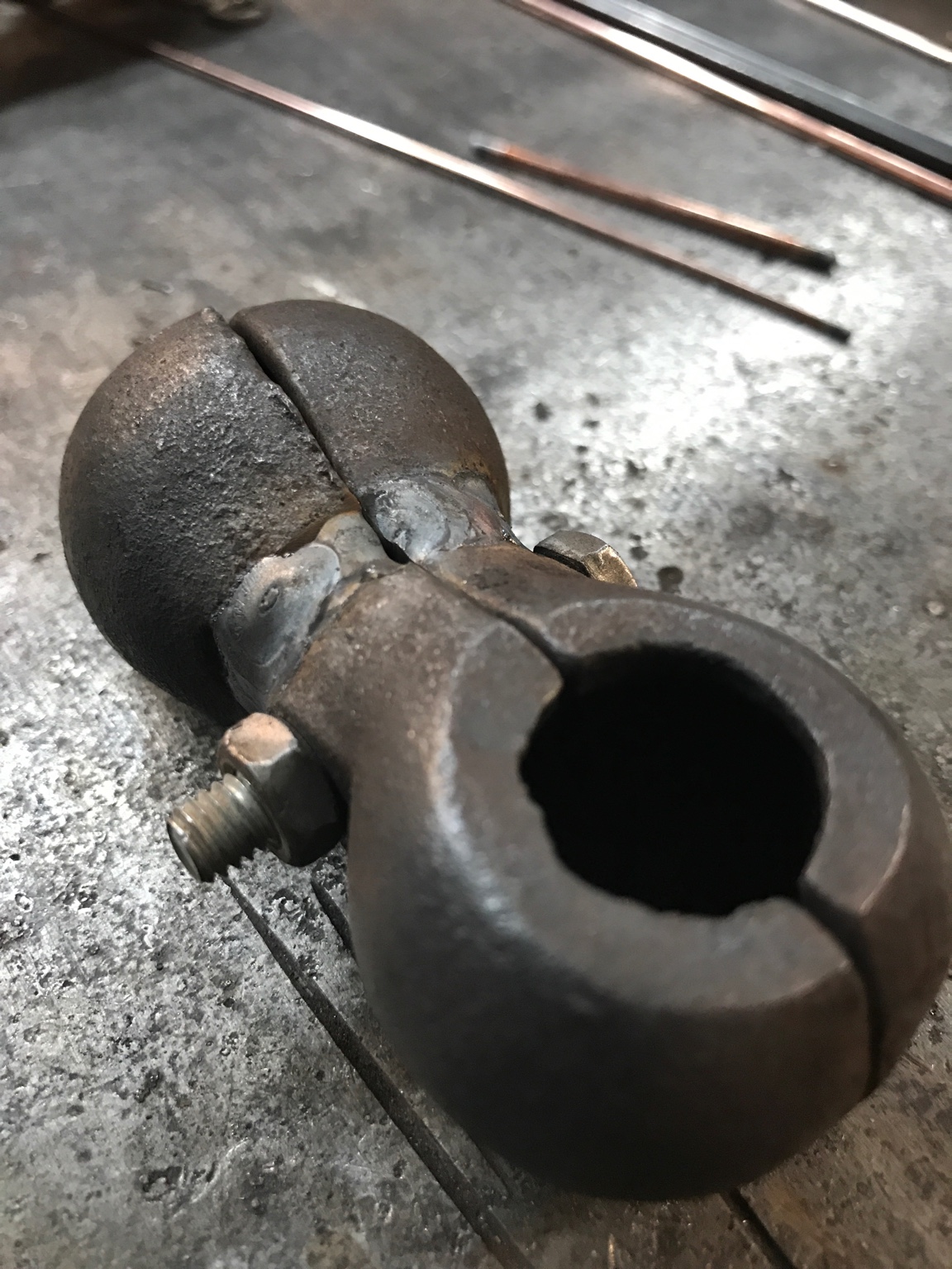

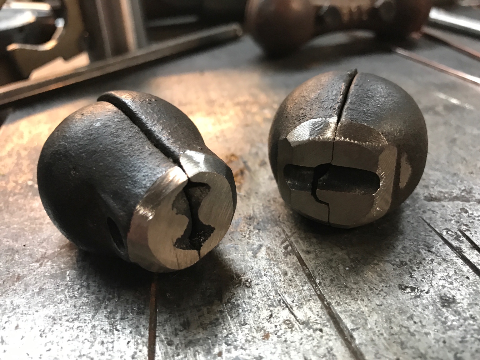

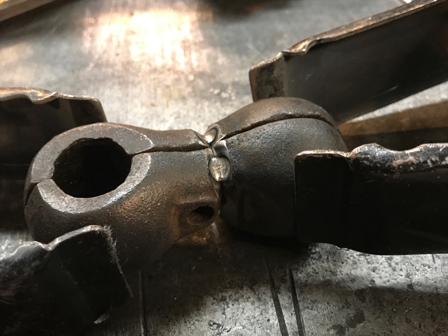

    I junked the stock dogbone mount for these 2 pcs ones [​IMG]
    They are 1/2" shorter then the model A but still too long
    [​IMG][​IMG]
    I cut them leaving room for one bolt.
    Tacked them back together
    [​IMG][​IMG][​IMG]
    All welded up
    Almost like Henry did it him self
    Hope this helps
  2. Excellent solution. Those shocks are beautiful. They almost look like they belong on the coffee table instead of the car. Stepping up and paying a fair price for a quality product sure tells the suppliers that there is a market for quality. I bought a set for my '31 RDPU.

    WOW. Price? Link? Are they adjustable at all? Thanx, Gary

    Call Tony his number is on the back
    (Tell him I sent You )
    Or call me Bill at WAC Customs and I can hook you up 86o 459 o399
