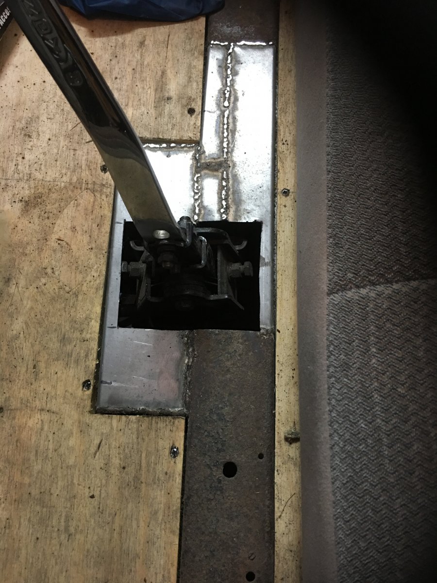

  7. IMG_0232.JPG This is just a rough in but it's an idea
