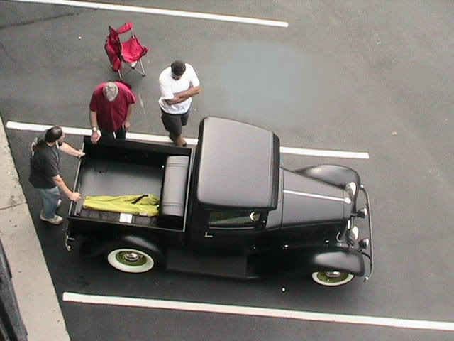

    I ran out of room on my 32 pickup and mounted the battery in the trunk that was in the bed. HRP

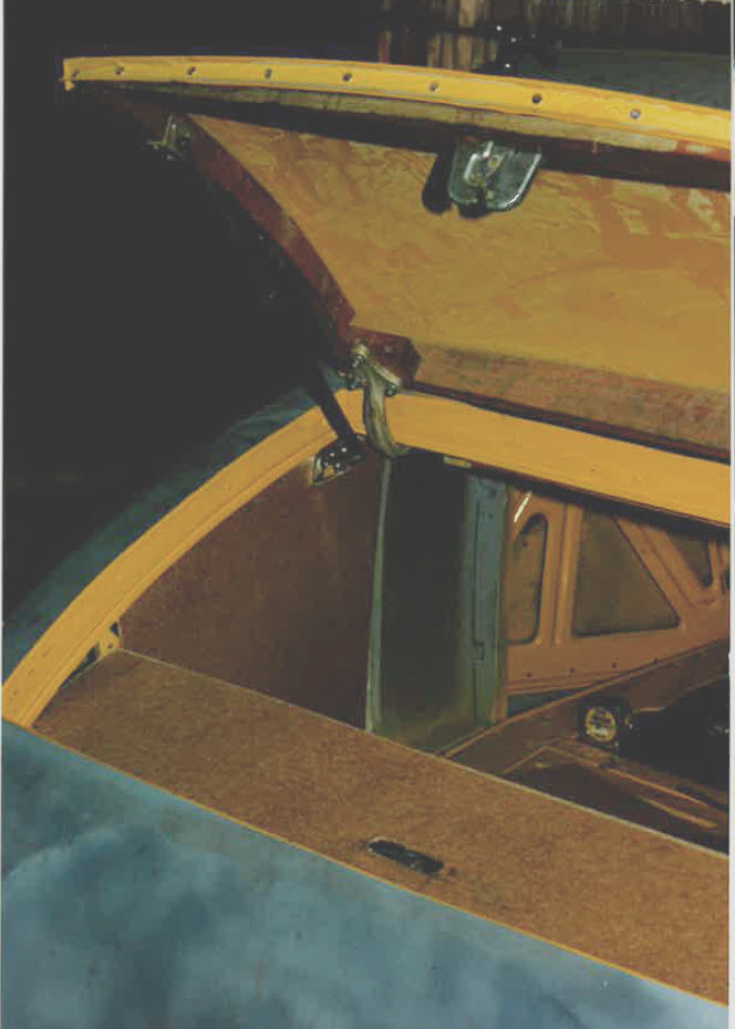

    Hey HRP good question and a lot of great answers so far. That was somewhat of a dilemma for me because I installed the TCI master cylinder where the factory location was. I decided in the trunk as I had a lot of welder cable stored from my days as a fitter welder in the steel fab world. I have the battery in a ventilated/modified plastic battery box. The cable is run from the starter back a short way on the frame and just past the door jam, through a hole to the inside and back to the trunk and then into the trunk. This was a fun fab and it worked out great.

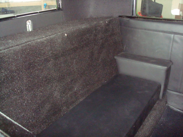

    In my '36 Willys, the battery is in a metal frame covered by an upholstered box in the tail of the 'trunk'. You can see the top of the box I built to cover the battery, AC evaporator and tool box. I ran 01 welding cable to the starter. that cable is extremely flexible, solid copper and very weather resistant. great application. the interior of my car is one big carpeted and upholstered space from the tail to the firewall, which n a Willys, isn't that big a space! Only division is the bucket seats.
