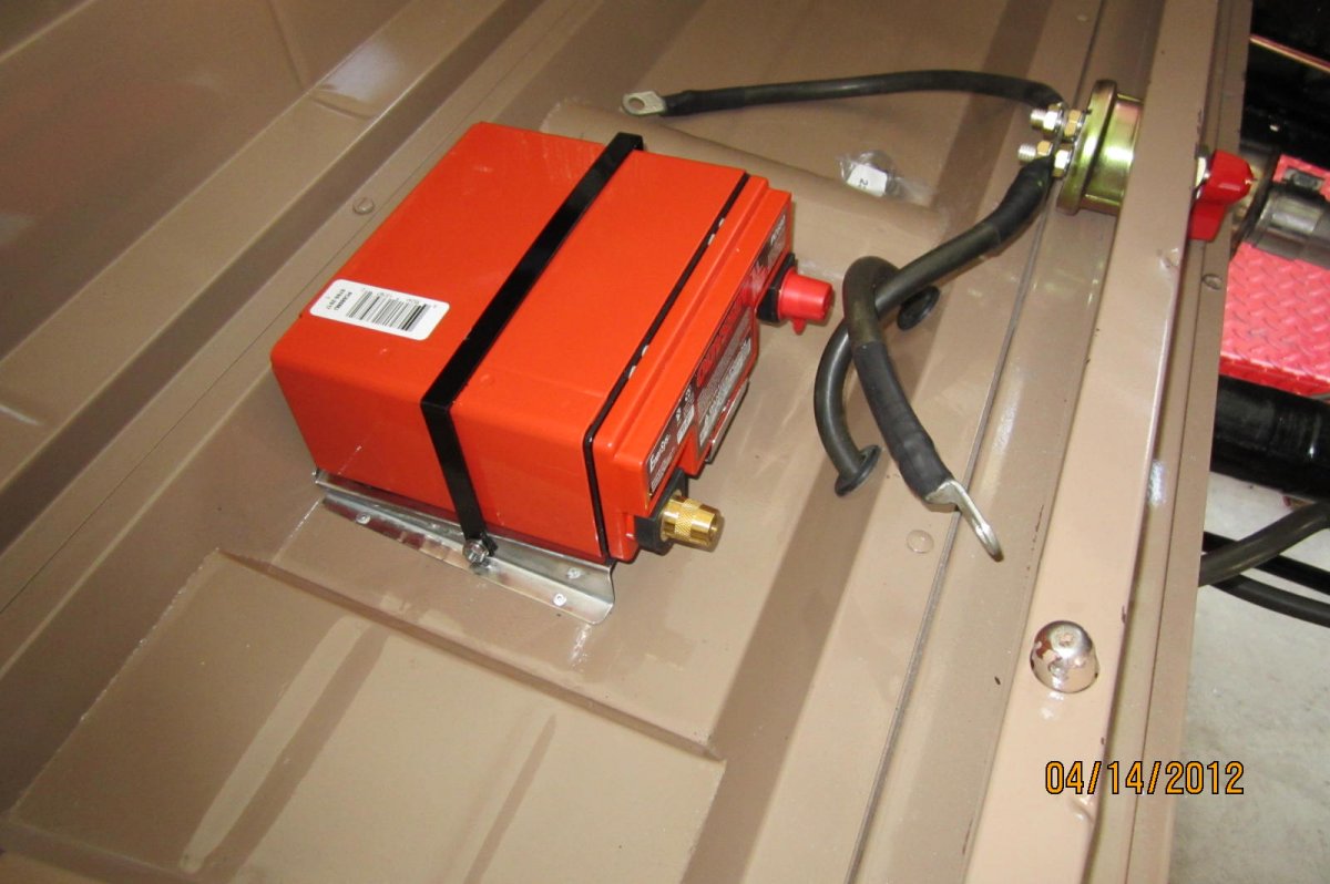

    Odyssey PC925 AGM under the p***enger floor of the '31 coupe.

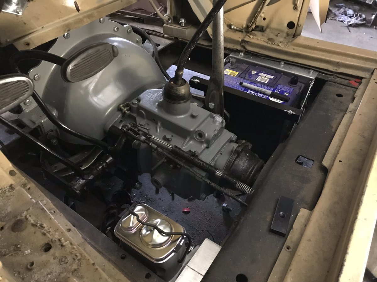

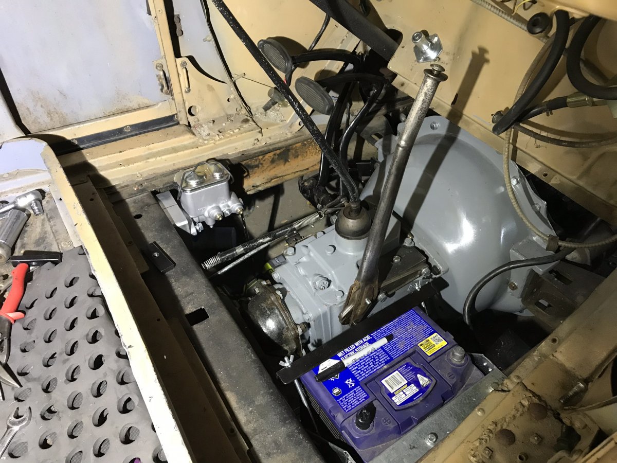

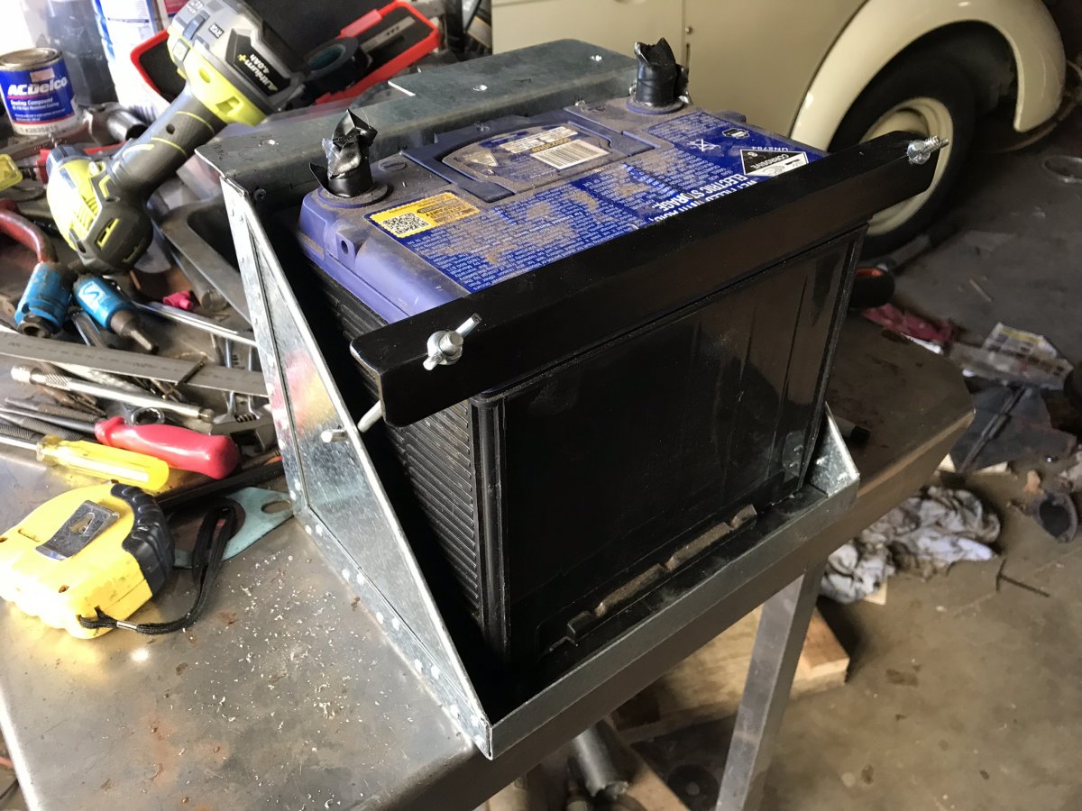

    EB19F4C1-D1CD-4EB6-B7C6-4CADDB8A7AB5.jpeg C8980175-E70E-4601-926F-64217FBE21B5.jpeg 996F7512-CA8A-4A75-B901-21D2E061596C.jpeg ,changed my battery to the opposite side in our A coupe ,,made a cradle out of sheet gal ,

    Haha Yeah Ned I think your right ,,never thought of that ,but subconsciously definitely!,,,,although I haven’t opened the bonnet (hood) on the Lolite in 2 years,,

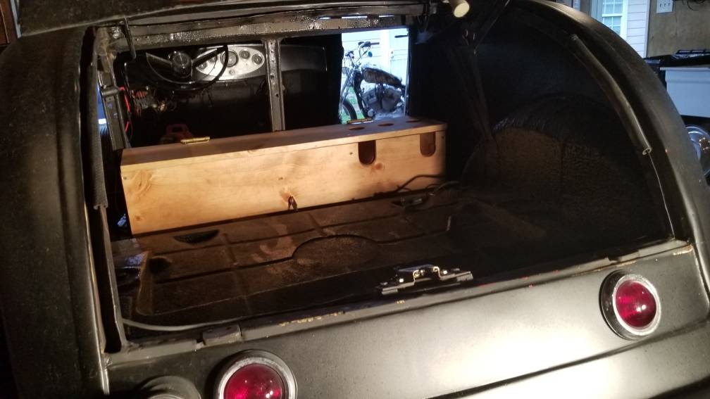

    I made a box and put it behind my seat, in the trunk area. One side is for the battery and one is for tools and stuff. There's plenty of gaps in the car; I'm not worried about fumes. 20180828_141423.jpeg 20180828_164834.jpeg

    what about routing the vent pipes out through the floor?
    dana barlow likes this.
  25. Where that becomes a problem at least with a standard battery is venting. Hydrogen even in an open car can be a problem.
    In a sedan with no truck I have been known to mount the battery under the back seat (like a beetle), if the vehicle has a turtle deck or a truck box that is a natural place for a battery.
    When I have a battery in the cab I like to put it in an enclosed box vented to the outside of the vehicle. Paranoid? you bet your *** but you know what they say, "Just because you're paranoid doesn't mean that they are not out to get ya." :D

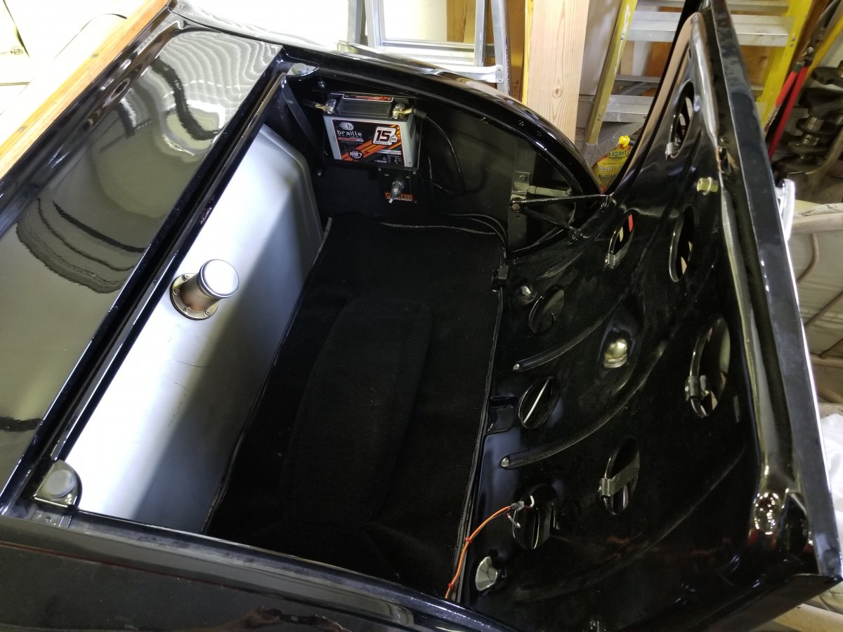

    I have a small Braille battery which I stuck up on top of the rear fender well in my roadster. With the gas tank in there and the floor hump to clear the spring there isn't much room for anything and I didn't want to loose more space to the battery. It's a small battery but good cranking power. Hung a kill switch on the side of the mount as well. I may move that to someplace outside the car as it's a pain in the *** to remember it is off after you have gotten into the car! 20191126_141010.jpg

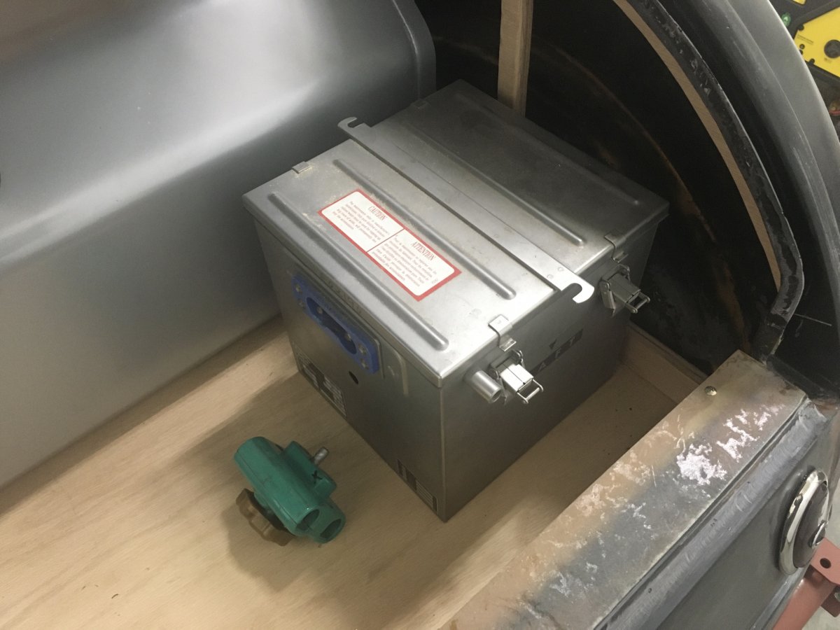

    D0C5DE9A-A38A-4151-9E62-D777BDC586D1.jpeg Retired from 50 years in General Aviation two years ago. Found a discarded NiCad battery box and cable one day, took them home for future use. So here it will go in my coupe, complete with quick disconnect! Battery will mount inside and the box will be vented with fresh air in and bad air overboard in stainless lines!

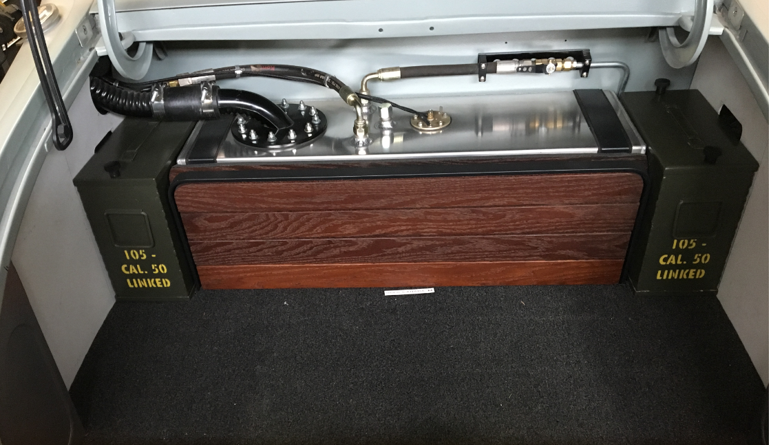

    Mounted in trunk at end of gas tank. Made two boxes in case battery didn't have enough juice to crank the 425. Boxes made to look like 50 cal ammo boxes, just a little larger. Never used the second one, used as spares and tools box. Battery is a type 51 used in a pile of Hondas.
