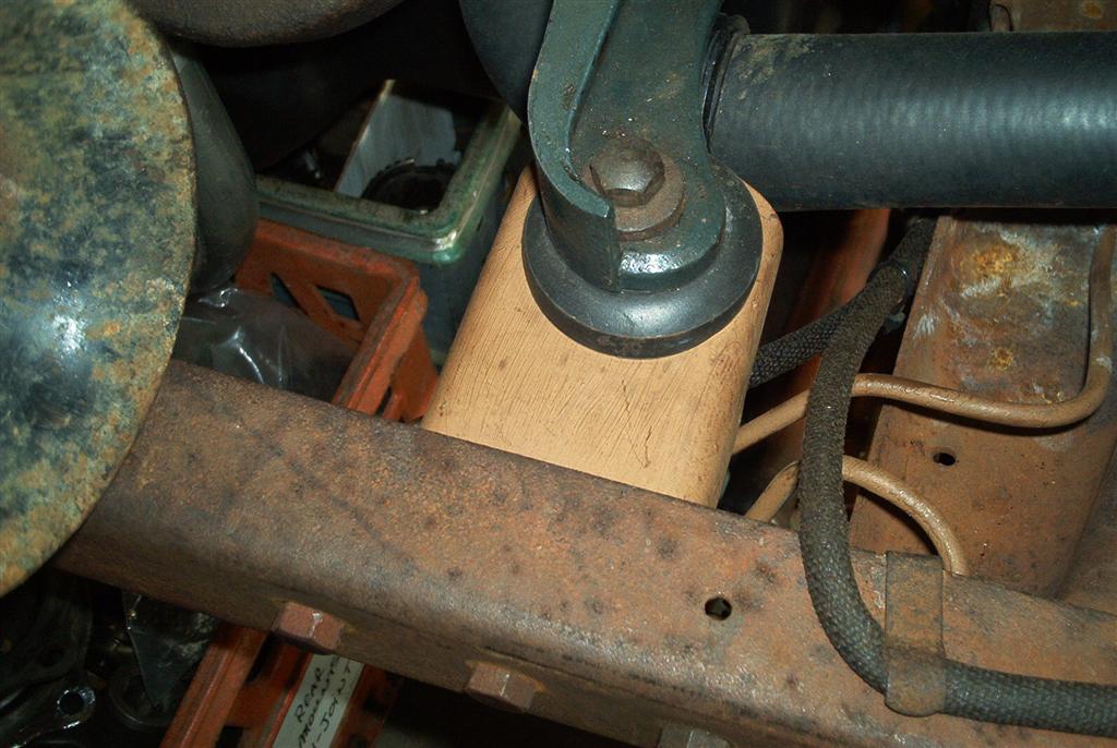

    Here is a picture of my front mount. I was able to use the stock shock holes to bolt it in.
    Gary in MN.

    Temporary wooden mount?
